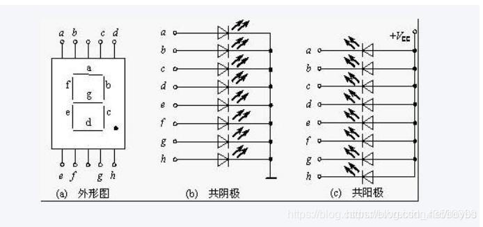

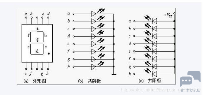

" G! J+ d  c1 p, P% P6 N% Y) Q数码管引脚图
" K3 u; a) ?8 u$ d4 \; x8 t6 N; o5 F% J. F1 t, c
20210628102817443.png $ u# F7 l7 E6 R) p0 c6 @* L( C: \
*j引脚接线 | PA0 - A | PA1 - B | PA2 - C | PA3 - D | PA4 - E | PA5 - F |PA6 - G |PA7 - DP |9 u: `( {  o$ `
