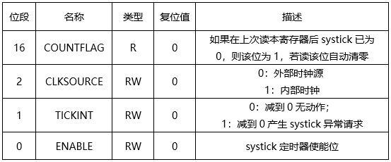

1 w" \5 `" P( W4 Z7 T                                       ▼CTRL:控制和状态寄存器4 \- {2 D  g( K# k/ [$ i
$ y8 ~% i+ X$ i& i aHR0cHM6Ly9tbWJpei5xcGljLmNuL21tYml6X3BuZy8wUmc4RGRwQWliZlVaTzVIMFU4dlliOWliMFBp.png 6 k' @  ~8 X( l  T& l6 O

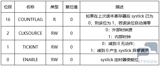

                                       ▼LOAD:自动重装载除值寄存器7 n& D/ H# q6 A  b- I
/ d$ X( q' c, o" N) N3 g* O% S6 S
* D3 B4 [+ y" r; g1 U- E! ?1 j* A& A! k( Z

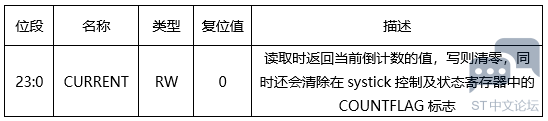

                                        ▼VAL:当前值寄存器
. D/ L* h6 O& j" w/ r) R/ d
+ |% E5 [! k# a aHR0cHM6Ly9tbWJpei5xcGljLmNuL21tYml6X3BuZy8wUmc4RGRwQWliZlVaTzVIMFU4dlliOWliMFBp.png
