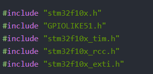

2 w5 [7 K" u5 `( ]2 B  K实现代码:) R  `# r& B1 J: i
  1. 7 Z4 d6 x9 T5 V1 M, u: M! c- ]6 j
  2. #include "stm32f10x.h"
    4 P: X% b% y6 x' y! x. P' q+ b
  3. #include "GPIOLIKE51.h"4 b. i4 v# z% _
  4. #include "stm32f10x_tim.h"
    9 U4 f( q1 {+ t; v7 T% L- `
  5. #include "stm32f10x_rcc.h"
    ; \" |8 ^6 N6 F0 Y
  6. #include "stm32f10x_exti.h"
    " E6 V, K4 n, ~; R: }0 a% E$ A
  7. 1 e& |$ d  @0 P# b
  8. uint16_t i=0;9 J& \5 k, p. e
  9. uint8_t j;, [$ H1 S- w" B, x* f2 K
  10. : R* [) r0 L4 ^% R) r* s2 q" e
  11. //函数声明, {5 G. g2 b7 E
  12. void TIM3_Config();' D) T9 Z: D0 e' k# f6 E& A# z
  13. void PWM_Config();; ?$ U& S/ X2 b3 E
  14. void GPIO_Config();3 |& |$ [' T, [1 }1 v# i
  15. void delay(uint32_t n);
