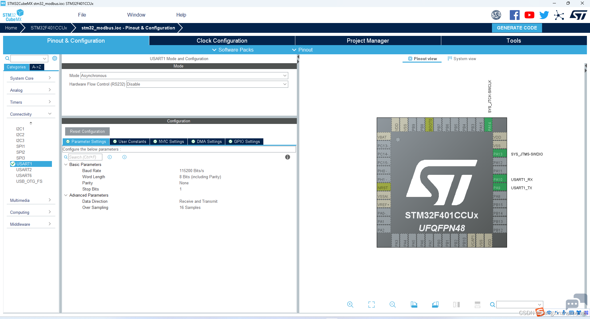

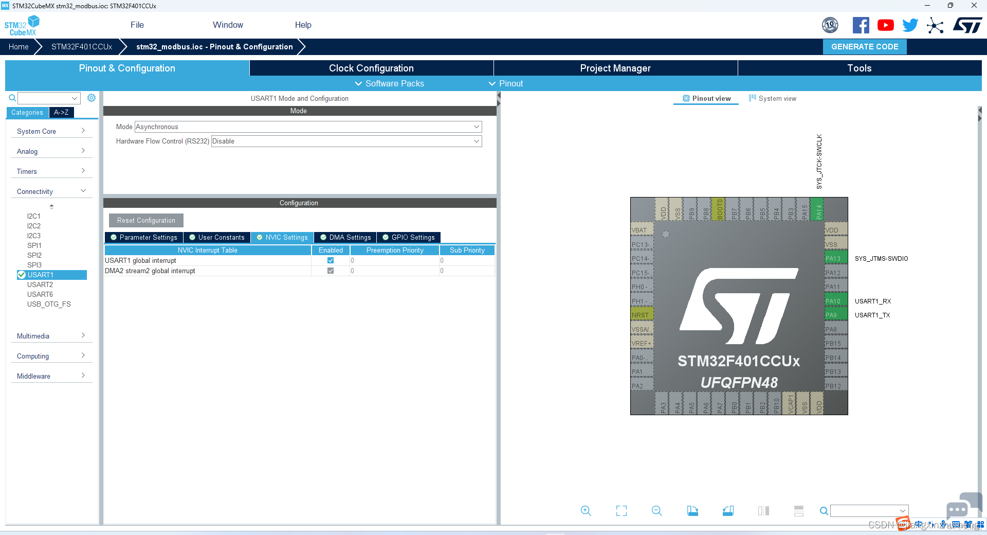

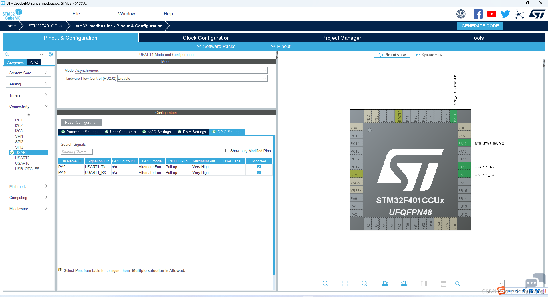

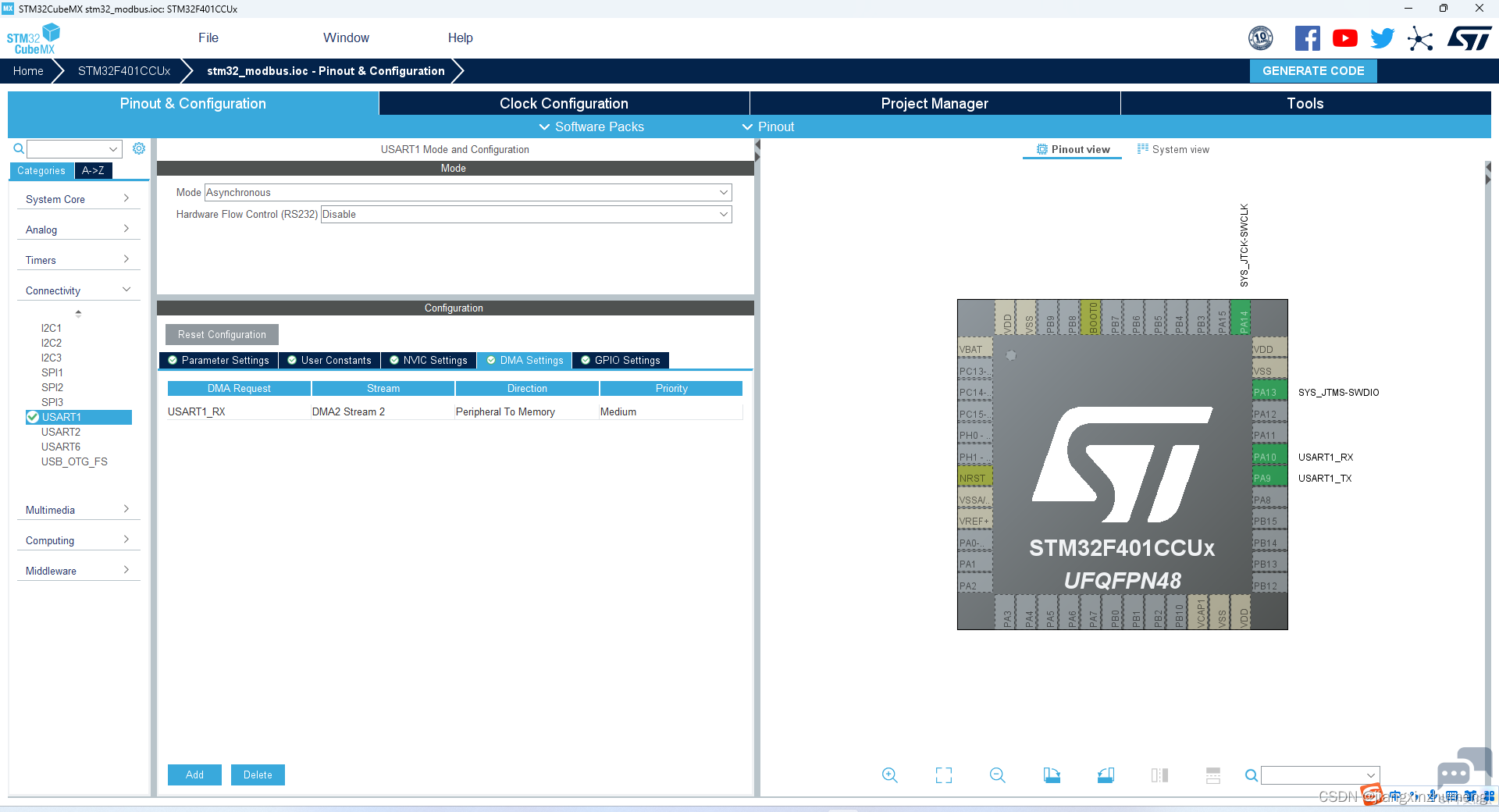

用cubemx配置下串口驱动如下; N" M& ]: c* t

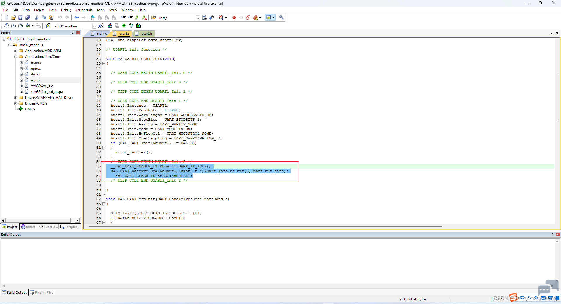

使能串口空闲中断4 U/ E4 `  O# ]+ m4 r( D
1 q7 `0 U( _0 W% ?
* Z5 z$ H: a5 w3 `
& O) l: n$ M; E" l
  1. __HAL_UART_ENABLE_IT(&huart1,UART_IT_IDLE);
    9 s( U- |5 o5 F0 }: I. o. q( P) @: X+ b
  2. HAL_UART_Receive_DMA(&huart1,(uint8_t *)&uart_info.bf.buf[0],uart_buf_size);
    3 f- D$ B2 m* q. E) p; g) f/ \/ n3 L
  3. __HAL_UART_CLEAR_IDLEFLAG(&huart1);
