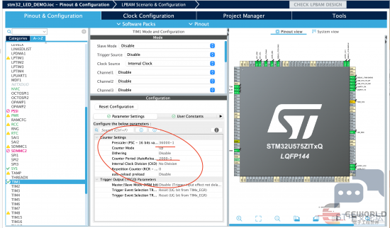

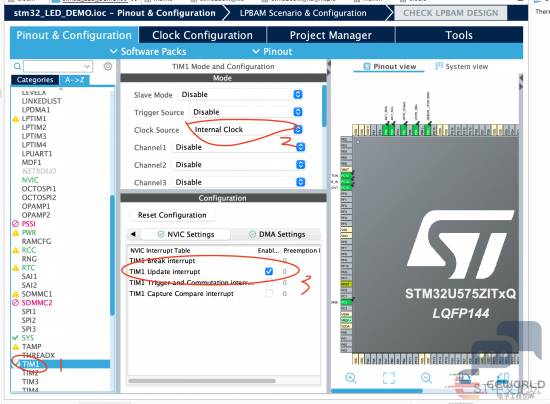

配置TIM1:
/ U4 V1 @  e9 E
! q+ n* B; `8 i$ r5 ?$ D; x( O 165626thht6bqhsqzbeeyk.png.thumb.png - E. Y3 q' P7 ]  t
  y5 J' v7 \" Q; W% Q
0 g# m" ]. J* ?7 I- S) M
$ @3 q' N5 B9 v! z* _# B  A6 M* ]
   按上面配置好后生成程序/ `. a1 L: o! i- ^
