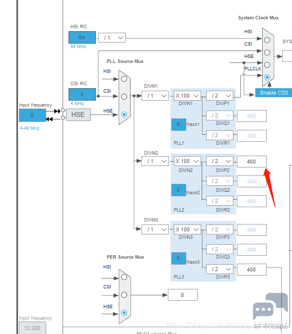

而实际上我们只需要在生成HAL_ADC_MspInit中添加一句核心的__HAL_RCC_ADC_CONFIG(RCC_ADCCLKSOURCE_CLKP);//ADC外设时钟选择就可以了。
$ I8 t- `* J, f. P( ~2 KADC的时钟源有三个选项:
' w2 c( [. q# |1 O; a, \+ @
  1. /** @defgroup RCCEx_ADC_Clock_Source  RCCEx ADC Clock Source8 S8 Z/ r' i2 G  @
  2.   * @{7 w, c' O1 K5 R8 @( |# x! r) o- v
  3.   */( h. c( u7 O: D1 A
  4. #define RCC_ADCCLKSOURCE_PLL2       ((uint32_t)0x00000000)
      U" H" B+ o- q" h# y4 I
  5. #define RCC_ADCCLKSOURCE_PLL3       RCC_D3CCIPR_ADCSEL_0; p* }1 @- `8 H
  6. #define RCC_ADCCLKSOURCE_CLKP       RCC_D3CCIPR_ADCSEL_1
    * @  Q: s4 m% X1 [  T/ P* ]
- |3 A0 u+ z, q2 x默认将采用RCC_ADCCLKSOURCE_PLL2,即400M的输入时钟,时钟太快,所以会导致ADC采集出来的数据不会有变化。! O0 [6 s( g% E2 Q+ t( X9 u
! T* }. \, |5 J
20200426081752112.png # [* K. d1 D4 K
