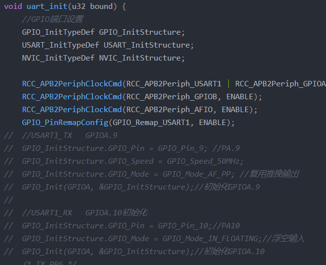

如何使用STM32串口映射到PB6、PB7
攻城狮Melo 发布时间:2023-3-14 14:05
  1. void uart_init(u32 bound) {+ t$ x( Q. k9 y8 g' V9 K9 E' {
  2.     //GPIO端口设置
    + F$ F( P* m" M
  3.     GPIO_InitTypeDef GPIO_InitStructure;. Q3 }, k  J2 q# n
  4.     USART_InitTypeDef USART_InitStructure;& t- |5 Y' u2 \8 `
  5.     NVIC_InitTypeDef NVIC_InitStructure;& T" P9 d9 w5 l/ _# C" N
  6. 0 a1 O5 _' V. A% p
  7.     RCC_APB2PeriphClockCmd(RCC_APB2Periph_USART1 | RCC_APB2Periph_GPIOA, ENABLE);        //使能USART1,GPIOA时钟% T. k' C; X! ?5 ^- H; `
  8.     RCC_APB2PeriphClockCmd(RCC_APB2Periph_GPIOB, ENABLE);
    : y' I0 X1 x* w/ @' J( u$ \
  9.     RCC_APB2PeriphClockCmd(RCC_APB2Periph_AFIO, ENABLE);% ~6 \. Y. u/ y+ |7 u+ u2 {) O2 q
  10.     GPIO_PinRemapConfig(GPIO_Remap_USART1, ENABLE);
    ) Z/ }7 k5 q; \
  11. //        //USART1_TX   GPIOA.9; n' k0 Z" e: R! t
  12. //  GPIO_InitStructure.GPIO_Pin = GPIO_Pin_9; //PA.9
    : q, [+ b6 s: \' I; N
  13. //  GPIO_InitStructure.GPIO_Speed = GPIO_Speed_50MHz;
    * F9 c0 I6 v$ i  k3 p& m" n5 Z/ I2 p
  14. //  GPIO_InitStructure.GPIO_Mode = GPIO_Mode_AF_PP;        //复用推挽输出. }" E5 G- F: T6 t* L# G
  15. //  GPIO_Init(GPIOA, &GPIO_InitStructure);//初始化GPIOA.9
    4 j5 ^+ c6 d8 w; A: T7 o# x
  16. //
    8 o: T/ p$ X0 x- |. o# @# s
  17. //  //USART1_RX          GPIOA.10初始化
    - _; s! J! i2 \1 w
  18. //  GPIO_InitStructure.GPIO_Pin = GPIO_Pin_10;//PA104 @1 E& b- ~2 P; m& s4 o
  19. //  GPIO_InitStructure.GPIO_Mode = GPIO_Mode_IN_FLOATING;//浮空输入" T- W( Y! k' W6 X
  20. //  GPIO_Init(GPIOA, &GPIO_InitStructure);//初始化GPIOA.101 c4 ^9 K, g: C% z
  21.     /* TX PB6 */) ^. ^) y8 G% ], W7 Z
  22.     GPIO_InitStructure.GPIO_Mode = GPIO_Mode_AF_PP;
    / z3 n9 }5 K, h- X: |! ?% ~
  23.     GPIO_InitStructure.GPIO_Pin = GPIO_Pin_6;3 K; g/ J1 N, \- M8 ^8 D
  24.     GPIO_InitStructure.GPIO_Speed = GPIO_Speed_50MHz;
    4 f. k+ c5 N( O$ v2 d' B
  25.     GPIO_Init(GPIOB, &GPIO_InitStructure);
    7 E; ~" j) H# \; r+ A
  26. " ~  T9 X8 ~: K2 L
  27.     /*  RX PB7 */" ~) P& C5 N; H* p: a( H! O' u# ^
  28.     GPIO_InitStructure.GPIO_Mode = GPIO_Mode_IN_FLOATING;0 ~2 p* D. K& J& u% H
  29.     GPIO_InitStructure.GPIO_Pin = GPIO_Pin_7;+ b7 g" F9 \* j- }- d1 [$ c& A
  30.     GPIO_Init(GPIOB, &GPIO_InitStructure);
    ) }, J8 s3 Z5 c
  31. 9 o6 w) n( N! I# g
  32. 6 s; D/ E. X# b( I
  33.     //Usart1 NVIC 配置0 E4 k3 V; J% x' h8 L9 W
  34.     NVIC_InitStructure.NVIC_IRQChannel = USART1_IRQn;
    8 i$ g. {* N! B- i% X
  35.     NVIC_InitStructure.NVIC_IRQChannelPreemptionPriority = 3 ; //抢占优先级3% a. w2 Z/ N% h5 O2 n
  36.     NVIC_InitStructure.NVIC_IRQChannelSubPriority = 3;                //子优先级3
    . z9 @1 P8 c, K# k
  37.     NVIC_InitStructure.NVIC_IRQChannelCmd = ENABLE;                        //IRQ通道使能
    8 f! v/ ~) ]0 D' u
  38.     NVIC_Init(&NVIC_InitStructure);        //根据指定的参数初始化VIC寄存器
    6 _8 q# H3 c7 D. K
  39. # a; ~4 ~, G' J
  40.     //USART 初始化设置; Y9 A/ P( X# r4 b; X1 F7 i+ F% B+ z, |
  41. - x" l, `% e. ]0 Z# w: a( v8 e6 O
  42.     USART_InitStructure.USART_BaudRate = bound;//串口波特率
    " I! p& Q3 T" h( B% v  X
  43.     USART_InitStructure.USART_WordLength = USART_WordLength_8b;//字长为8位数据格式, m3 U* Q) w7 |) R/ X$ X; v
  44.     USART_InitStructure.USART_StopBits = USART_StopBits_1;//一个停止位. U8 ?8 b, s0 S* B
  45.     USART_InitStructure.USART_Parity = USART_Parity_No;//无奇偶校验位+ f% S2 w# _( T+ g7 b
  46.     USART_InitStructure.USART_HardwareFlowControl = USART_HardwareFlowControl_None;//无硬件数据流控制* d) p% j" u& Z; {2 ?' R
  47.     USART_InitStructure.USART_Mode = USART_Mode_Rx | USART_Mode_Tx;        //收发模式
    8 ?) {3 |) ~5 e5 U0 \: C! @
  48. 6 v) ]' l% K# P3 D
  49.     USART_Init(USART1, &USART_InitStructure); //初始化串口1
      s. Q( T2 N" E2 t& F+ K, ^+ a8 n7 Q
  50.     USART_ITConfig(USART1, USART_IT_RXNE, ENABLE);//开启串口接受中断
    " d7 @' l; H6 [
  51.     USART_Cmd(USART1, ENABLE);                    //使能串口12 A" |* Y1 t9 A. j' U
  52. 9 Z5 G/ P$ q: ^! |& E" _+ r
  53. }; f7 k- u% N$ X' ~" c
  54. . B; A; {; f' w& n$ T1 Q
  55. + {8 J, Q/ z3 c- p3 R! \: a
