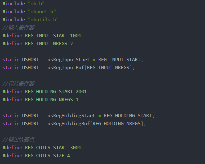

存储区配置,单片机上定义的起始地址要比实际通信过程中读写的地址+1。
4 R4 }& Y0 ~6 c: y  Z
  1. #include "mb.h"
    ; _. H( \4 F* `$ C
  2. #include "mbport.h"2 ]8 L/ B- m( m; g) v2 a( F
  3. #include "mbutils.h"
    2 C* E0 k: L/ c& e( q
  4. //输入寄存器4 v( I2 p' ~, l/ f% x  |0 ~! v
  5. #define REG_INPUT_START 10013 G5 M- F& _0 U, ~! ?; X: U
  6. #define REG_INPUT_NREGS 2
    ! X$ S1 _; F4 X* S& p
  7. ! ?9 n9 k1 Q; o2 x) t5 X7 M5 u
  8. static USHORT   usRegInputStart = REG_INPUT_START;3 x% }/ H& y9 V7 E* R( A
  9. static USHORT   usRegInputBuf[REG_INPUT_NREGS];
    ( D) p# ?) ?2 m6 K2 W3 J" i1 w
  10. 5 D6 k6 [* k/ Z, r6 c
  11. //保持寄存器0 f  l. P. h* U( @1 [7 [9 ]
  12. #define REG_HOLDING_START 2001
    8 Z2 d# x: \3 t% x0 V7 i( j5 y
  13. #define REG_HOLDING_NREGS 19 D% c) Y0 Z1 g5 p
  14. : p; K) k, a2 I% F8 G
  15. static USHORT   usRegHoldingStart = REG_HOLDING_START;
    + O5 b6 i* v* P. ?$ O
  16. static USHORT   usRegHoldingBuf[REG_HOLDING_NREGS];* T) R$ S4 S$ r; o7 S
  17. - t0 T9 X7 w  }
  18. //输出线圈点7 p6 n4 U/ b* d4 _& E" \4 Q
  19. #define REG_COILS_START 3001
    ; S% ~  P2 O- i6 [
  20. #define REG_COILS_SIZE 4' U& n( X; ^+ }6 a& H) ~7 Z- [. z
  21. 4 Q( y" }. m: I, A  f+ S
  22. static USHORT   usRegCoilsStart = REG_COILS_START;
    6 ~8 {! A/ D1 K- s
  23. static UCHAR           ucRegCoilsBuf[REG_COILS_SIZE/8+(REG_COILS_SIZE%8?1:0)];
    , B$ b' p& d& [" z' v9 H" [& w
  24. 6 a, U9 b! |7 M) q. l% |  m
  25. //离散输入点! B9 l6 ^9 f$ P) Z0 [
  26. #define REG_DISCRETE_START 4001+ y  E, _7 o) `, ]8 ]% W( Y1 }
  27. #define REG_DISCRETE_SIZE 8: u- x1 J; v( p" c
  28. 9 S9 ], R$ Y/ B9 X. x
  29. static USHORT   usRegDiscreteStart = REG_DISCRETE_START;
    : \" ], B$ J2 E7 T: K  }
  30. static UCHAR           ucRegDiscreteBuf[REG_DISCRETE_SIZE/8+(REG_DISCRETE_SIZE%8?1:0)];# W1 X! m7 `+ b9 ?+ W# ]$ U
