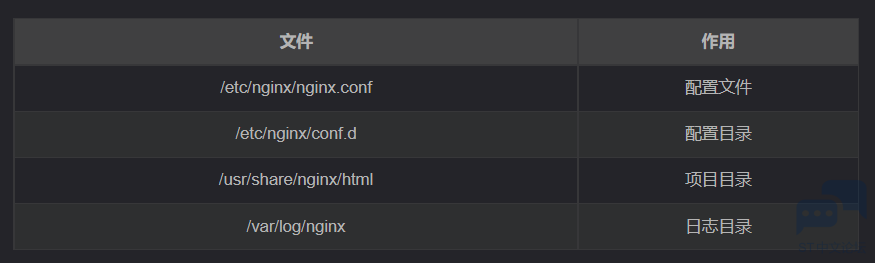

1 m, b/ g! H+ r- /* 第三层 */
% {- `9 a7 i; A0 n+ ~ - /# ls /usr/share/nginx/html
5 Q; G* }- I7 [3 A1 {( ^ - 50x.html index.html
- S- J* a# @- {: _. ~- u0 W; {
* A$ O6 U( _0 ^0 p. V6 g- /# exec
2 f6 S `. Y0 ^8 {9 P8 b# d
: E$ W {4 ~ c1 P s$ N
( b' m" e' A' t- a" c+ H( y
2 x6 o) a+ }0 Y0 T6 h/ {- B2 {5 b
, l; n5 [1 k5 Q& b% u3 [
- ~$ mkdir nginx& n4 I; |6 h* }9 x/ k& B0 W1 w
- ~$ docker cp nginx-temp:/etc/nginx/nginx.conf /home/docker/nginx/nginx.conf \% W) H. E0 V- }2 Q6 l
- docker cp nginx-temp:/etc/nginx/conf.d /home/docker/nginx/conf.d \8 q: O' l! l7 A
- docker cp nginx-temp:/usr/share/nginx/html /home/docker/nginx/html \3 e4 v% Y" m, }. D: R6 B$ B
- docker cp nginx-temp:/var/log/nginx /home/docker/nginx/log \0 M- P4 w- W" H {! E
- docker stop nginx-temp \# i9 ^3 w7 D3 Z3 X2 A
- docker rm nginx-temp + c4 q q4 V M" k* R- T9 @$ }
