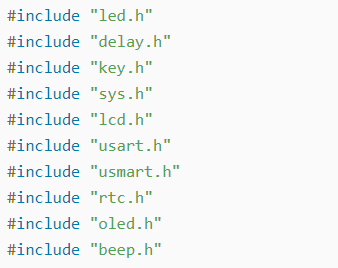

  4. #include "led.h"
    ) N+ P# J6 _' M7 ^1 F7 q! q
  5. #include "delay.h"
    7 Y; F2 A1 i( J3 U4 \5 d4 r
  6. #include "key.h"+ ~5 ?7 D; f+ i, \: S1 D% I5 V
  7. #include "sys.h") Y0 |# u9 T, o" L. k2 i1 C
  8. #include "lcd.h"8 j5 [' B& _0 U& D3 \
  9. #include "usart.h"
    - H; p$ p, M; u  ]# A! i5 I; c4 S
  10. #include "usmart.h"         ) Z* d4 W& T  v( E' c
  11. #include "rtc.h" 3 D6 b$ }5 ?' L2 d' W
  12. #include "oled.h"
    , ?- i, B$ b7 E* @0 G
  13. #include "beep.h"
