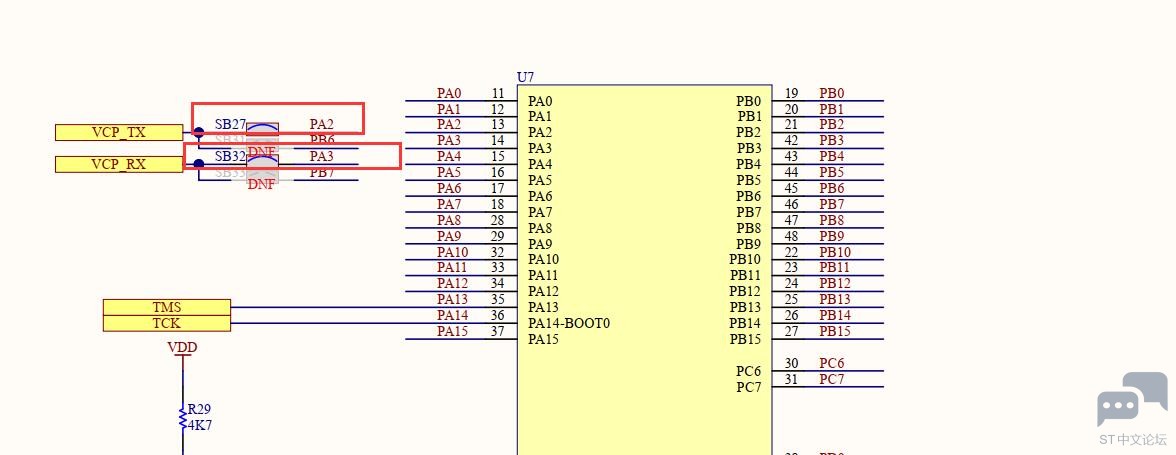

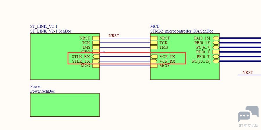

一、串口硬件部分
1.1、MCU串口端口
1.2、串口连接到仿真器
二、代码

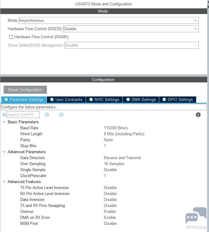

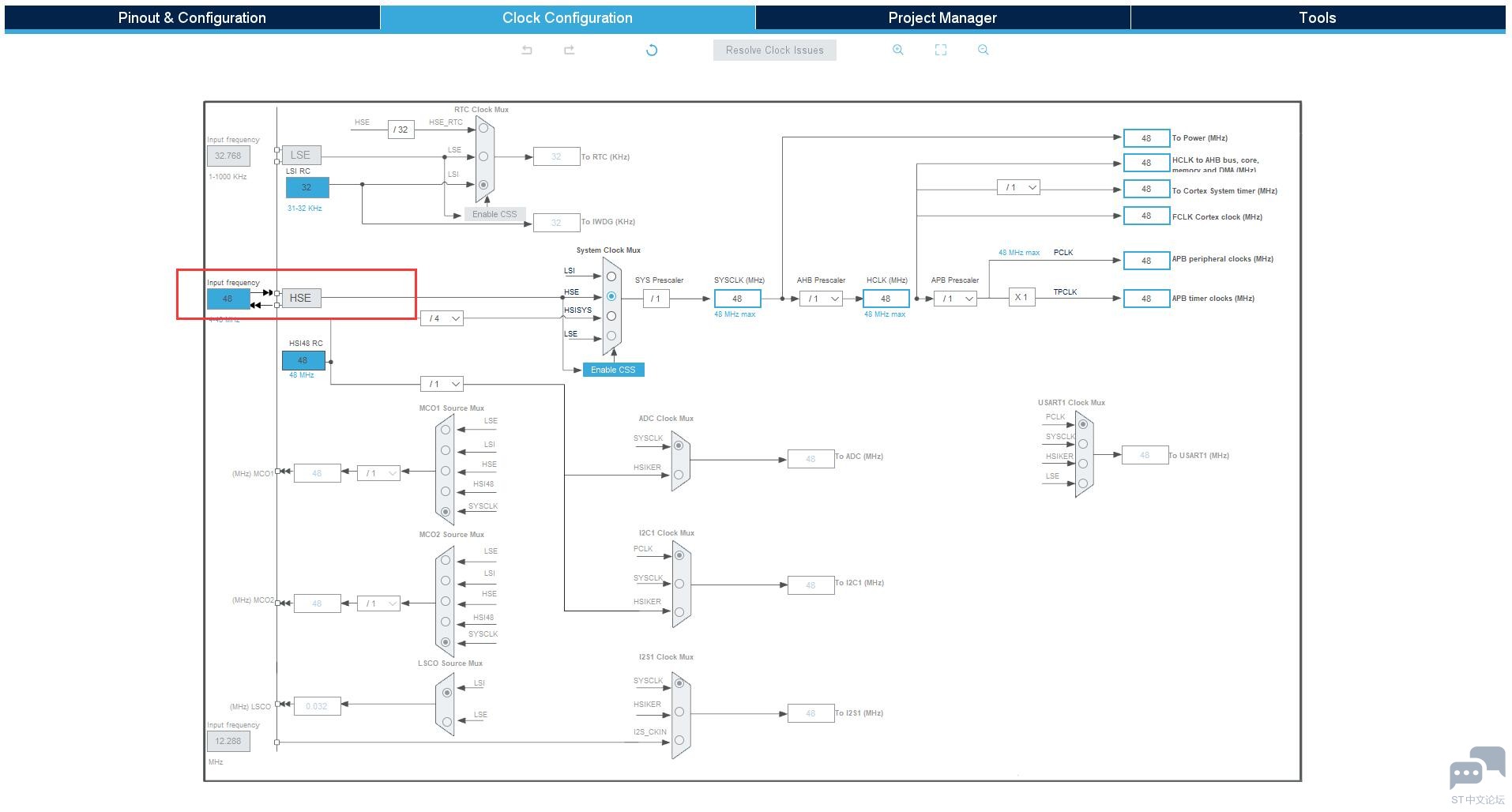

使用cubemx软件配置时钟和串口代码
2.1、配置时钟
stm32c031芯片的外接时钟晶振是48MHz,配置时钟选择外部
生成的代码

2.2、配置串口
在生成的代码上进行修改
void init_usart(uint32_t baudrate)
     GPIO_InitTypeDef GPIO_InitStruct = {0};
    __HAL_RCC_USART2_CLK_ENABLE();
    __HAL_RCC_GPIOA_CLK_ENABLE();
    /**USART2 GPIO Configuration
    PA2     ------> USART2_TX
    PA3     ------> USART2_RX
    GPIO_InitStruct.Pin = GPIO_PIN_2|GPIO_PIN_3;
    GPIO_InitStruct.Mode = GPIO_MODE_AF_PP;
    GPIO_InitStruct.Pull = GPIO_PULLUP;
    GPIO_InitStruct.Speed = GPIO_SPEED_FREQ_HIGH;
    GPIO_InitStruct.Alternate = GPIO_AF1_USART2;
    HAL_GPIO_Init(GPIOA, &GPIO_InitStruct);
    g_usart2.Instance = USART2;
  g_usart2.Init.BaudRate = baudrate;
  g_usart2.Init.WordLength = UART_WORDLENGTH_8B;
  g_usart2.Init.StopBits = UART_STOPBITS_1;
  g_usart2.Init.Parity = UART_PARITY_NONE;
  g_usart2.Init.Mode = UART_MODE_TX_RX;
  g_usart2.Init.HwFlowCtl = UART_HWCONTROL_NONE;
  g_usart2.Init.OverSampling = UART_OVERSAMPLING_16;
  g_usart2.Init.OneBitSampling = UART_ONE_BIT_SAMPLE_DISABLE;
  g_usart2.Init.ClockPrescaler = UART_PRESCALER_DIV1;
  g_usart2.AdvancedInit.AdvFeatureInit = UART_ADVFEATURE_NO_INIT;
    HAL_UART_Init(&g_usart2);

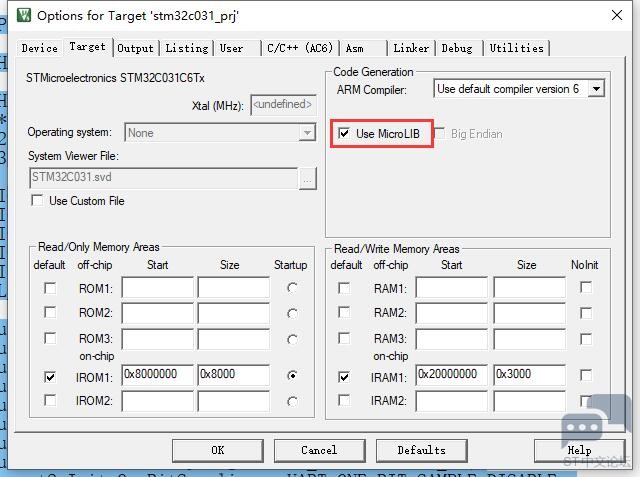

2.3、添加MicoLIB
添加代码
#if defined (__ICCARM__) || defined (__ARMCC_VERSION)
#define PUTCHAR_PROTOTYPE int fputc(int ch, FILE *f)
#elif defined(__GNUC__)
   /* With GCC, small printf (option LD Linker->Libraries->Small printf
   set to 'Yes') calls __io_putchar() */
#define PUTCHAR_PROTOTYPE int __io_putchar(int ch)
#endif /* __ICCARM__ || __ARMCC_VERSION */
PUTCHAR_PROTOTYPE
  /* Place your implementation of fputc here */
  /* e.g. write a character to the USART2 and Loop until the end of transmission */
  HAL_UART_Transmit(&g_usart2, (uint8_t *)&ch, 1, 0xFFFF);
  return ch;

三、运行

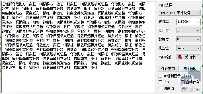

编译后,下载程序到开发板

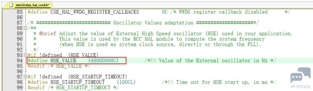

串口输出乱码
修改时钟频率,时钟为配置的48M。修改内容如下:

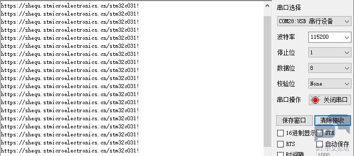

重新编译,下载后,串口输出
串口输出正常。
