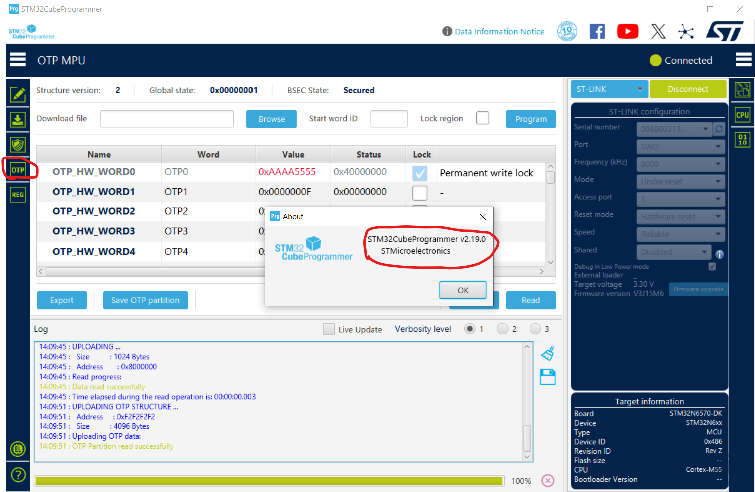

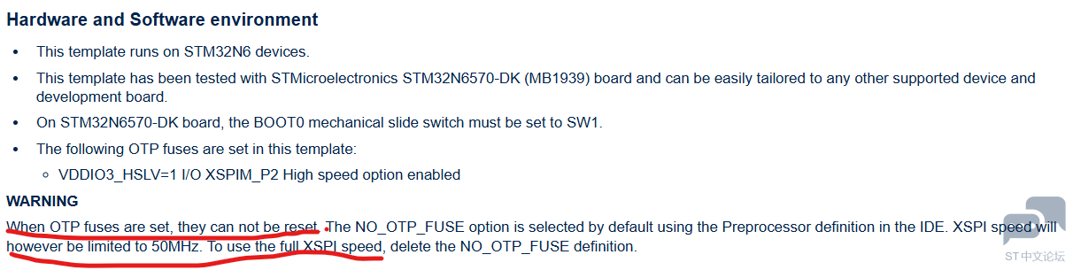

【STM32N6570-DK评测】摄像头video encoder 本文对摄像头video encoder及LCD显示 一、导入VENC_SDCard工程(STM32N6570-DK\Applications\VENC\VENC_SDCard\STM32CubeIDE) 二、直接debug工程(BOO1 1-3)。 显示效果如下: debug message会报错。如下: 2/11/2025 16:30:52.095 [RX] - CPU frequency : 600<LF>sysclk freq 2/11/2025 16:30:52.100 [RX] - uency : 400<LF>pclk5 frequency : 200<LF> 2/11/2025 16:30:52.242 [RX] - SD card info : <LF> block Nbr : 31116288<LF> block size : 512<LF> card speed : -1515870811<LF> 2/11/2025 16:30:52.720 [RX] - evision ST-AE v1.0.2<CR><LF> evision AWB v1.0.2<CR><LF> erasing flash output blocks<LF> Done erasing output flash blocks<LF> 2/11/2025 16:30:52.783 [RX] - error initializing encoder -4<LF> error encoding frame 0 : -2<LF> 2/11/2025 16:30:52.802 [RX] - error encoding frame 1 : -2<LF> 2/11/2025 16:30:52.836 [RX] - error encoding frame 2 : -2<LF> 2/11/2025 16:30:52.869 [RX] - error encoding frame 3 : -2<LF> 问题:需要配置OTP。Readme工程有介绍。 配置OTP可使用函数或CubeProgrammer. |
