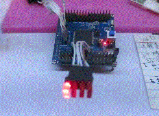

这项测试是一个所有到手的开发板的必做,本实例也不例外。 首先打开main.h文档,可以看到在STM32CubeMX中定义的命名引脚,本节仅列出LEDx的定义,见下列表:- y* `/ ] j) J Z& T #define LED3_Pin GPIO_PIN_15 #define LED3_GPIO_Port GPIOA #define LED0_Pin GPIO_PIN_100 v8 H6 l; ]4 E" d #define LED0_GPIO_Port GPIOC. R1 i5 F. x8 M- x# {6 O. s #define LED1_Pin GPIO_PIN_11& B6 t7 q6 D; R+ p* g #define LED1_GPIO_Port GPIOC #define LED2_Pin GPIO_PIN_12# o- T @, K5 @1 k, ?/ e3 `8 ` #define LED2_GPIO_Port GPIOC PC_10~12,和PA_15,4个LED的IO口。 打开gpio.c可以看到定义的LED0~LED3的语句,当然,此文档所有定义的引脚都有: //Configure GPIO pin : PtPin GPIO_InitStruct.Pin = LED3_Pin;9 |% N- H6 w) d; B. ?- } GPIO_InitStruct.Mode = GPIO_MODE_OUTPUT_PP; GPIO_InitStruct.Speed = GPIO_SPEED_FREQ_HIGH;: j/ I, j; h* J0 R) ]% i) T1 K( |; v HAL_GPIO_Init(LED3_GPIO_Port, &GPIO_InitStruct); //Configure GPIO pins : PCPin PCPin PCPin GPIO_InitStruct.Pin = LED0_Pin|LED1_Pin|LED2_Pin; GPIO_InitStruct.Mode = GPIO_MODE_OUTPUT_PP; GPIO_InitStruct.Speed = GPIO_SPEED_FREQ_HIGH;1 W9 v" ~3 }3 L' J HAL_GPIO_Init(GPIOC, &GPIO_InitStruct); 驱显LED的设置定义代码已好了,下边需要在主函数中定义驱显,本例计划轮显的方式。 在开头定义一个整形变量: int ledk=0; 定义一个轮显函数,用switch case函数,代码如下:) L8 U, U5 F8 H- a+ |7 L //TEST LEDs void ledTest(void){ switch(ledk){- d7 @1 t8 h8 [/ f, T4 h- @ case 0: HAL_GPIO_WritePin(GPIOA,LED3_Pin,GPIO_PIN_RESET); HAL_GPIO_WritePin(GPIOC,LED0_Pin,GPIO_PIN_SET);3 n5 a, U5 L4 w0 M+ X5 z HAL_GPIO_WritePin(GPIOC,LED1_Pin,GPIO_PIN_SET);2 @4 m% B2 G, {: C HAL_GPIO_WritePin(GPIOC,LED2_Pin,GPIO_PIN_SET); ledk++;break; case 1:& J: L% h" ?6 @ HAL_GPIO_WritePin(GPIOA,LED3_Pin,GPIO_PIN_SET);/ ~9 Z$ C4 c2 r HAL_GPIO_WritePin(GPIOC,LED0_Pin,GPIO_PIN_RESET);. B' p$ m1 r2 h0 J+ B# P HAL_GPIO_WritePin(GPIOC,LED1_Pin,GPIO_PIN_SET);1 E: J" ?5 R% L( } HAL_GPIO_WritePin(GPIOC,LED2_Pin,GPIO_PIN_SET);( ?3 c1 q- T" A( J ledk++;break; case 2:& {. Q# {) Z6 ?- Z/ F HAL_GPIO_WritePin(GPIOA,LED3_Pin,GPIO_PIN_SET);/ b/ E% u: x' V& z+ o HAL_GPIO_WritePin(GPIOC,LED0_Pin,GPIO_PIN_SET); HAL_GPIO_WritePin(GPIOC,LED1_Pin,GPIO_PIN_RESET); HAL_GPIO_WritePin(GPIOC,LED2_Pin,GPIO_PIN_SET);% G( C* k. N" [, D; S ledk++;break; case 3:% ?: t5 ]$ L+ Y. i6 Y8 F, S# a HAL_GPIO_WritePin(GPIOA,LED3_Pin,GPIO_PIN_SET);$ r. \( P+ s4 T5 O! X5 V5 R8 J HAL_GPIO_WritePin(GPIOC,LED0_Pin,GPIO_PIN_SET);' g+ X0 R; A' M# F! v! s+ M HAL_GPIO_WritePin(GPIOC,LED1_Pin,GPIO_PIN_SET);1 J5 N' Z$ n% r9 N0 N HAL_GPIO_WritePin(GPIOC,LED2_Pin,GPIO_PIN_RESET);( n5 |% N) q2 e4 z2 n ledk++;break; default: HAL_GPIO_WritePin(GPIOA,LED3_Pin,GPIO_PIN_SET);; R1 q5 F* K* Y$ U HAL_GPIO_WritePin(GPIOC,LED0_Pin,GPIO_PIN_SET); HAL_GPIO_WritePin(GPIOC,LED1_Pin,GPIO_PIN_SET); HAL_GPIO_WritePin(GPIOC,LED2_Pin,GPIO_PIN_SET); ledk=0;break; } } 在主函数体内加上:* O/ `$ W) X3 M+ U2 N q ledTest(); HAL_Delay(100);+ s) d O0 I3 I( \+ E. ]2 s0 y 编译下载就可以了,见GIF动画图片22_1。 |
