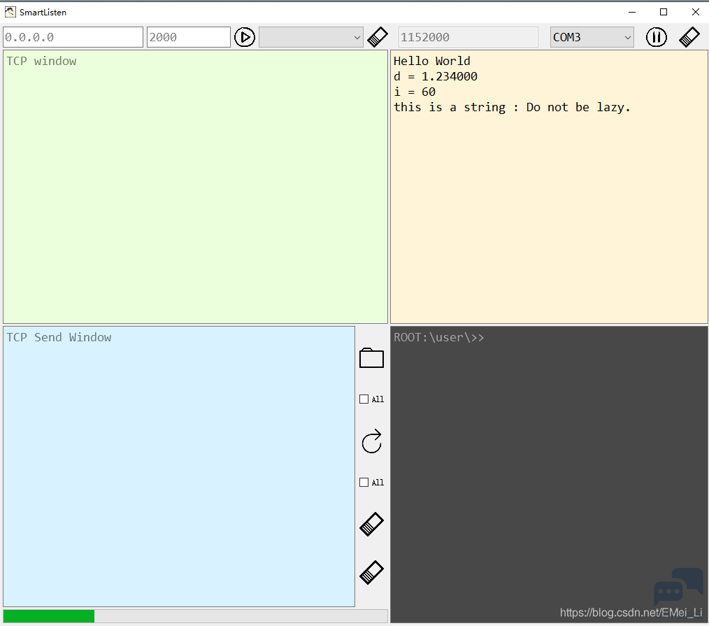

写个简单的程序试一试:2 T% T/ H0 S; w$ }. g  z4 d
& u( O$ v2 q5 {" [" ~
  1. int main(void)! L; D6 w' F7 Z6 F  ~5 ]
    ) \6 u1 Y# n  X+ C. S# R
  3.     MPU_Config();
    . V* G) a0 T7 i8 e8 Y+ @
  4.     SCB_EnableICache();
    ( m: E: A( V8 c* y5 X
  5.     SCB_EnableDCache();
    . q' M) |9 ?" a. v+ k1 u! z2 z
  6.     HAL_Init();) Y8 |8 C$ u! w# m- {6 S. [  r
  7.     SystemClock_Config();, b5 E7 v6 G0 q; {. P( F& u+ Q, @
  8.     MX_GPIO_Init();
    : O  W! f* [/ a7 L
  9.     MX_ETH_Init();+ u# q/ M0 m) O/ T
  10.     MX_USART3_UART_Init();
    ( e1 {3 a% F5 v4 o7 r( A+ f
  11.     /* USER CODE BEGIN 2 */# A. W) @2 ~1 [5 {. ?
  12.         double d = 1.234;
    6 Q$ F; \# h4 _( T) P8 j5 Y% a
  13.         int i = 60;
    5 W% K+ S$ _# M# ?
  14.         char str[] = "Do not be lazy.\n";5 J0 K$ {) ~+ x  p9 e" t
  15.         printf("Hello World\n");" g/ c' E' h% F3 h; x" N
  16.         printf("d = %lf\ni = %d\n", d, i);* ]) `( t7 @9 ?( F# J0 r5 l1 Q
  17.         printf("this is a string : %s", str);
    ; X8 R! m2 f; Q. {
  18. ' O: u; w/ }* j) |" q9 b+ a2 X! U
  19.     while (1){}! D5 x4 R! I+ v. O
  20. }
% ?) {  h# u" W/ @
输出结果:/ ]! m0 U* ]7 C" W1 F# e
+ B  ]2 c8 I; X7 f7 X% b
" M6 D& z1 C. I+ p# X7 d可以开始愉快的使用printf()了.
