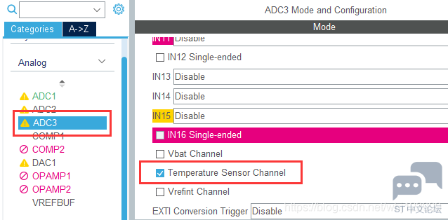

在 CUBEMX 中打开 ADC3-IN18 的测量引脚,这个是自带的测量温度通道:

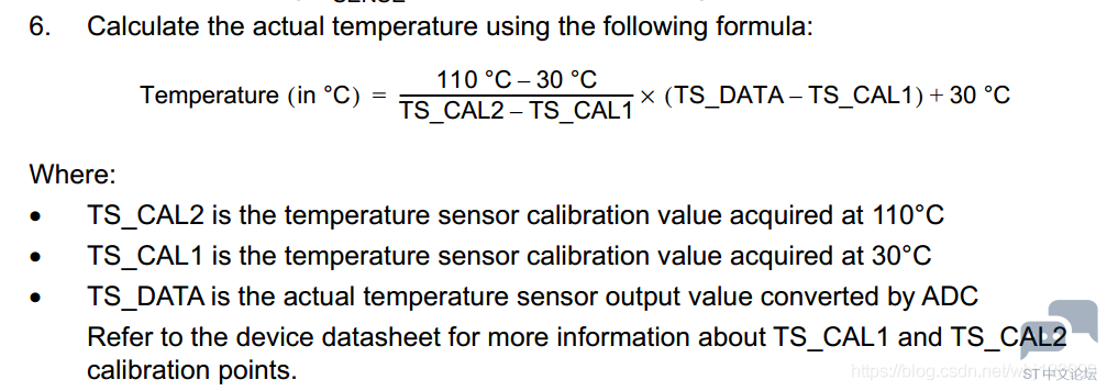

. e5 n9 q2 R3 o# a: G' Y1 K- S温度的计算公式
4 L: ~, Y3 l2 ^4 o7 X
5 d$ [- E5 e: Z& ^; x7 D
; S5 Z2 m9 c) m9 [$ ]
- |" t  G' `# c5 L6 s
TS_CAL2 的值保存在 :0x1FF1E840+ t+ Q" B; }# d% X3 Z- |
TS-CAL1 的值保存在:0x1FF1E820
6 T8 n; h- `( i4 x8 B1 O* J. T7 o  q$ t, ?0 ^
所以可得
, S, e* V. @/ n1 a) ^, Y! z
  1.     adc_v = HAL_ADC_GetValue(&ADC3_Handler);5 Q3 V! f8 G# D! f; ^. N" [
  2.     adcx = (110.0-30.0)/(*(unsigned short*)(0x1FF1E840) - *(unsigned short*)(0x1FF1E820));
    % o  b3 ]/ S2 {
  3.     temp = adcx*(adc_v - *(unsigned short*)(0x1FF1E820))+30;
