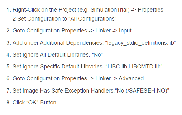

Make sure the selected Windows SDK is installed:
% v& j+ m3 v' H" N  S  kProperties -> Configuration Properties -> General -> Windows SDK Version.
/ |% X7 n3 C) x8 i2 {7 b
( K. I5 A6 F% ~3 R( o, f8 S/ v2 b; C1.Right-Click on the Project (e.g. SimulationTrial) -> Properties
) `/ X0 o! y9 s5 Q   2 Set Configuration to “All Configurations”! m6 ^  X0 J" G5 h: X
2.Goto Configuration Properties -> Linker -> Input.
* n" |4 r' U5 F. g6 D9 W3.Add under Additional Dependencies: “legacy_stdio_definitions.lib”
0 X0 V6 b; E5 X4.Set Ignore All Default Libraries: “No”
! t6 G8 `5 E9 T5.Set Ignore Specific Default Libraries: “LIBC.lib;LIBCMTD.lib”
& Y: ~% H, H$ r( \; u! p6.Goto Configuration Properties -> Linker -> Advanced# f" W7 O  `0 C
7.Set Image Has Safe Exception Handlers:“No (/SAFESEH:NO)”
- p  E  e8 O. N2 X8.Click “OK”-Button.
