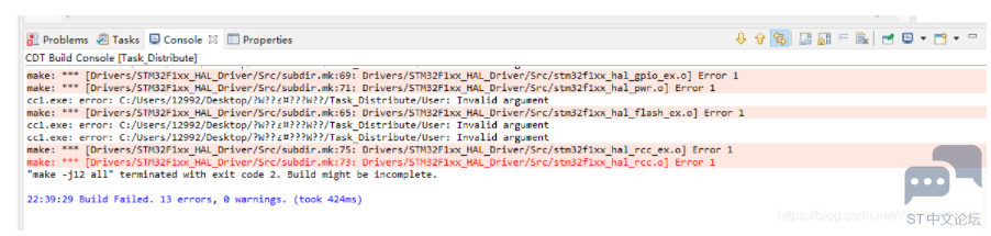

1. 点击编译时,会报出很多错误; B9 `; n* Q$ I. _( U
8 V+ U! K# m9 X* H7 x+ T" ]
类似于:make: *** [Drivers/STM32F1xx_HAL_Driver/Src/subdir.mk:73: Drivers/STM32F1xx_HAL_Driver/Src/stm32f1xx_hal_rcc.o] Error 1
' g1 G  O/ x5 l' H! ~8 f
, N0 V4 [) p' o, N' ]0 A: F% |+ g ~(IDE9)}O@2{MSUEC[LPM9A.png 9 }2 A; r2 n1 V, K- \* C" Z
' @6 ?# L6 |0 p0 W* {

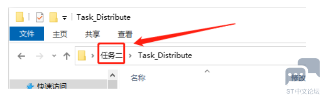

此种情况是因为文件路径中包含了中文路径导致的:* f, E; A; Z& ~# X7 u$ B! K
( ]( D) L3 ?5 ~0 i. R- F
7 c2 ^# B9 C; L& }

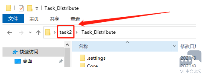

& N/ W& ~( F' h- a 解决办法:将中文路径改成英文路径即可。% B, f, a# b) d8 D
% ~/ ~1 |+ v! | G}48]L@W)DZ}TL`(P)L5G9E.png

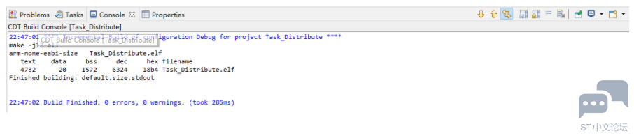

# n- g2 f! N0 n( ?无报错:
+ R; q2 s. f' E, I
0 ?. ^$ |( M+ i3 N: o+ ` G0)L2)27GL8C[CIYT9WA}R5.png ) F1 L3 v2 S5 ?; H
