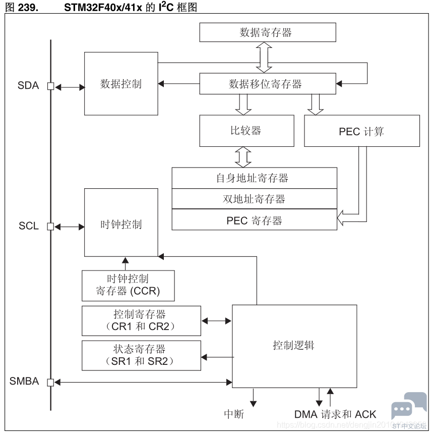

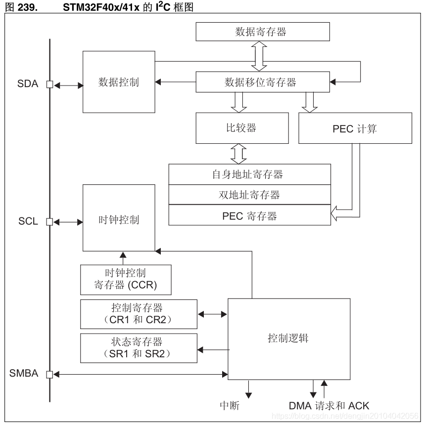

7 d- b& D. v( A0 e( jIIC框图7 n5 S8 L$ u6 T9 f8 W
. c6 v! f) C; v  V
1 S$ B5 Z0 \: q  [

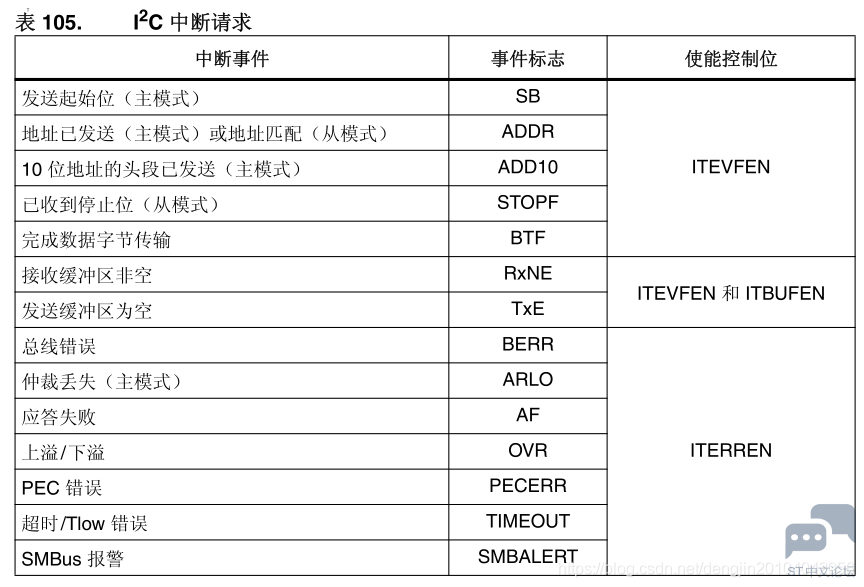

, L/ w- B& E1 |  S( n( `5 W* l04. I2C中断
. O# u' N) w' O1 b& W9 |9 O1 G0 a+ M( b
* y5 P# t# [5 a# ~6 R, \8 l) D3 X- F( F2 @

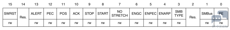

5.1 I2C 控制寄存器 1 (I2C_CR1)
6 U% Y" W6 K5 S6 i: Z1 r- B/ L1 iI2C Control register 1
; Y& Y4 B4 b+ a4 }9 r. q偏移地址:0x00
" l1 M9 Y% l: V4 b2 d0 `复位值:0x0000
0 k4 k; H4 z) c% Q* A( |+ L
  z2 a; K" V" @/ s  v- | 20201012175536663.png
# ]9 g& E  d7 P4 e& I

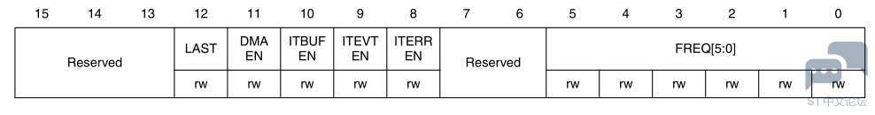

! i  G6 |: v% d& L5.2 I2C 控制寄存器 2 (I2C_CR2), [9 j4 X7 U8 K9 z" Q) m& z- C
I2C Control register 2
& G  t" ~7 S/ Y8 \: N6 I偏移地址:0x04
: U- m* _0 C# O7 j5 D+ b复位值:0x0000
1 C: B- m$ I) ~4 F: ~- `' D9 w+ D! p% o& Q% I
20201012175543433.png 3 E& N; @. c  v

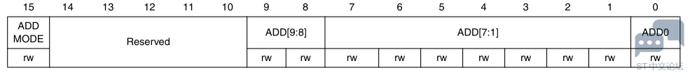

4 Q% l. u! G; @5.3 I2C 自有地址寄存器 1 (I2C_OAR1)
. o% M1 S, r% m  P9 R6 ~1 V4 w( sI2C Own address register 1
; R/ R( ?0 }& ^. b; T6 T偏移地址:0x08/ a. Z0 f' r( Q( q
复位值:0x0000
  {& ~2 ~, k. S& O* E% {' Q; k+ n! e2 @1 n  F9 Y% z
: B9 t' c: Q) Z  ~! s5 _

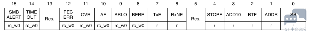

5.6 I2C 状态寄存器 1 (I2C_SR1)9 K2 G# [% c4 Q3 E
I2C Status register 1
, u( t' G& Y: A偏移地址:0x14
% h0 b. i# K3 p) o; E6 k; y& t" U8 g复位值:0x00002 P# V, ]0 L( O9 u" K
; t2 ^& E6 Y- w/ G( o$ B+ a
20201012175613925.png ( W: f3 L1 \8 F! h

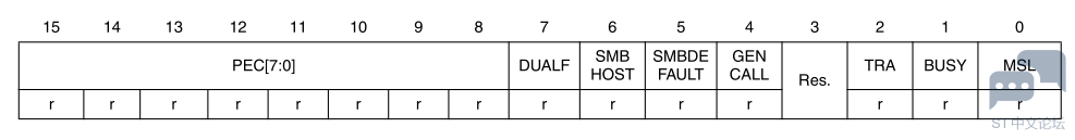

' A/ O0 W; b. g; s  n% L5.7 I2C 状态寄存器 2 (I2C_SR2)* S- Z% `5 w3 E- g/ ^$ k* u
I2C Status register 2, F* X! ]6 u: b2 q/ J  z9 l
偏移地址:0x18
5 P# r- u4 ~+ L5 j) r6 @. X复位值:0x0000' w: i5 z2 }$ x. _, U
. q7 a1 B" ?  b3 e9 ~( ^% e$ I

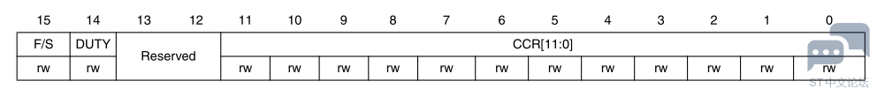

2020101217562154.png ; k3 e% X. B" c
. b0 e, L% \; @5.8 I2C 时钟控制寄存器 (I2C_CCR)6 W& h9 z% y; b
I2C Clock control register
1 k+ Q$ a9 o4 S4 L, U5 _+ i. d偏移地址:0x1C9 E! [" s% N! y9 y
复位值:0x0000
