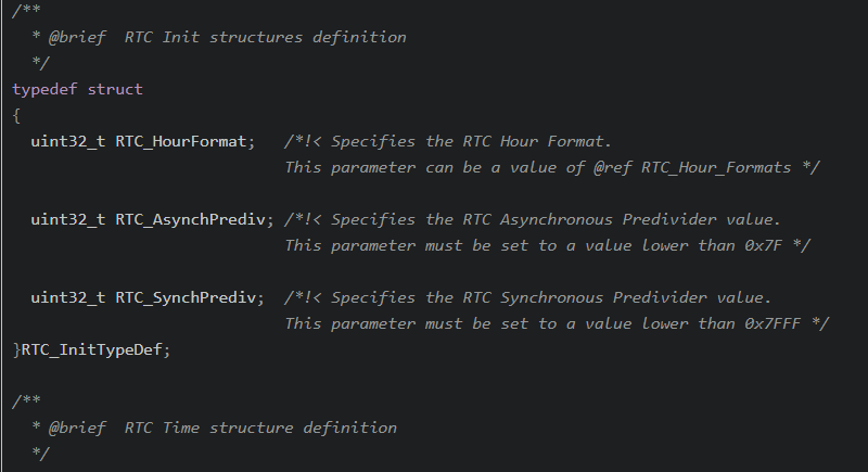

  1. /**
    ' ]* m  B6 D6 E7 N2 L: @' y
  2.   * @brief  RTC Init structures definition
    ) t4 K5 \3 d: d8 L2 H3 R+ F3 ~# @3 u
  3.   */
    ( h% X0 n+ ]* Y- G% K
  4. typedef struct  X& H' Q' |. U' Q0 K  b0 n0 M
  5. {) m9 D2 g  x2 `
  6.   uint32_t RTC_HourFormat;   /*!< Specifies the RTC Hour Format.: [# ?: R/ r4 }. |8 D7 I
  7.                              This parameter can be a value of @ref RTC_Hour_Formats */
    ; T; B( z2 f" a6 D+ n$ g
  8. 7 R$ L5 G% x7 l; r& Q0 z' ]+ n" I
  9.   uint32_t RTC_AsynchPrediv; /*!< Specifies the RTC Asynchronous Predivider value.8 b6 W2 W5 ]  y! F
  10.                              This parameter must be set to a value lower than 0x7F */
    : O( H- L: A0 n, B
  11. 7 A( O8 r) r0 J& }, e: M
  12.   uint32_t RTC_SynchPrediv;  /*!< Specifies the RTC Synchronous Predivider value.
    + {% ^8 O9 {8 J5 @$ {! t
  13.                              This parameter must be set to a value lower than 0x7FFF */
    $ I# {0 l- k+ U+ e" `. p
  14. }RTC_InitTypeDef;; n! x- d" J6 X
