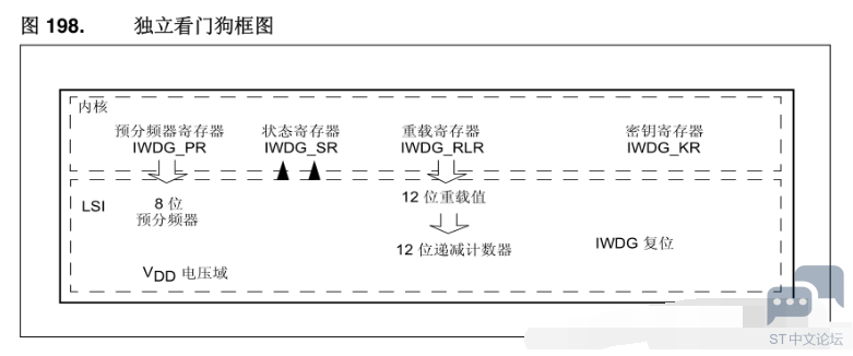

04. IWDG框图
* m) C' l0 W9 L* o& a* i2 ?8 W2 W7 Z
[attachimg]4**3[/attachimg]& z2 U, Z9 V6 b/ \$ L# l! ?! H, I

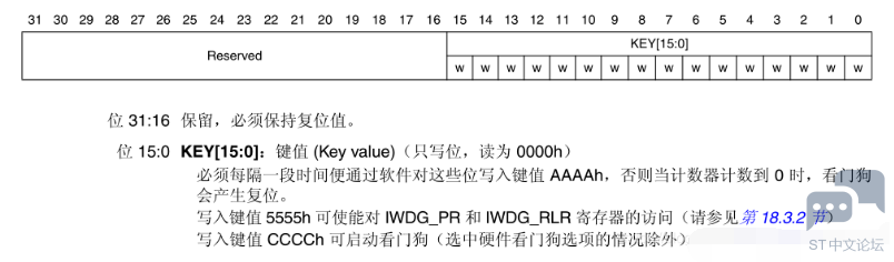

5.1 关键字寄存器 (IWDG_KR)
7 _9 y; ~9 W0 z+ MKey register
0 b( P+ a% O4 c+ p  v偏移地址:0x00* C' s. w. B1 i: K! P# p% g
复位值:0x0000 0000(通过待机模式复位)
2 [" x, o% C8 r; ]. z/ m2 _5 l
! P7 s' Z% s3 t6 l0 ][attachimg]4**4[/attachimg]  s2 H' p# `9 ]( L! Q

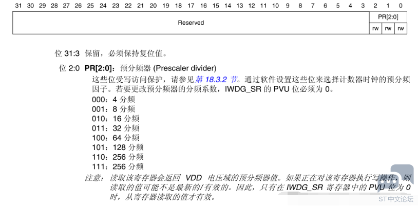

8 \# Q. Y) r/ ?5.2 预分频器寄存器 (IWDG_PR)
8 ?/ _% M# {/ B  p2 VPrescaler register
7 r5 M% F7 S/ J" q% r偏移地址:0x04. d. F6 w& j5 l9 Z/ P2 C3 l) G: K
复位值:0x0000 0000; Z# _+ N! y- S2 I8 U, v
* r8 I& i% C2 E8 D[attachimg]4**5[/attachimg]8 D: L# T; \( F  e( x

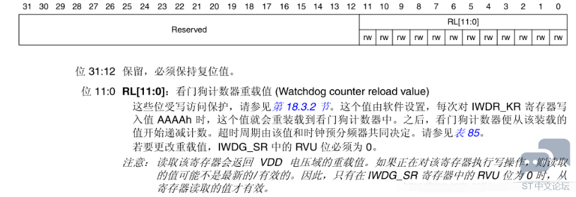

9 g* x+ _3 T* H5.3 重载寄存器 (IWDG_RLR)
% w$ V0 L* i$ l6 KReload register' E; u, _  K4 l. V3 u. |* d
偏移地址:0x08
  Q4 J- {* F& r/ W& @: H! V复位值:0x0000 0FFF(待机模式时复位)
6 ], T3 n& N+ S8 k  n% N) I9 Z. I' }) d* V3 n$ P
[attachimg]4**6[/attachimg]" y: X2 C& K  J$ k

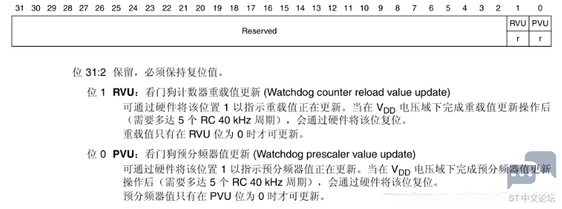

5.4 状态寄存器 (IWDG_SR)
, K2 @$ v5 F% v3 x  dStatus register
+ N9 j3 S( j7 C  R0 j偏移地址:0x0C
* w" M1 k+ J4 y* w2 L复位值:0x0000 0000(待机模式时不复位)
) r  p0 G7 S) U4 ~/ ~( E/ f9 Q- x6 X4 x0 X) J
[attachimg]4**7[/attachimg]' {, |2 h2 q4 g; j$ {( I+ w$ q

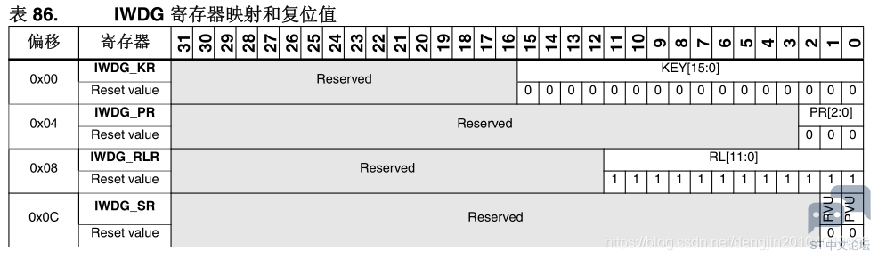

5.5 IWDG寄存器映射
$ }! {) \; N0 ?3 S& Y+ H0 j下表提供了 IWDG 寄存器映射和复位值。) x9 i& ]7 S% V+ V. `+ o
[attachimg]4**8[/attachimg]/ P5 C) M/ Z8 b' X1 M, p
