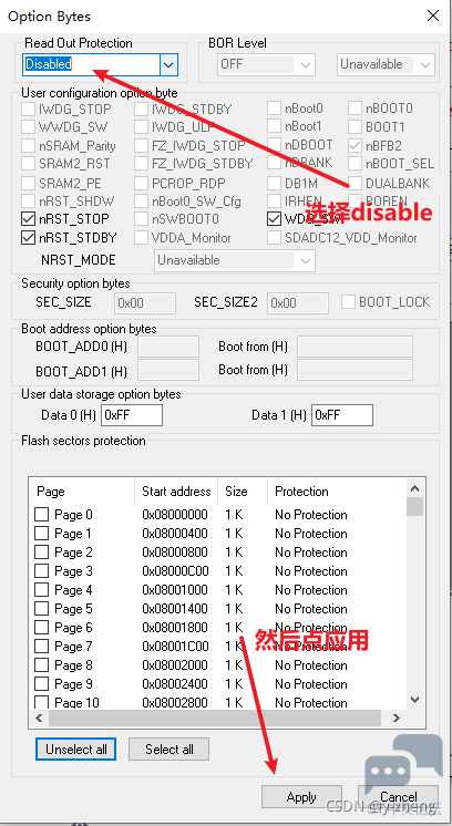

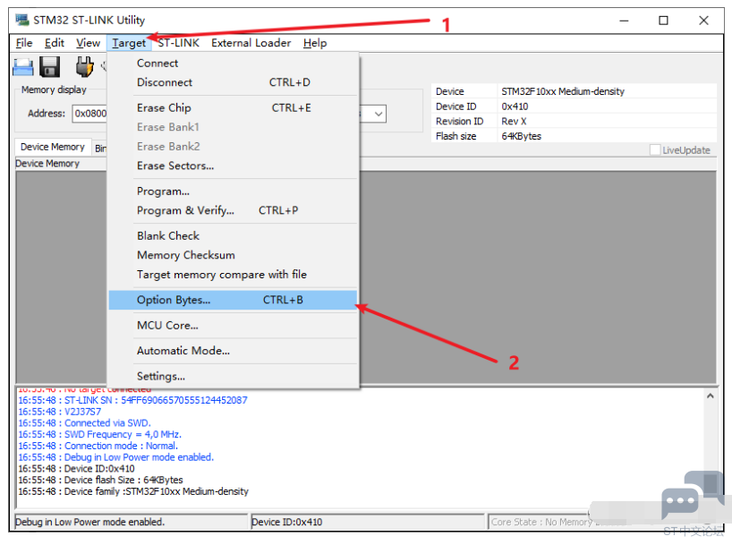

下载安装ST官方的软件STM32 ST-LINK Utility,选择target->Option Bytes...  w' u1 X; K; Y* _0 _: X: C

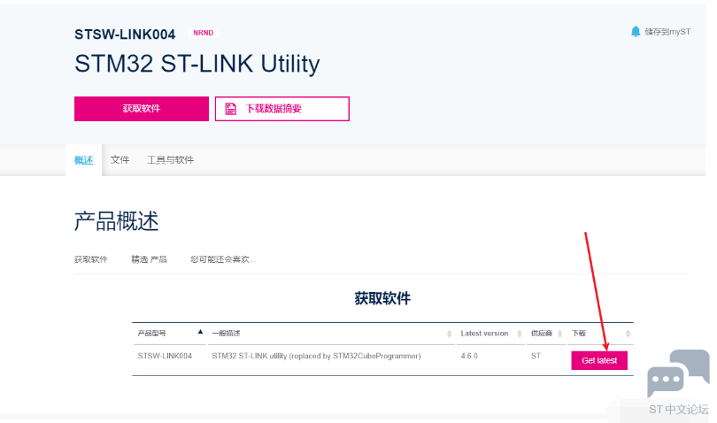

# p9 [' w+ z5 X, g/ @ST官网软件下载地址:https://www.st.com/zh/development-tools/stsw-link004.html
