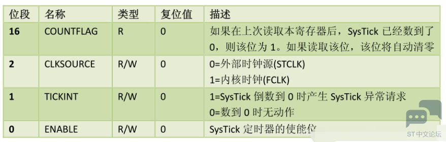

SysTick控制及状态寄存器(地址:0xE000_E010)
+ \# \" M" ^6 r( @: u6 M5 A9 G4 V' F4 s: P) m
XOXG[EB1]FJW]D{{5V)0BPL.png # R3 L! c  f, Q4 ]8 ]/ \( g" R

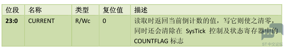

SysTick当前数值寄存器(地址:0xE000_E018)
4 z  M0 J' |+ c9 U1 e* K9 Y
8 S5 `$ l3 `+ m7 o7 y 20200830102451227.png 1 Y: E6 t0 m7 e$ W

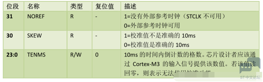

( t* m! @3 s, C( r+ `SysTick校准数值寄存器(地址:0xE000_E01C)
8 ^, d+ W7 _, v: {8 F" M
