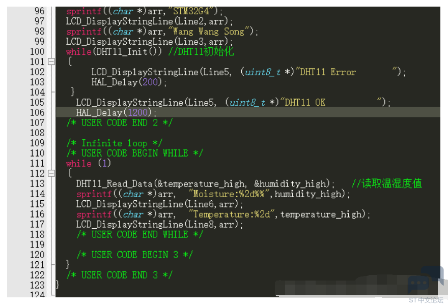

2.DHT11读取测试9 b# @  m% W; H( Z
- Y* D3 s9 Q& }3 S$ K$ y
  z( x: s; v% Y! |( B9 W1 m. f
  1. while(DHT11_Init())        //DHT11初始化
    4 U$ o2 v. d6 w  F4 ~0 Y
  2.   {* M5 {+ `1 w/ M8 Y
  3.        LCD_DisplayStringLine(Line5, (uint8_t *)"DHT11 Error       ");
    ) ]1 Q6 i9 q) M' `7 F* ^6 m
  4.        HAL_Delay(200);- ?8 R) v& ~9 G. N
  5.    }
    5 N3 P- y$ E8 X; D1 D& x! X- f
  6.     LCD_DisplayStringLine(Line5, (uint8_t *)"DHT11 OK          ");$ ^: C( w2 R( _
  7.     HAL_Delay(1200);
  1.                 DHT11_Read_Data(&temperature_high, &humidity_high);                //读取温湿度值/ k, B( |+ u' v) j) L2 @8 S- W
  2.                 sprintf((char *)arr,  "Moisture:%2d%%",humidity_high);
    , j0 _3 v& \8 q4 S# z- t$ S- M2 |
  3.                 LCD_DisplayStringLine(Line6,arr);
    2 F+ \8 J  @9 Q5 s& X0 O
  4.                 sprintf((char *)arr,  "Temperature:%2d",temperature_high);
    1 c& W) f8 _; S) N; S, D0 g# B
  5.                 LCD_DisplayStringLine(Line8,arr);' |: W/ ~' P( a+ i
