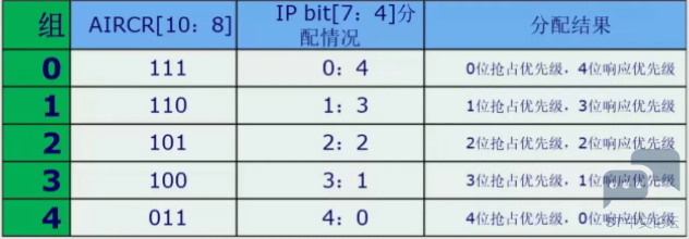

7 P+ ]& C' S! B% e0 U1 r1 b三者之间的关系:
5 ^; H: N5 X" R$ h+ QSTM32中有5中分组方式:
3 w: r; ]2 w9 }7 P$ Z
2 t, X9 [& J& i, D- ~
#define NVIC_PriorityGroup_0         ((uint32_t)0x700)
/*!< 0 bits for pre-emption priority  4 bits for subpriority */+ _9 r% l" p. @3 J+ t
#define NVIC_PriorityGroup_1         ((uint32_t)0x600)
/*!< 1 bits for pre-emption priority 3 bits for subpriority */
* Z3 \$ D6 {+ l8 F#define NVIC_PriorityGroup_2         ((uint32_t)0x500)
/*!< 2 bits for pre-emption priority 2 bits for subpriority */
8 i# \8 I# z  i7 z: p: I( W( U#define NVIC_PriorityGroup_3         ((uint32_t)0x400)
/*!< 3 bits for pre-emption priority1 bits for subpriority */7 w/ g3 d/ Q/ ]( M6 l6 d# u
#define NVIC_PriorityGroup_4         ((uint32_t)0x300)
/*!< 4 bits for pre-emption priority 0 bits for subpriority */
, g# w* I6 G' Y( b! v这里的NVIC分组是指把多少位分给抢占优先级,多少位分给响应优先级,总共有4个位由于分组! i- t% _8 L+ Y& ~5 ^
第0组:4位都用于响应优先级
6 y, S2 r8 l5 F第1组:1位用于抢占优先级(2种),3位用于响应优先级(8种)
6 Q5 \: m( ]. b. K9 Q1 O第2组:2位用于抢占优先级(4种),2位用于响应优先级(4种)3 I9 l! P1 g2 c' G
第3组:3位用于抢占优先级(8种),1位用于响应优先级(2种)
第4组:4位用于抢占优先级(16种)

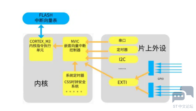

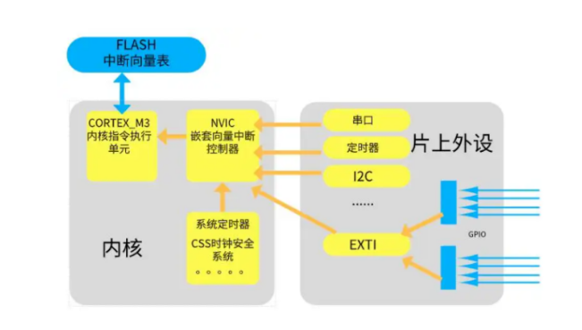

STM32F中断体系结构如下:
