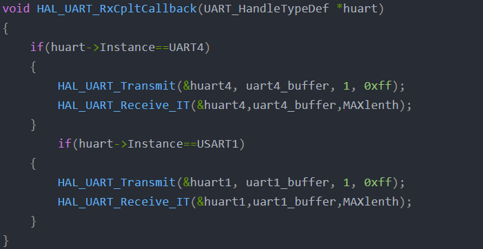

4、收发函数中可以优化的部分: p' E1 }7 G: [" L. g- r
a、串口接收在回调函数中使用:4 a  _3 f  w4 L5 w
, q9 g  L% b/ I+ {) d
, ~& y) ~( |  j4 [+ o5 `
  1. void HAL_UART_RxCpltCallback(UART_HandleTypeDef *huart)" x4 J" E+ V3 ^+ w: S8 s- x" [. A
  2. {
    2 t  Y& k$ Q% e+ w; R2 d$ D7 d4 ^
  3.     if(huart->Instance==UART4)/ `9 N; ^) k) Q* U4 l, L$ a1 Y
  4.     {
    1 @" J' F2 O. t2 J- P4 i
  5.         HAL_UART_Transmit(&huart4, uart4_buffer, 1, 0xff);
    1 ]" k$ C& {0 J
  6.         HAL_UART_Receive_IT(&huart4,uart4_buffer,MAXlenth);
    5 ~7 o( |! C' ?  [1 ~0 U8 v
  7.     }% T- b* E5 G* P+ a. }+ P- W
  8.                 if(huart->Instance==USART1)/ z, E$ b* t4 S
  9.     {2 y# C* b6 k2 t/ U+ C9 |# c
  10.         HAL_UART_Transmit(&huart1, uart1_buffer, 1, 0xff);9 w! H2 E8 _; L! V. Z
  11.         HAL_UART_Receive_IT(&huart1,uart1_buffer,MAXlenth);
    9 @% G3 L6 q4 h7 [9 T0 F2 A/ m
  12.     }
    * L/ C9 v8 P; ?0 }$ }8 _
  13. 7 p4 Z) @+ t4 H& X. _0 n. ?
! P: t6 [; r( E! V  ^. ^! n
在上述回调函数中,把UART4和USART1的接收字节存入数组uart4_buffer和uart1_buffer,MAXlenth为最大接收长度。
