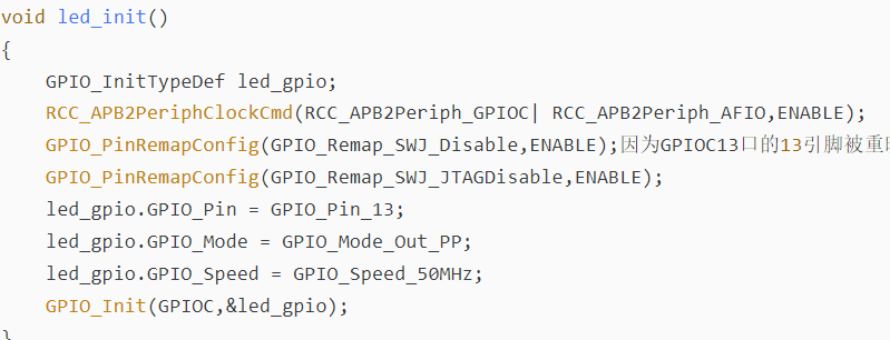

1,LED的GPIO口初始化
  1. void led_init()' @) i9 z! Q- O% y. y; \
    # Y" e% \+ V8 S# L+ t
  3.         GPIO_InitTypeDef led_gpio;
    4 k- n+ m2 R9 ~7 Z" D* n
  4.         RCC_APB2PeriphClockCmd(RCC_APB2Periph_GPIOC| RCC_APB2Periph_AFIO,ENABLE);3 W% w7 B5 m8 Y; B( b  T
  5.         GPIO_PinRemapConfig(GPIO_Remap_SWJ_Disable,ENABLE);因为GPIOC13口的13引脚被重映射了,所以需要先关闭重映射/ {! l$ |6 t3 x: O4 t4 N
  6.         GPIO_PinRemapConfig(GPIO_Remap_SWJ_JTAGDisable,ENABLE);
    - O5 j: z2 m/ O* h4 v5 ~
  7.         led_gpio.GPIO_Pin = GPIO_Pin_13;
    4 q% \! C# ?0 N; v( B- u0 I
  8.         led_gpio.GPIO_Mode = GPIO_Mode_Out_PP;! p! c3 e+ L: T- K" `- M! C
  9.         led_gpio.GPIO_Speed = GPIO_Speed_50MHz;
    * B2 {; f# }$ H2 T6 J+ N, Q4 X
  10.         GPIO_Init(GPIOC,&led_gpio);
    % H  b+ n- A% l! G- R/ T' c; f
  11. }
* q5 A; l1 E3 @- h. e

  98. void led_init()
    6 K- v5 N: H/ F0 W$ p+ Z5 D
  99. {% {! j" E: c, ~9 q
  100.         GPIO_InitTypeDef led_gpio;
    4 ~  I$ u) ]( h+ C' _0 ~. G; B
  101.         RCC_APB2PeriphClockCmd(RCC_APB2Periph_GPIOC| RCC_APB2Periph_AFIO,ENABLE);# ]- n9 m: Z4 R8 U
  102.         GPIO_PinRemapConfig(GPIO_Remap_SWJ_Disable,ENABLE);
    " u. z  W& a1 S* c0 O1 O
  103.         GPIO_PinRemapConfig(GPIO_Remap_SWJ_JTAGDisable,ENABLE);
    0 c2 K1 j, J* @0 H) F
  104.         led_gpio.GPIO_Pin = GPIO_Pin_13;
    / {, z5 g7 D, L: `' l1 F* Q
  105.         led_gpio.GPIO_Mode = GPIO_Mode_Out_PP;
    & M$ |; O  v# w5 l/ r) J
  106.         led_gpio.GPIO_Speed = GPIO_Speed_50MHz;
      q- {/ q: f3 g: Z
  107.         GPIO_Init(GPIOC,&led_gpio);0 f6 n4 A" @- X; Q( m3 m
  108. }' r+ T# y9 s2 i4 K8 t, g5 q9 {- Y
