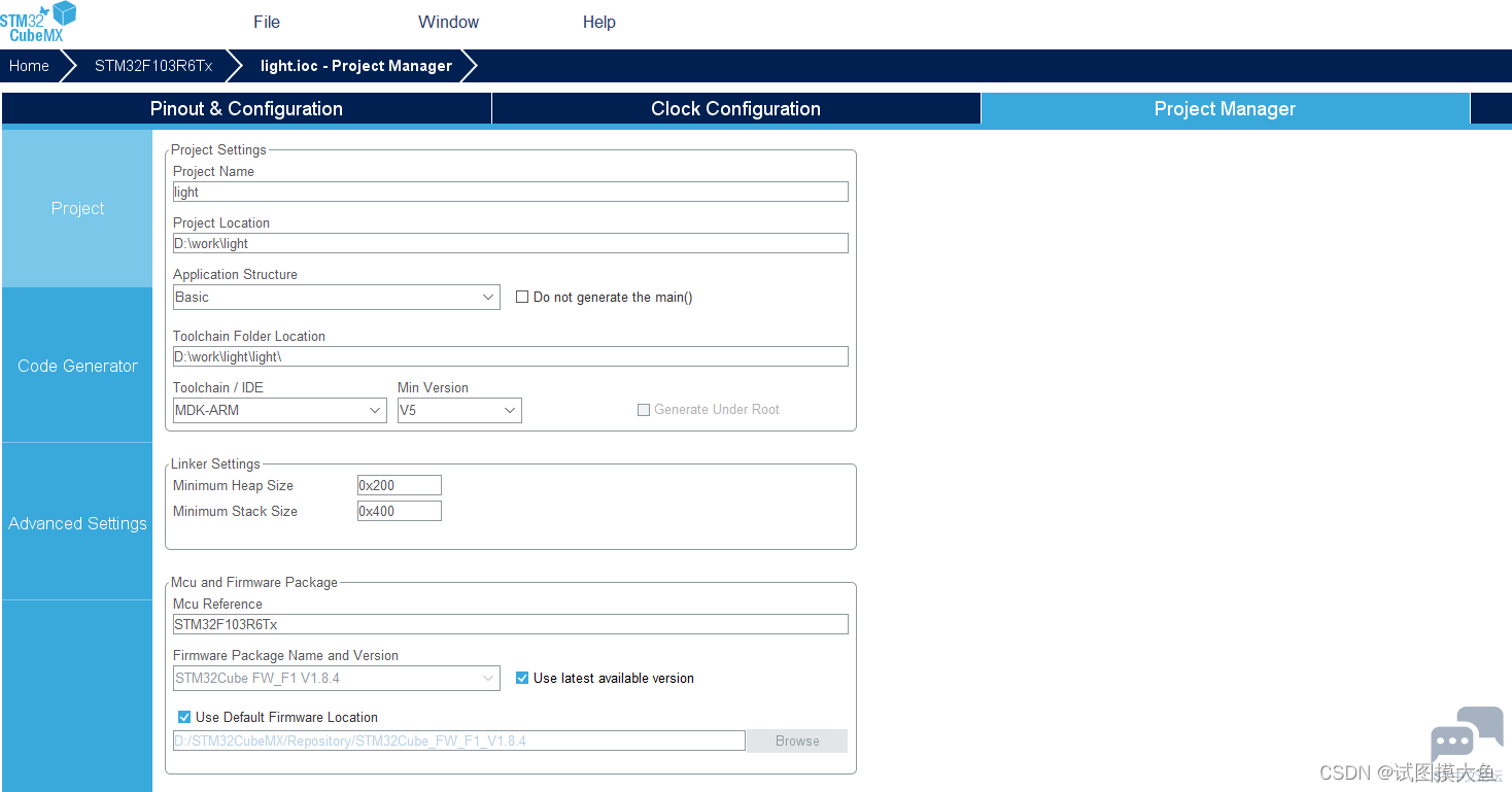

7 H. O7 r' g* d8 }, S8 K3 DSTM32CubeMX新建一个工程,然后选择芯片
- W# b) V$ P3 G6 R& p& [1 o% B+ Q8 ^: v6 @' ?/ S5 Z; d
3 x) {: Y  j; _5 r9 k; \' i: e bcbf44bcfb0e4409810de9570dd970e4.png

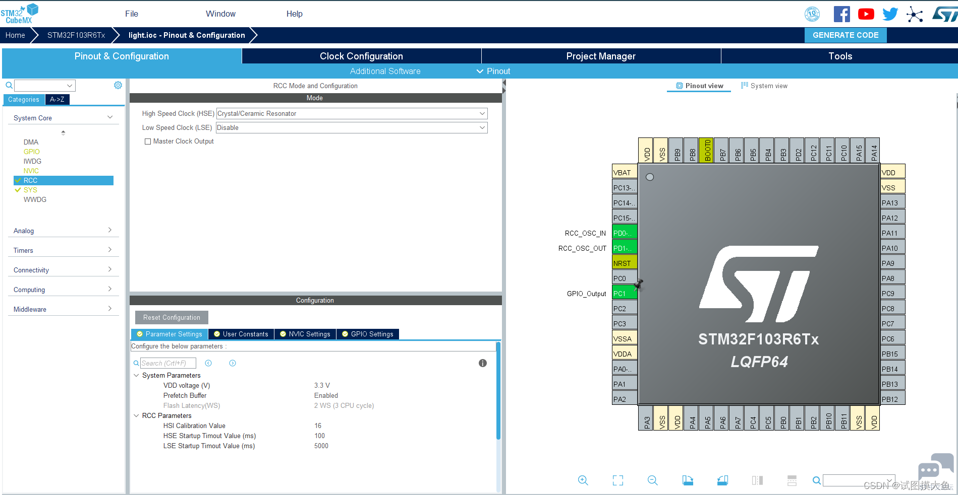

配置RCC

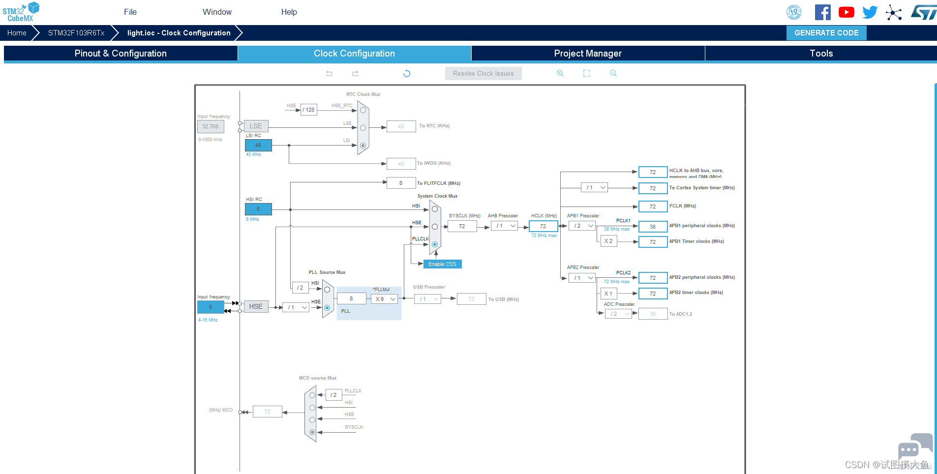

2 P: H  z. u1 O% Z4 z5 w0 z配置Clock Configuration! v4 W  o4 L* R

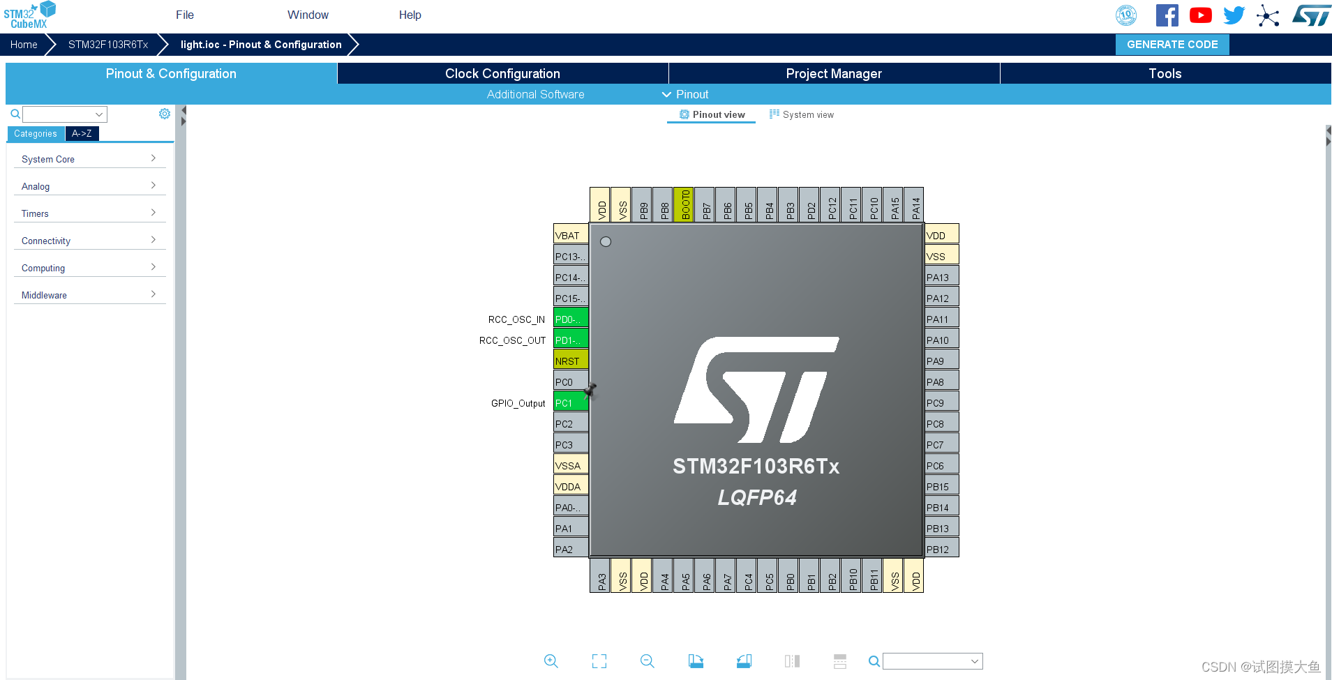

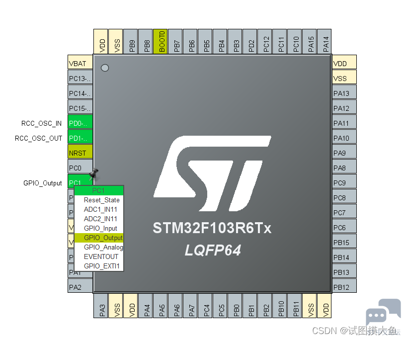

选择引脚
3 M1 N7 _5 s- n# F
- ]: l: ^% Y5 `! g- l
0 c* p9 Z0 t8 b: a3 u/ h  G) g- [  |% Q( v

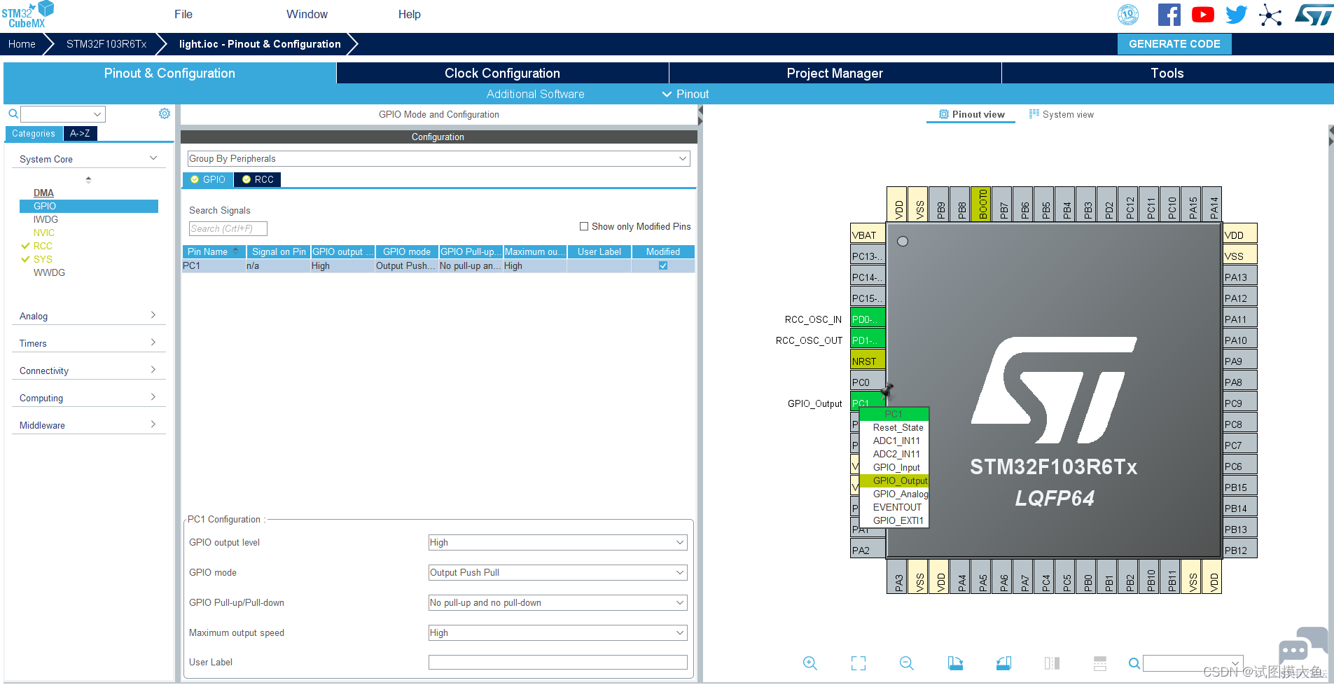

& Z# V, @/ j" r1 i6 _然后配置GPIO, p" B7 j/ \* i/ }3 l4 T  D
  M) W( k, e, G
& W* H9 L7 ?/ N  J9 e fa1a97541c524fe9962188238e2ce6d2.png 3 _+ g- _+ N4 ~! @8 r7 R; L

1 N) W! U+ S" `; i命名并选择保存位置,然后选择编辑软件5 c! A9 X; w$ b, x
# v/ k5 f5 b# h0 B8 [" d
& n5 {: W; V. f$ m3 x 0f40dd6b08464059ababcfcd8e3ebfbb.png ; T1 H! V: x+ c$ P

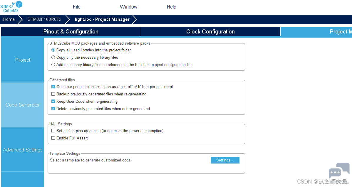

选择需要导出的内容
( @6 F' C% P1 v; `$ G
* {3 S9 W# w1 N
" H0 C7 v. o8 ]
faec83dab6e748beaf16952ff3c23639.png + {- U5 d6 n5 S$ B( z# j+ F

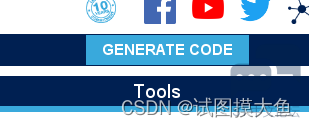

! x9 Q- F) x& C) F  j- |点击导出
9 \/ h# X0 j" u) B3 v& k1 {2 y7 o5 n# H" M& W6 T; N
7 e* }2 a) x; |4 g4 m/ f 84c89b09ec934d679bc8788eebd2aabd.png # Q! o4 [0 z' {( V* ~' _

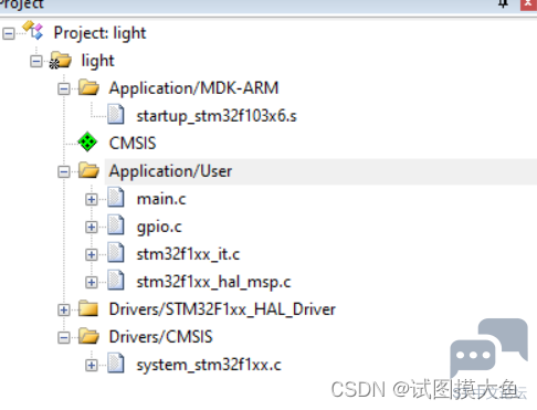

3 [8 u" V. j) \# ~- Z弹窗后Open Project  h$ H- \( A+ ]# r
  c1 w7 m& S* k( c/ |. K) p# I* R" E
3 B; z6 x8 b5 n' f7 A6 p

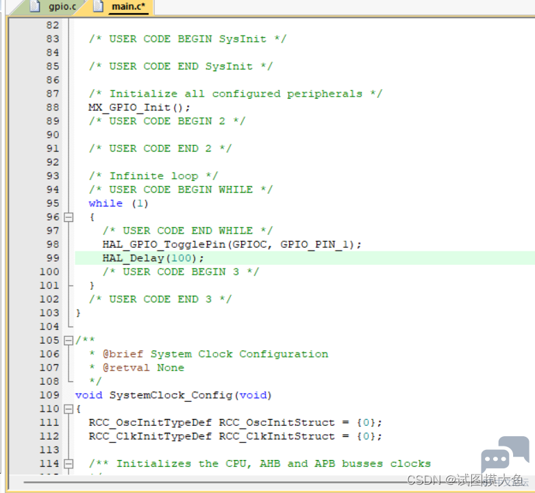

& h# K/ Q/ p# j打开main.c然后写,想让它隔多久闪就写多少,大概意思是隔多久变换一下引脚电平0 E7 W; z# F( M  S( _; Y; A
0 [  X4 S! W- T
  J  R" c& D6 e. h( M( y* C% D& t* G 0a92369ccbd64f8f8bbdef31a9f37ca5.png ( r' N* C3 S" q. o5 [/ C. h$ E

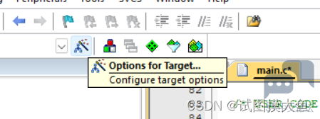

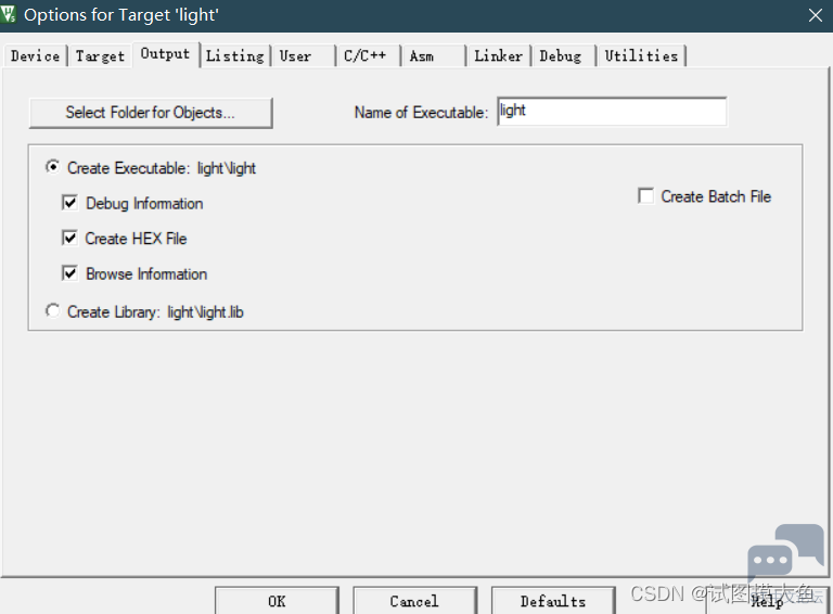

确保能导出.hex
! v2 s8 Z# M9 j# ?# Y+ w/ D
- r/ @" |1 L3 A# ^7 C; ^6 Y; Z8 X
3 R* Y; P- I* n5 @6 G( U2 B! Y* _
06c01e8c563345eaadcbc1ce1c1b175d.png 1 }1 l) _7 x: j& Z* q% y
5 J. t# _  E. E) C% ?/ C: A$ @
; l2 B' `6 }/ v- P记得勾选Creat HEX File) `" P9 f3 X+ j% C9 r

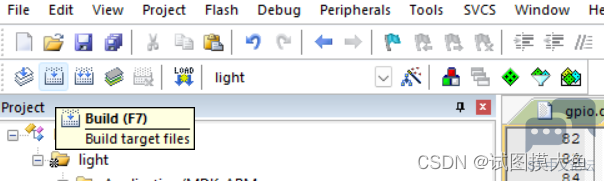

$ J5 s% r) ?) |9 y# z( i5 S' SBuild一下% p) l3 r9 C& a
( `) P" k9 A+ E) o% t
7 [  a+ D+ h. J: U2 M; X afc27ad334e944da8de1c2953cb0da8d.png   L" ]+ Y& X1 H7 x. R% h7 ^6 E

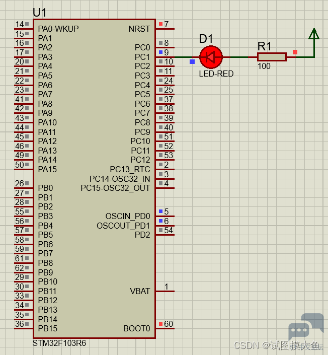

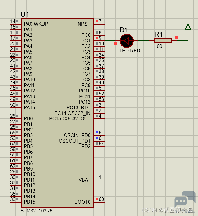

/ K+ L, e" Y/ y4 I然后打开Proteus,绘制
! h3 P8 D% A5 W+ ^2 N- ~' Z* [7 Y+ }! i3 P3 }0 @, f0 E
! T, v3 G+ B/ O9 V/ K1 e
c36bba2216ca4cd9b232827076270fb0.png 4 g3 f1 D& z. z- T8 j) d
  o; v/ H) _# W. m5 R

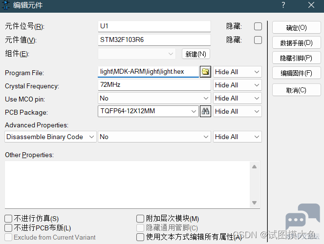

- I8 \! i/ r2 Z( w双击STM32F103R6,导入.hex并设置Crystal Frequency
( |, a/ W. _6 u1 t) r) o. M# i5 E% x  i
/ s2 \* x* g3 e! T fb044086c6a348799d7c7e130ff3cafb.png

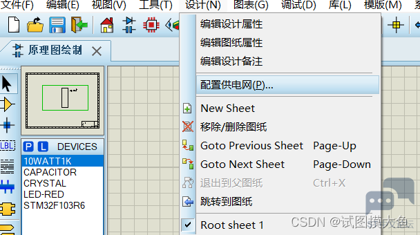

: N7 B& f$ G3 H, P! o记得需要配置供电网,不然没办法仿真

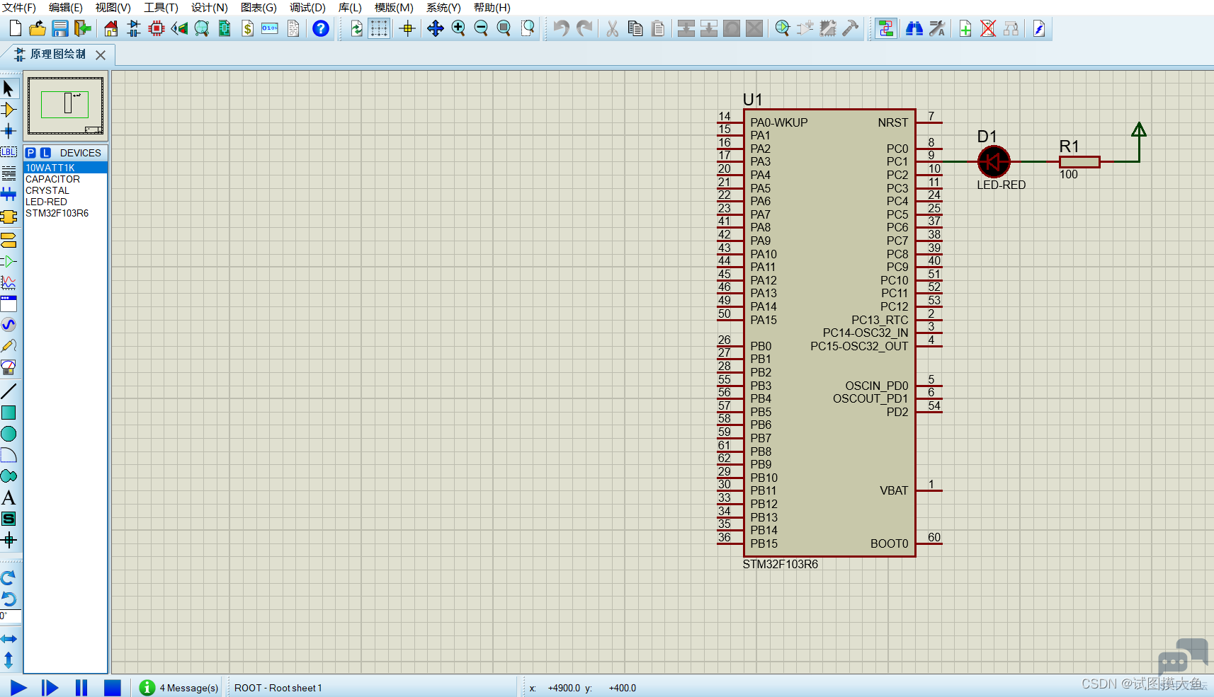

8 c2 Z. k9 i# k1 k. N点击左下角仿真
3 p' g9 Q+ z9 j/ G  C- M+ q5 d5 n2 C( x! \
6 C% E$ S# G# ~' _" Z9 R2 Z( a3 p' P9 A& y: z' X3 Z
" S4 i4 s- }: O可以看到LED闪烁' G! ^0 E0 F/ p) X' r1 O' `
