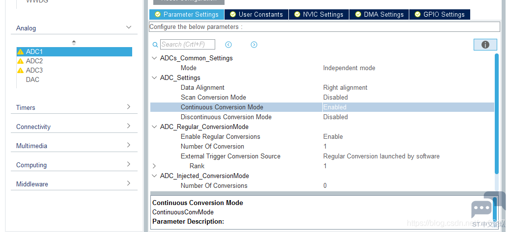

1、配置cube RCC SYS, @8 P, H+ V& c5 P; A1 o7 T- V
2、管脚定义
! C- |8 F) U0 O  |* P% Q, ~4 A; G$ f& S- p
: E9 a* G- u( r  T2 {5 e# X
( h. o; o0 p" W/ C. e" m. w3、配置+ t# ?! v. A' {- A
, `4 q: R' N; u4 E 20190830153907434.png 3 n+ B. x, |9 c0 {; o
" Y& G9 ^: C- F6 c  U+ p% f. W% i

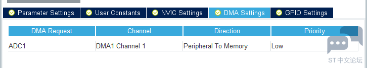

4、DMA配置
* L6 {) n( }+ G4 A" U2 z" c2 m6 L* J% R9 C7 P% q' Y
- i- R' [9 s1 s2 {9 y6 r3 C0 y+ \6 B" N

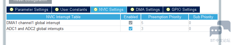

. F1 A3 ?# N, d# W/ Z9 W3 w5、NIVC配置
; ]% ?  F3 ^7 m9 O# E+ y0 n3 p& l& ~: s3 `
20190830154054674.png % Z$ E( p4 O$ e- {! z4 f5 z
