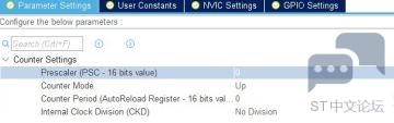

41aab3dc70a6d2590649929f913580ac.jpg - a" z7 Y' x4 a9 e8 C: O
" d% [- J) z! ]3 c& c
STM32CubeMX中的TIM预分频设置  X2 L: ^; u" A9 k
