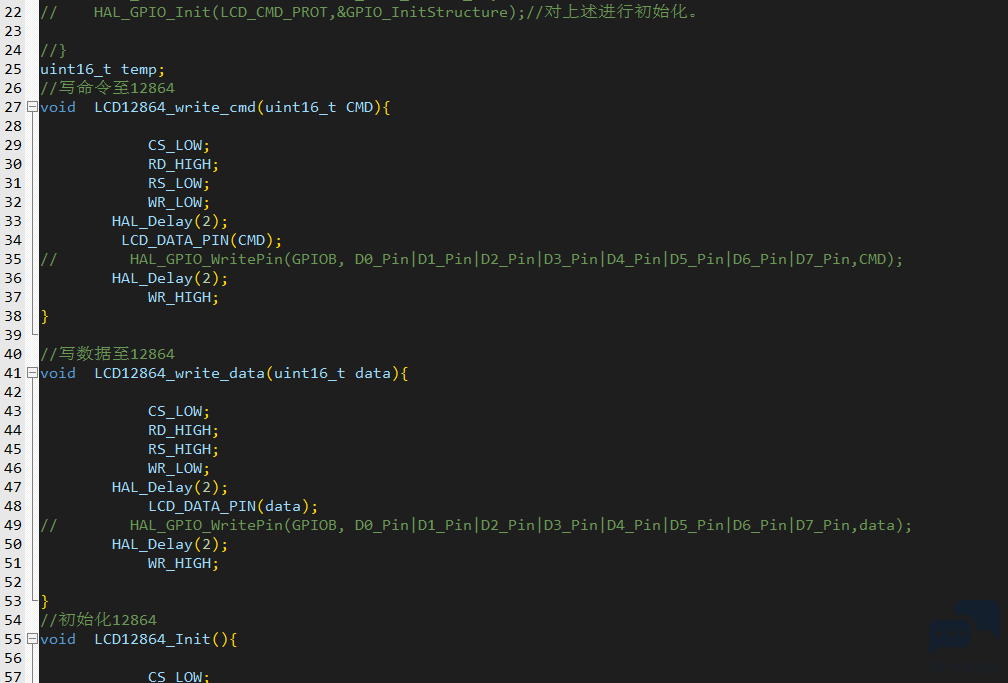

//} uint16_t temp; //写命令至12864 void LCD12864_write_cmd(uint16_t CMD){
// HAL_GPIO_WritePin(GPIOB, D0_Pin|D1_Pin|D2_Pin|D3_Pin|D4_Pin|D5_Pin|D6_Pin|D7_Pin,CMD); HAL_Delay(2); WR_HIGH; }
//写数据至12864 void LCD12864_write_data(uint16_t data){
// HAL_GPIO_WritePin(GPIOB, D0_Pin|D1_Pin|D2_Pin|D3_Pin|D4_Pin|D5_Pin|D6_Pin|D7_Pin,data); HAL_Delay(2); WR_HIGH;
} //初始化12864 void LCD12864_Init(){

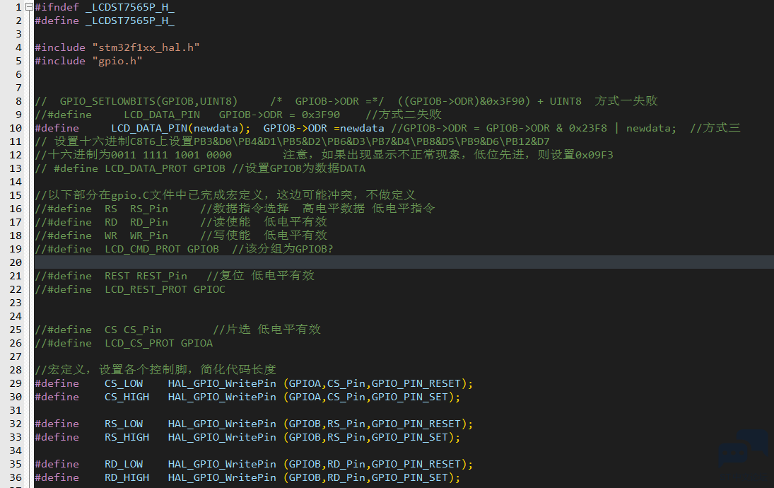

LCDST7565P.h
ifndef _LCDST7565PH
define _LCDST7565PH
include "stm32f1xx_hal.h"
include "gpio.h"

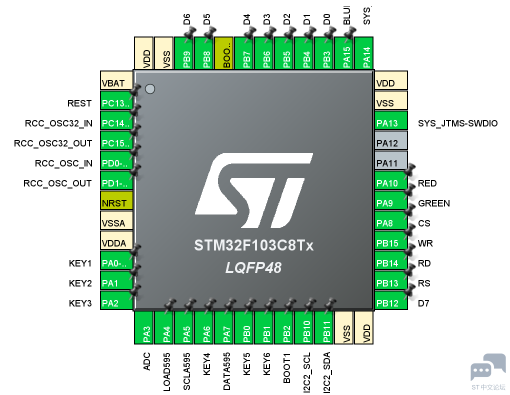

// GPIO_SETLOWBITS(GPIOB,UINT8) / GPIOB->ODR =/ ((GPIOB->ODR)&0x3F90) + UINT8 方式一失败 //#define LCD_DATA_PIN GPIOB->ODR = 0x3F90 //方式二失败
define LCD_DATA_PIN(newdata); GPIOB->ODR =newdata //GPIOB->ODR = GPIOB->ODR & 0x23F8 | newdata; //方式三
// 设置十六进制C8T6上设置PB3&D0\PB4&D1\PB5&D2\PB6&D3\PB7&D4\PB8&D5\PB9&D6\PB12&D7 //十六进制为0011 1111 1001 0000 注意,如果出现显示不正常现象,低位先进,则设置0x09F3 // #define LCD_DATA_PROT GPIOB //设置GPIOB为数据DATA
//以下部分在gpio.C文件中已完成宏定义,这边可能冲突,不做定义 //#define RS RS_Pin //数据指令选择 高电平数据 低电平指令 //#define RD RD_Pin //读使能 低电平有效 //#define WR WR_Pin //写使能 低电平有效 //#define LCD_CMD_PROT GPIOB //该分组为GPIOB?
//#define REST REST_Pin //复位 低电平有效 //#define LCD_REST_PROT GPIOC
//#define CS CS_Pin //片选 低电平有效 //#define LCD_CS_PROT GPIOA
//宏定义,设置各个控制脚,简化代码长度
define CS_LOW HAL_GPIO_WritePin (GPIOA,CS_Pin,GPIO_PIN_RESET);
define CS_HIGH HAL_GPIO_WritePin (GPIOA,CS_Pin,GPIO_PIN_SET);
define RS_LOW HAL_GPIO_WritePin (GPIOB,RS_Pin,GPIO_PIN_RESET);
define RS_HIGH HAL_GPIO_WritePin (GPIOB,RS_Pin,GPIO_PIN_SET);
define RD_LOW HAL_GPIO_WritePin (GPIOB,RD_Pin,GPIO_PIN_RESET);
define RD_HIGH HAL_GPIO_WritePin (GPIOB,RD_Pin,GPIO_PIN_SET);
define WR_LOW HAL_GPIO_WritePin (GPIOB,WR_Pin,GPIO_PIN_RESET);
define WR_HIGH HAL_GPIO_WritePin (GPIOB,WR_Pin,GPIO_PIN_SET);
define REST_LOW HAL_GPIO_WritePin (GPIOC,REST_Pin,GPIO_PIN_RESET);
define REST_HIGH HAL_GPIO_WritePin (GPIOC,REST_Pin,GPIO_PIN_SET);
//void LCD12864_UserConfig(void); void LCD12864_write_cmd(uint16_t CMD); void LCD12864_write_data(uint16_t data); void LCD12864_Init(void); void LCD12864_ClearScreen(void); unsigned char Lcd12864_Write16CnCHAR(unsigned char Page, unsigned char Column, char *cn);

你基于位操作一位位写来准备数据,也不用多少时间,写完后使能片选。你结合LCD的控制时序图看看。
所以同时给数据是个相对概念,按照这个连线,无非数据准备时间长一点点,即使分布在同一口上,也就快了几个指令周期而已。
所以很有可能是控制逻辑出了问题,最好再看看规格书。
<br /> <br />
感谢,但是我排查了电路,用示波器检测,发现其他端口均正常,就D7这个PIN的输出速率和电平不正常,然后在代码分析里面检测了DATA这个值,发现一直为0,所以觉得是数据没有写进去,代码是根据51移植的,所以感觉很大可能是赋值操作,,,,我再继续排查吧~
<br /> <br />
谢谢,代码是51单片机移植过来的,控制逻辑上感觉应该是没有太大问题,用示波器检测发现电平端口也正常,后在程序内检测DATA值一直为0,结合示波器D7端口的异常现象,觉得是值没有写到LCD内导致....
