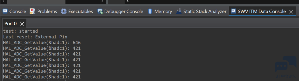

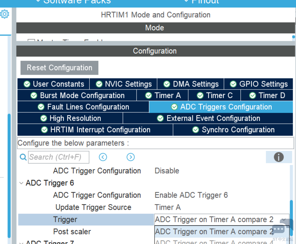

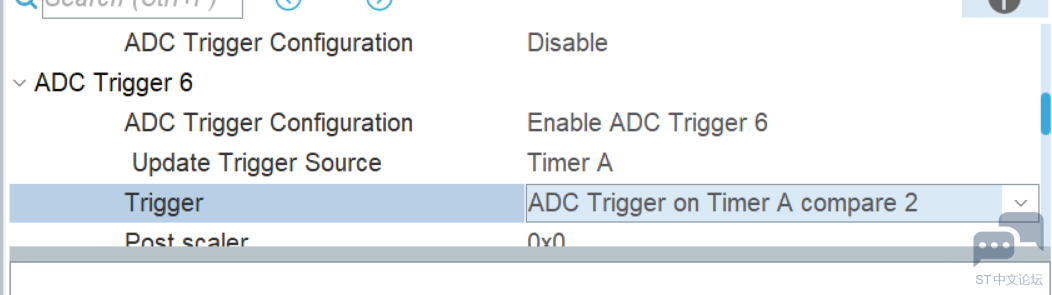

我在用G474 HRTIM驱动BLDC电机,尝试使用ADC trigger在下管导通时(CMP2作为reset source)去触发低侧电流感应。现在的问题是即使CMP2中断回调可以被正常调用,PWM波形也正常,ADC依然没被触发。

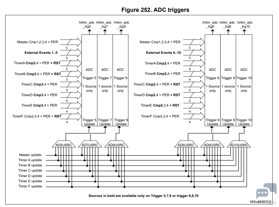

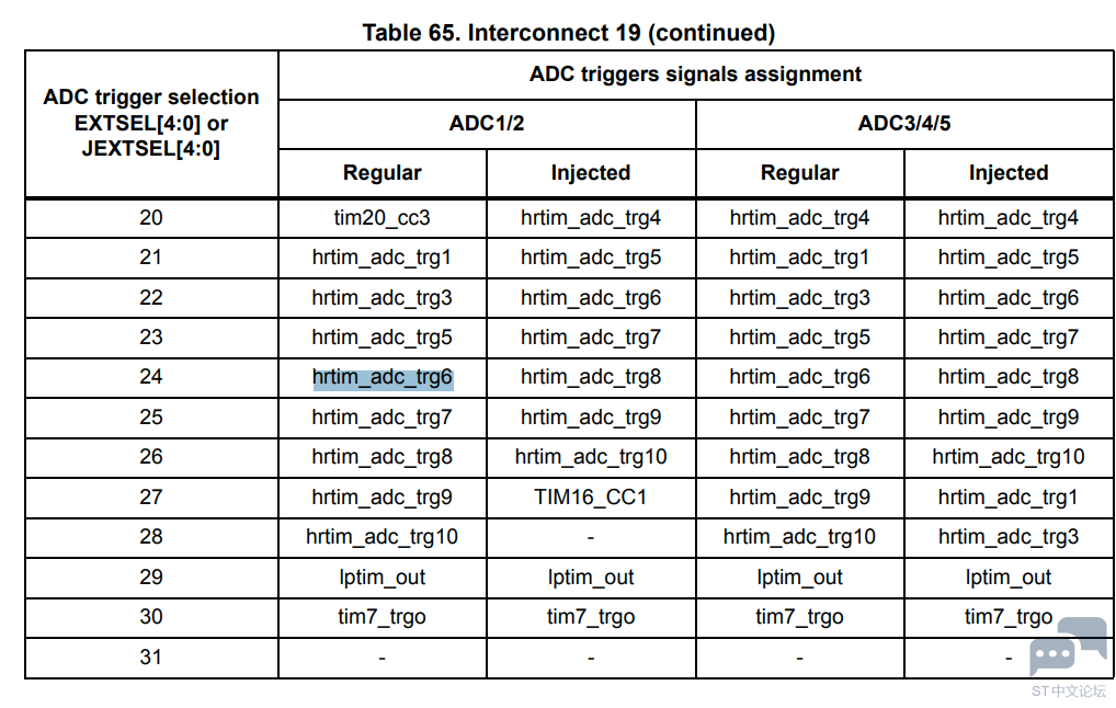

因为没有使用CubeMX生成代码,是对着Cube包内的Example抄的,所以我想可能是某些信号配置在硬件上不可实现。但是我检查了Datasheet和用Cube生成的代码,我的配置是可以实现的。

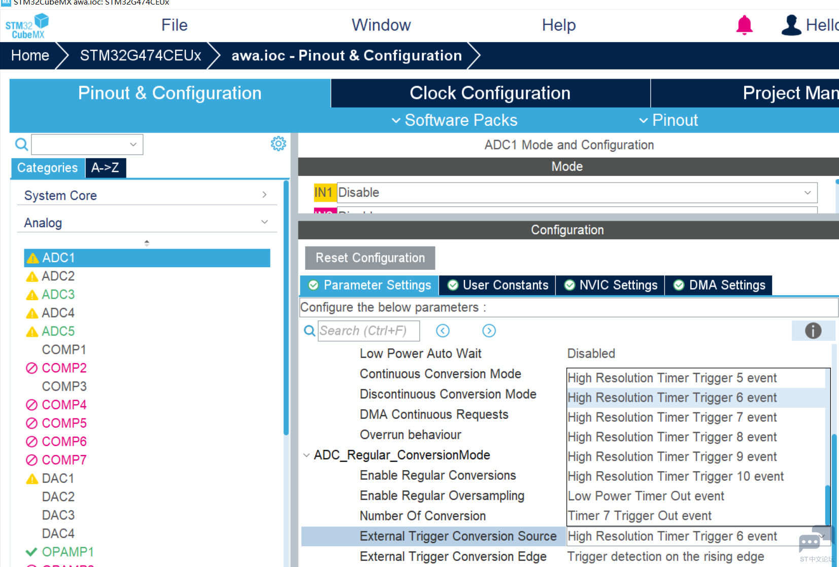

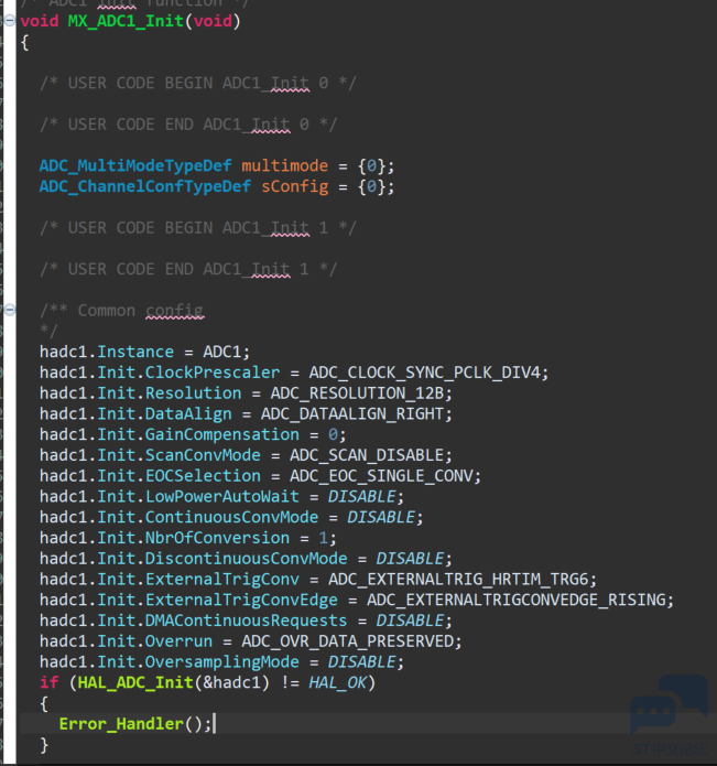

ADC和HRTIM配置如下:
    __HAL_RCC_ADC12_CLK_ENABLE();
    this->adc1_handle.Instance                   = ADC1;
    this->adc1_handle.Init.ClockPrescaler        = ADC_CLOCK_SYNC_PCLK_DIV4;
    this->adc1_handle.Init.Resolution            = ADC_RESOLUTION_12B;
    this->adc1_handle.Init.DataAlign             = ADC_DATAALIGN_RIGHT;
    this->adc1_handle.Init.GainCompensation      = 0;
    this->adc1_handle.Init.ScanConvMode          = ADC_SCAN_DISABLE;
    this->adc1_handle.Init.EOCSelection          = ADC_EOC_SINGLE_CONV;
    this->adc1_handle.Init.LowPowerAutoWait      = DISABLE;
    this->adc1_handle.Init.ContinuousConvMode    = DISABLE;
    this->adc1_handle.Init.NbrOfConversion       = 1;
    this->adc1_handle.Init.DiscontinuousConvMode = DISABLE;
    this->adc1_handle.Init.ExternalTrigConv      = ADC_EXTERNALTRIG_HRTIM_TRG6;
    // this->adc1_handle.Init.ExternalTrigConv      = ADC_SOFTWARE_START;
    this->adc1_handle.Init.ExternalTrigConvEdge  = ADC_EXTERNALTRIGCONVEDGE_RISING;
    this->adc1_handle.Init.DMAContinuousRequests = DISABLE;
    this->adc1_handle.Init.Overrun               = ADC_OVR_DATA_OVERWRITTEN;
    this->adc1_handle.Init.OversamplingMode      = DISABLE;
    auto result = HAL_ADC_Init(&(this->adc1_handle));
    if (result != HAL_OK)
        throw hardware_error(result, "HAL_ADC_Init ADC1");
    ADC_MultiModeTypeDef multimode1 = {};
    multimode1.Mode                 = ADC_MODE_INDEPENDENT;
    result = HAL_ADCEx_MultiModeConfigChannel(&(this->adc1_handle), &multimode1);
        throw hardware_error(result, "HAL_ADCEx_MultiModeConfigChannel ADC1");
    this->vopamp1_handle.Channel      = ADC_CHANNEL_VOPAMP1;
    this->vopamp1_handle.Rank         = ADC_REGULAR_RANK_1;
    this->vopamp1_handle.SamplingTime = ADC_SAMPLETIME_640CYCLES_5;
    this->vopamp1_handle.SingleDiff   = ADC_SINGLE_ENDED;
    this->vopamp1_handle.OffsetNumber = ADC_OFFSET_NONE;
    this->vopamp1_handle.Offset       = 0;
    result = HAL_ADC_ConfigChannel(&(this->adc1_handle), &(this->vopamp1_handle));
        throw hardware_error(result, "HAL_ADC_ConfigChannel VOPAMP1");
    result = HAL_ADCEx_Calibration_Start(&(this->adc1_handle), ADC_SINGLE_ENDED);
        throw hardware_error(result, "HAL_ADCEx_Calibration_Start ADC1");
    HAL_NVIC_SetPriority(ADC1_2_IRQn, 7, 0);
    HAL_NVIC_EnableIRQ(ADC1_2_IRQn);
    result = HAL_ADC_Start_IT(&(this->adc1_handle));
        throw hardware_error(result, "HAL_ADC_Start ADC1");

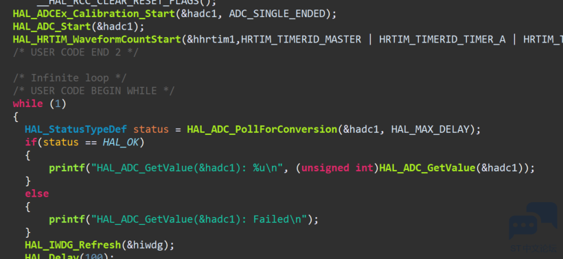

AlanCui 最优答案 回答时间:2024-11-5 13:46:09
AlanCui 发表于 2024-11-5 11:39</p>
<p>[md]我这里用CubeMX生成代码 Trigger6+TIMA CMP2触发,是可以正常转换的,您再确定一下?
[md]Hi,
最后确认问题在
hrtim_adctrig_cfg.Trigger      = HRTIM_ADCTRIGGERUPDATE_TIMER_A;
hrtim_adctrig_cfg.UpdateSource = HRTIM_ADCTRIGGEREVENT579_TIMERA_CMP3;
其中Tigger和UpdateSource设置错误的被对调了,交换就可以正常触发。
感谢您的帮助
xmshao 回答时间:2024-11-5 13:51:46
[md]哦,可以了。
我这边找到原因了,之前认为CMP2事件不可以,是因为我代码方面的原因。
之前 我针对HRTIM做了其它测试,对CMP2的比较值做了特别处理。 我屏蔽相关代码后,
Trigger 6/on tima cmp2也是可以的。
xmshao 回答时间:2024-11-4 18:13:10
AlanCui 发表于 2024-11-4 14:44
Hi,</p>
<p>感谢你的回复,我试图改用了CMP3触发,依然是<code>HAL_HRTIM_Compare3EventCallback</code> 可被观察到调 ...
[md]哦,HRTIM作为ADC的trigger可以有很多个,我刚好是基于 ADC Trigger 1做的测试,它刚好不支持TIMA CMP2事件作为触发源,没有进一步看其它的Trigger。
所以,我那里只是针对 ADC Trigger 1所言的。TIMA CMP2事件其实可以作为其它trigger源的,谢谢指正。
另外,我觉得ADC能否触发和数据的提取是基于中断还是DMA方式没有什么关系。 至少先要被触发启动。

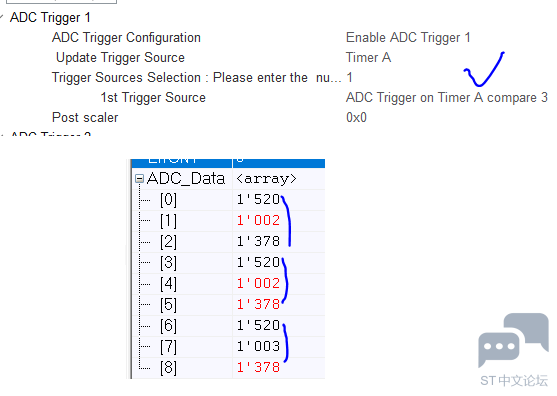

xmshao 回答时间:2024-11-4 11:20:01
就你的问题,这边查看了相关手册并基于STM32G4开发板做了验证测试。
TIMA的CMP1和CMP2事件没法做ADC1的启动触发源,我们可以尝试使用其它hrtim事件,比方
CMP3、CMP4事件。
下面就是我基于CMP3事件来触发ADC,DMA搬运转换结果的截图。
AlanCui 回答时间:2024-11-4 14:44:41
xmshao 发表于 2024-11-4 11:20
就你的问题,这边查看了相关手册并基于STM32G4开发板做了验证测试。</p>
<p>
Hi,
感谢你的回复,我试图改用了CMP3触发,依然是HAL_HRTIM_Compare3EventCallback 可被观察到调用,ADC仍无法触发。值得注意的是,我使用的是ADC中断模式,这是否会造成问题?我在继续尝试其他组合。
另,我觉得你说的没有道理,请问CMP1/CMP2不能触发ADC1是实测出来的吗?但是,参照RM0440,p.382:e72071aa347a375b947211980dd6f7af.png
ADC1可以连接到TRG6,而TRG6显然可以由CMP2触发(p.924,RM0440):
同时 我的NUCLEO版本是C04,其上搭载的芯片是rev.X,我未在勘误表中找到关于该问题的描述,请问这是否是一个芯片缺陷?
AlanCui 回答时间:2024-11-5 08:29:43
Hi,
再三确认,ADC_HandleTypeDef的State成员为0x100,HAL_ADC_STATE_REG_BUSY ,这指示ADC就绪且准备触发,因此可以确定不是数据获取的问题,也不是ADC发生了什么错误。
令人疑惑的是HRTIM的波形输出依然正常,若通过软件触发ADC也正常,不像是什么配置错误。
我试着用CubeMX生成代码试试
请问STM32提供监听event的调试功能吗?

[md]后来,我使用你配置做了验证测试,即Trigger 6/ on TIMA cmp2来触发ADC,失败了。
若换成PER事件是可以的。后来,我尝试换成TIMA cmp4事件,也是可以的。不论中断还是DMA方式获取数据都可以。
你可以考虑换用别的CMP事件,至于为什么选择TIMA/CMP2做Trigger不行,一时半会还无法定论,得慢慢找原因。
AlanCui 回答时间:2024-11-5 11:39:23
xmshao 发表于 2024-11-5 11:36
后来,我使用你配置做了验证测试,即Trigger 6/ on TIMA cmp2来触发ADC,失败了。</p>
<p>若换成PER事件是 ...
