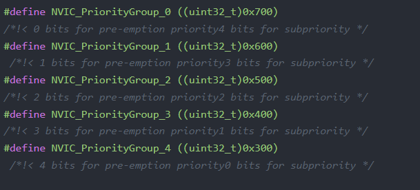

' j, O: S9 h- U/ F: U8 I4 F+ o) K一、stm32的NVIC 分组配置" Q# `# U, Q8 F" D9 L: O
STM32最多有 5 种优先级分组设置,这 5 个分组在 msic.h 中有定义。因为FreeRTOS 的中断配置没有处理亚优先级这种情况,所以我们只能配置中断优先级分组为 4,直接就 16 个主优先级,使用起来也简单!3 C2 V1 r0 T/ p) Q5 _; V
4 u, U; X, T$ Z/ _
  1. #define NVIC_PriorityGroup_0 ((uint32_t)0x700) 7 U5 D) b: D) j/ {7 C  Z5 D5 z
  2. /*!< 0 bits for pre-emption priority4 bits for subpriority */
    ( {/ Z) O2 Q2 |
  3. #define NVIC_PriorityGroup_1 ((uint32_t)0x600)8 I3 l/ T' i+ v6 l0 R4 B
  4. /*!< 1 bits for pre-emption priority3 bits for subpriority */# S# C. ]) ], {; Q* l" ^9 S
  5. #define NVIC_PriorityGroup_2 ((uint32_t)0x500) - N5 F' `, U% [3 j
  6. /*!< 2 bits for pre-emption priority2 bits for subpriority */0 X- M$ T8 C1 o" l) f7 K
  7. #define NVIC_PriorityGroup_3 ((uint32_t)0x400)
    2 C) K$ x( Q% _% d
  8. /*!< 3 bits for pre-emption priority1 bits for subpriority */, \5 N5 H% H+ x) P' ~
  9. #define NVIC_PriorityGroup_4 ((uint32_t)0x300)+ u/ }" s7 M1 R
  10. /*!< 4 bits for pre-emption priority0 bits for subpriority */
