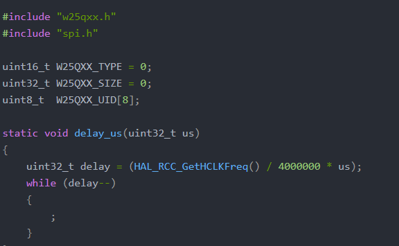

【经验分享】基于STM32使用HAL库W25Q128驱动程序
STMCU小助手 发布时间:2022-4-9 23:03
在头文件中简单修改一下片选引脚IO即可使用。* }' {! v) W2 F: `& T, j; }
, I+ X5 l* r4 `( `) ~& y! `  l源文件
0 G7 }' ?: w5 x/ |* U, g0 L4 s. Q
" b6 I2 T2 k/ J8 q. D- E3 Z
  1. /**& x- l  Z$ q8 R
  2. * @file  w25qxx.c) y* j" l8 s7 z8 c% `* `
  3. *
    ! J0 d1 V( {. U) q, |
  4. * @brief Create by AnKun on 2020/6/186 C4 d/ L% u) `; F9 G. J4 h2 f
  5. *
    # g6 e0 {4 m1 z" `" F/ I" e8 ]
  6. */
    ! e0 |+ S+ |- l5 s+ E
  7. ( {( l4 J1 ~4 ], h% n# @) C
  8. #include "w25qxx.h"4 C* K( K. O$ B' B5 k
  9. #include "spi.h"
    8 M* p5 P, k" F+ r
  10. $ w* ~1 c+ r! u: w% g* e
  11. uint16_t W25QXX_TYPE = 0;! B  h: o& ]: C4 I+ s/ e
  12. uint32_t W25QXX_SIZE = 0;
    / _6 C5 [- H1 T1 B4 S4 A# l" _, _
  13. uint8_t  W25QXX_UID[8];
    . K1 a% i5 }" Z2 h  ~% |
  14. ' T1 h, R0 M# O; j  A) j0 `% j
  15. static void delay_us(uint32_t us)
    " ^, k* ~/ P  N# a0 i0 p$ `
  16. {: N6 i  W: |: ?
  17.     uint32_t delay = (HAL_RCC_GetHCLKFreq() / 4000000 * us);( \) n0 N, t5 x
  18.     while (delay--); V% z7 {; |( k& f( K0 `$ L7 B

    8 Z1 \8 c6 s) U. z9 k
  188.     W25QXX_SPI_ReadWriteByte((uint8_t)WriteAddr);
    / h- g' S- Z6 N
  189.     for (i = 0; i < NumByteToWrite; i++)! g# g* h" ^1 {/ g* M
  190.         W25QXX_SPI_ReadWriteByte(pBuffer<i>); //循环写数1 `* N% t4 D# z4 U9 @/ u
  191.     W25QXX_CS_H();  //取消片选1 s" {( E$ D9 ]  w7 x
  192.     W25QXX_Wait_Busy();                                                           //等待写入结束
    $ X$ A4 w* w- f; o6 \4 ]6 ?
  193. }
    # P$ u+ M6 p' G/ F% D
  194. //无检验写SPI FLASH
    * t  A' ]% n) |" u
  195. //必须确保所写的地址范围内的数据全部为0XFF,否则在非0XFF处写入的数据将失败!2 F: x% R7 u& R% n% O/ l0 O
  196. //具有自动换页功能
    ) \; l* _, o: J" d7 ]; v7 @' m
  197. //在指定地址开始写入指定长度的数据,但是要确保地址不越界!" ^) q+ |4 g1 U
  198. //pBuffer:数据存储区
      r# V1 z% m3 c1 N  S7 w$ P5 p
  199. //WriteAddr:开始写入的地址(24bit)
    . B, A: H; B: s
  200. //NumByteToWrite:要写入的字节数(最大65535)
    + J" }# ?+ Q1 ?7 R
  201. //CHECK OK
    % g. Z  G; S: U1 U
  202. void W25QXX_Write_NoCheck(uint8_t *pBuffer, uint32_t WriteAddr, uint16_t NumByteToWrite); I6 D) J) X4 R5 f9 d" O
  203. {$ i' [+ I/ }2 E8 S+ l+ L2 ?
  204.     uint16_t pageremain;
    2 a: k! \$ W7 l9 i/ u
  205.     pageremain = 256 - WriteAddr % 256; //单页剩余的字节数
    1 K! }8 _4 x, {+ i/ X
  206.     if (NumByteToWrite <= pageremain)  b$ n% X6 b9 Q( o
  207.         pageremain = NumByteToWrite; //不大于256个字节
    3 x& C3 u& u& [( B/ Z% h+ K
  208.     while (1)
      F) X/ i/ ^3 E: _6 q  ^* c
  209.     {0 }8 ]. f6 e& s+ `8 _) ~# g0 t
  210.         W25QXX_Write_Page(pBuffer, WriteAddr, pageremain);
    . }* @) Z# Q8 H% N2 j. z' h
  211.         if (NumByteToWrite == pageremain)2 i! Z( I9 G% H5 f
  212.             break; //写入结束了
    ! _& o( [* o" R
  213.         else //NumByteToWrite>pageremain) l7 ~* b+ D' u! [3 J% n7 j3 x
  214.         {
    6 S8 v3 M; W$ v
  215.             pBuffer += pageremain;. y& `, Z* [+ h
  216.             WriteAddr += pageremain;* |) I  x' J8 ^. L9 }4 M8 f' n
  217. 6 y8 |0 L4 Y8 x5 g* H
  218.             NumByteToWrite -= pageremain;                          //减去已经写入了的字节数4 q" k/ e2 N; p
  219.             if (NumByteToWrite > 256)
    ' L' I2 p  b% s1 m% O
  220.                 pageremain = 256; //一次可以写入256个字节
    " C8 D  w, q) _9 k
  221.             else
    1 W9 O/ y" `1 i9 s/ Z& [7 S2 e  M
  222.                 pageremain = NumByteToWrite;           //不够256个字节了* p; u+ H0 r3 @! @, j
  223.         }  ^. q9 G6 p8 `
  224.     };0 v6 L) F2 h1 e* N3 a
  225. }
    9 R1 d$ h8 f4 M; A. Y- ?
  226. //写SPI FLASH% i! {6 u, T0 t! m
  227. //在指定地址开始写入指定长度的数据4 R! K' W# j& a5 A2 L7 E
  228. //该函数带擦除操作!
    & y3 g( ~* ]* y5 Q( d5 p
  229. //pBuffer:数据存储区
    ' U/ ]+ U- }# E# N
  230. //WriteAddr:开始写入的地址(24bit)
    " {9 Y% G$ s9 F% i1 m" [0 P
  231. //NumByteToWrite:要写入的字节数(最大65535)
    - O& v$ T  \% O2 \
  232. uint8_t W25QXX_BUFFER[4096];$ `- N4 S  q+ Z( T2 ]# C
  233. void W25QXX_Write(uint8_t *pBuffer, uint32_t WriteAddr, uint16_t NumByteToWrite)
    : b) f4 G& N' m7 f9 `; ~  T" V
  234. {
    # q2 T: H1 o+ b
  235.     uint32_t secpos;3 b, g0 i- d6 F+ p% W
  236.     uint16_t secoff;
    ' |8 K0 z3 {4 z! a
  237.     uint16_t secremain;3 f1 c+ t4 f6 U5 |1 P& _
  238.     uint16_t i;( T6 n0 N: P0 [& Q* L* D
  239.     uint8_t *W25QXX_BUF;7 a( [, Y3 ?# Q! X6 S; w, i
  240.     W25QXX_BUF = W25QXX_BUFFER;5 d) Z& y* ?% S  U; k* ^
  241.     secpos = WriteAddr / 4096;           //扇区地址& u0 p# e5 [5 s5 y* w/ W% O
  242.     secoff = WriteAddr % 4096;           //在扇区内的偏移% Q+ r9 E3 O4 p9 u
  243.     secremain = 4096 - secoff;           //扇区剩余空间大小. K9 }2 D% v; D; @1 S3 v6 S0 ]: }/ B/ g
  244.     if (NumByteToWrite <= secremain)) B5 D! k' ]9 D9 Y2 O7 i6 n
  245.         secremain = NumByteToWrite;           //不大于4096个字节: S# m! ~* K: ?
  246.     while (1)  P: n& G, \& \( F8 c6 _
  247.     {' [. r( n4 W* b7 P
  248.         W25QXX_Read(W25QXX_BUF, secpos * 4096, 4096);           //读出整个扇区的内容0 g, g# A  y! V0 F0 I1 s" ~8 [
  249.         for (i = 0; i < secremain; i++) //校验数据, A: i8 _' [3 ^) F6 h* O6 G
  250.         {
    & Z* V$ `+ d- s* S' T
  251.             if (W25QXX_BUF[secoff + i] != 0XFF)
    2 x" q. O5 g4 C3 y# m7 p' M
  252.                 break; //需要擦除- t$ {8 M4 c" Z' P2 Y. a6 T8 G
  253.         }
    ) P- s# H- [0 W6 w7 K- h# q) a) g% H
  254.         if (i < secremain) //需要擦除/ J  r+ l; S2 h
  255.         {' t' V1 L+ Z' i) ?+ T, I4 R8 p
  256.             W25QXX_Erase_Sector(secpos);                //擦除这个扇区5 o( _- p+ g# p1 B+ G+ l
  257.             for (i = 0; i < secremain; i++)                           //复制3 i6 ?' [0 L. k" E. y
  258.             {1 E# t) j( O; h7 }, q$ ]" o2 s- L
  259.                 W25QXX_BUF[i + secoff] = pBuffer<i>;4 Q/ R3 j: j0 w" r2 q
  260.             }
    + X5 K$ Q& ~  R( j0 u; y
  261.             W25QXX_Write_NoCheck(W25QXX_BUF, secpos * 4096, 4096);                   //写入整个扇区7 t! V$ d& [3 L9 R
  262. 9 y/ i' Y; Y1 H9 m. S& y, w! A4 N
  263.         }
    ' i* J! |5 Q- h% G; @
  264.         else7 P+ t' d+ F; _7 S3 K; {/ a
  265.             W25QXX_Write_NoCheck(pBuffer, WriteAddr, secremain); //写已经擦除了的,直接写入扇区剩余区间.
    * n$ C& _: X3 [1 ~1 N% m
  266.         if (NumByteToWrite == secremain)$ L/ g+ h5 v5 e9 Z, B
  267.             break; //写入结束了6 Q5 g% r! t+ ]* i& J) F/ s' `
  268.         else //写入未结束
    3 a# ?6 t: g( j' B( B8 d
  269.         {& h# y7 o1 l* A; J. t+ w
  270.             secpos++; //扇区地址增1
    & \5 b7 P1 ^0 t  s" P5 V4 d
  271.             secoff = 0; //偏移位置为00 {6 [$ u% t* E2 d- r
  272. 9 g* a! }6 I# Q- F" m  W3 a, X
  273.             pBuffer += secremain;                                  //指针偏移& f3 p' n) ~1 B7 n
  274.             WriteAddr += secremain;                                //写地址偏移
    & s& @/ \- O8 d7 X
  275.             NumByteToWrite -= secremain;                        //字节数递减+ M/ u9 X" _$ E. F- Y! D" u2 ?% s
  276.             if (NumByteToWrite > 4096)% ?% `8 K9 H; n, n! M
  277.                 secremain = 4096;                        //下一个扇区还是写不完* S8 ^* n$ E. p/ l6 G
  278.             else
    ' P% k7 R" |/ `: d" z8 H
  279.                 secremain = NumByteToWrite;                //下一个扇区可以写完了
      m9 j' K$ o2 b6 A
  280.         }: b4 n3 Q) i" S! m/ [* d/ |, T# K/ k
  281.     };/ U4 A" B" \; @8 |
  282. }
    & U0 q3 ~+ U0 b1 [  W1 u3 G
  283. 3 _6 S/ p0 I6 j# O& |, N8 E9 u
  284. //擦除整个芯片
    2 E8 ]; A4 U+ X8 z
  285. //等待时间超长...
    ) j% T1 C2 B; T' U' ]
  286. void W25QXX_Erase_Chip(void)
    . S5 s$ G% y' L- |, [1 S' d
  287. {+ {# `! f6 U* |4 r9 G% f4 c" e
  288.     W25QXX_Write_Enable();                                  //SET WEL
    / V* T0 D, G% _$ d) L" ~, Q
  289.     W25QXX_Wait_Busy();
    0 D5 o5 C0 i" O1 _# l3 s) T
  290.     W25QXX_CS_L(); //使能器件
    1 r- n( ?  H2 @
  291.     W25QXX_SPI_ReadWriteByte(W25X_ChipErase);                //发送片擦除命令
    2 D4 }- U1 _) }4 R& G$ l
  292.     W25QXX_CS_H();  //取消片选& J( }; p3 U+ j  n4 d; ^+ t
  293.     W25QXX_Wait_Busy();                                                      //等待芯片擦除结束4 B& p: o# @0 P* ?- l0 `
  294. }* n4 E  ^, ]0 Z+ k2 q1 g
  295. //擦除一个扇区7 G7 D* x6 a3 t$ |4 D' U  X8 j
  296. //Dst_Addr:扇区地址 根据实际容量设置% }; ?- Z( i" z7 J6 }2 R/ f& u6 }
  297. //擦除一个山区的最少时间:150ms
    + [5 Z' @+ b) e8 U0 N* \, D
  298. void W25QXX_Erase_Sector(uint32_t Dst_Addr)% C' n2 c: x, H4 ?
  299. {
    % ^6 Z0 g5 J; D  \( E) V0 l; p
  300.     //监视falsh擦除情况,测试用9 g# t) C- B( c' U) {
  301.     Dst_Addr *= 4096;) F, O, O4 [- V, P; \
  302.     W25QXX_Write_Enable();                          //SET WEL
    + c- ?4 w3 n6 y" L
  303.     W25QXX_Wait_Busy();
    % Q5 E1 v% y2 \
  304.     W25QXX_CS_L(); //使能器件
    1 }* T- Y7 p7 }" i( q" A8 w
  305.     W25QXX_SPI_ReadWriteByte(W25X_SectorErase);              //发送扇区擦除指令
    % ^, R# y* o1 W; W
  306.     W25QXX_SPI_ReadWriteByte((uint8_t)((Dst_Addr) >> 16));          //发送24bit地址
    ' n9 Y/ H# y5 q0 c) h
  307.     W25QXX_SPI_ReadWriteByte((uint8_t)((Dst_Addr) >> 8));( M& ^6 n: I" e
  308.     W25QXX_SPI_ReadWriteByte((uint8_t)Dst_Addr);
    / V8 {( ^' e$ {- [: c* E; y2 |, t
  309.     W25QXX_CS_H();  //取消片选& a; G3 O# F8 n* l" y+ f
  310.     W25QXX_Wait_Busy();                                                      //等待擦除完成
    2 H& ^5 f3 `7 A+ P! w
  311. }
    . O' W+ i. {( p  a6 B
  312. //等待空闲5 F% ?. l& Z7 t7 U
  313. void W25QXX_Wait_Busy(void). h5 N0 w8 Q' v# K: W& Y6 }
  314. {& k' h1 H+ R5 K9 f; u
  315.     while ((W25QXX_ReadSR() & 0x01) == 0x01);                  // 等待BUSY位清空# U& E, ~) Z( u/ T* u1 s
  316. }9 M; @) J4 N* w2 w, [
  317. //进入掉电模式
    9 K3 i; y6 J1 Q/ U) n. k
  318. void W25QXX_PowerDown(void)
    # b! _: C- y: c7 p
  319. {
    # o# `7 `0 A2 s" k" O
  320.     W25QXX_CS_L(); //使能器件# X9 W% c0 y$ R
  321.     W25QXX_SPI_ReadWriteByte(W25X_PowerDown);        //发送掉电命令6 |# Y) k$ f. j' v: P$ i
  322.     W25QXX_CS_H();  //取消片选5 [7 S3 j* x7 ~3 k$ W
  323.     delay_us(3);                               //等待TPD' i0 e. d+ O" x& F
  324. }
    $ [+ M0 K5 F& j% z
  325. //唤醒- W' Z9 H# Y, H  F2 r4 J3 E
  326. void W25QXX_WAKEUP(void)
    ( l% U1 g+ a# o+ x6 @8 y7 {# v
  327. {
    ) f/ c$ ~- k9 }+ d8 r; R1 o
  328.     W25QXX_CS_L(); //使能器件
    % F* p4 j1 B( {" _) s
  329.     W25QXX_SPI_ReadWriteByte(W25X_ReleasePowerDown); //  send W25X_PowerDown command 0xAB
    7 u8 S  i8 ?+ @
  330.     W25QXX_CS_H();  //取消片选$ u1 M/ W9 M: v% ]6 j1 S+ D
  331.     delay_us(3);                                    //等待TRES1
    0 q2 A8 f# G4 ~! l
  332. }</i></i></i></i></i>
; E8 T: w1 p' }2 b% U6 F* v7 Z! J* Q6 S0 _6 c$ i
头文件
9 u7 H- H- z. G/ S
  1. #ifndef __W25QXX_H
    # b( M% h( t9 ]* u* ]8 W. N
  2. #define __W25QXX_H9 u# j( X: T+ E/ J& B: b3 v; j
  3. . g1 l- K* F* `, t! s+ {2 n  K
  4. #include <main.h>) O- p/ _! N  b4 p8 n* K
  5. " t! m  O9 _5 {3 U/ ~- I+ \
  6. #define W25QXX_SPI_Handle (&hspi1)
    6 M2 n9 P, K1 G+ l# `7 _  V" K3 {
  7. " t& W$ R% ~7 s
  8. //W25X系列/Q系列芯片列表
    ( @$ W$ \) m; b( X) |
  9. //W25Q80  ID  0XEF13: F! E% s9 F0 ?9 k8 n
  10. //W25Q16  ID  0XEF14
    ! b6 y8 T$ U' Z* }+ A- O8 n
  11. //W25Q32  ID  0XEF15, W* k" R! R  \5 {9 l6 P- _- f
  12. //W25Q64  ID  0XEF16
    % n: T8 o) a1 G6 N2 Y. F
  13. //W25Q128 ID  0XEF173 t' o5 g5 w0 l( s" C) k" b" l1 ~, a
  14. #define W25Q80         0XEF135 C  |, T1 h& @7 }8 Z
  15. #define W25Q16         0XEF14
    7 w  P6 k5 [6 Z! y4 z
  16. #define W25Q32         0XEF15& Q, ~9 a9 _# M: ]! A6 ], H! Z
  17. #define W25Q64         0XEF16
    6 a8 _4 m2 V8 x) ^
  18. #define W25Q128        0XEF17
    3 J( G, }0 x, b3 H/ x
  19. , H. B0 J- b! W. H1 z
  20. / r8 E# q1 H/ O4 B3 l" ~4 T
  21. #define W25QXX_CS_L()  HAL_GPIO_WritePin(W25QXX_CS_GPIO_Port, W25QXX_CS_Pin, GPIO_PIN_RESET)
    ' w/ h6 p3 b) q" [
  22. #define W25QXX_CS_H()  HAL_GPIO_WritePin(W25QXX_CS_GPIO_Port, W25QXX_CS_Pin, GPIO_PIN_SET)
    ( A5 C' r. Y1 R& Y
  23. # M$ d+ e$ ]& R; x) \
  24. 3 g% B" V+ w3 n1 ]! h
  25. extern uint16_t W25QXX_TYPE;$ k7 P! v* Y- v! w
  26. extern uint32_t W25QXX_SIZE;, ]8 w! W0 T' X+ F" B
  27. extern uint8_t  W25QXX_UID[8];* x) ^. @& a1 i1 c7 j3 `
  28. ! i6 m9 W3 q7 X% {! Y" d8 \
  29.   b6 \) _/ F% e1 c0 T" O
  30. //
    6 g5 q2 V# f9 _
  31. //指令表& l1 h. v+ @4 ~' b' O! c
  32. #define W25X_WriteEnable                0x06; Q+ [4 a. U2 z+ L' {. Q
  33. #define W25X_WriteDisable                0x04
    + c  `7 P  j; {0 A* I1 q1 P3 I# X+ E
  34. #define W25X_ReadStatusReg                0x05( X9 U6 K2 M8 c. i1 m7 ]
  35. #define W25X_WriteStatusReg                0x01
    4 v0 g0 T5 Y, F" C7 g' A/ d/ I
  36. #define W25X_ReadData                        0x03
    . q4 T1 P) T0 M$ }+ x. t8 V
  37. #define W25X_FastReadData                0x0B
    + p: R7 n3 ^  ?+ A9 L
  38. #define W25X_FastReadDual                0x3B
    % I2 U1 H& ?/ @! k' w
  39. #define W25X_PageProgram                0x02
    6 z7 ?* Y* u) Z* A  e1 i
  40. #define W25X_BlockErase                        0xD85 \$ M$ ?' D( S9 i# M4 T& c
  41. #define W25X_SectorErase                0x20" d2 S# R7 t! r6 q4 l+ x
  42. #define W25X_ChipErase                        0xC79 u8 [7 v! ^$ g' I
  43. #define W25X_PowerDown                        0xB9
    2 V# v; e+ E/ P7 C8 U+ h9 u6 l
  44. #define W25X_ReleasePowerDown        0xAB
    , h, e* O& ?' u1 \. ?" J; s
  45. #define W25X_DeviceID                        0xAB3 y5 V3 w  Z, y: w: U
  46. #define W25X_ManufactDeviceID        0x90' V4 Q3 p" C! S" H- F3 p. G
  47. #define W25X_JedecDeviceID                0x9F% [2 B" z4 Z! e! A8 I$ l! B1 j
  48. 0 R" m  \( h8 a: T
  49. int W25QXX_Init(void);0 @* R1 _9 m: Q! @- Q5 F! A
  50. void W25QXX_ReadUniqueID(uint8_t UID[8]);1 Z2 x+ o+ [& B( M* i" V
  51. uint16_t  W25QXX_ReadID(void);                              //读取FLASH ID
    + \" g/ M, i) O" S4 Y% ^/ C
  52. uint8_t         W25QXX_ReadSR(void);                        //读取状态寄存器
    " [, F& ^' G0 G4 B6 m3 H' R5 K( e8 U
  53. void W25QXX_Write_SR(uint8_t sr);                          //写状态寄存器8 I9 Q1 C3 x; ?& n* b4 A
  54. void W25QXX_Write_Enable(void);                  //写使能
    5 u% E& _4 e/ s9 _; S5 ^( K
  55. void W25QXX_Write_Disable(void);                //写保护( x1 P& x" }: t5 Y/ U4 \% ~
  56. void W25QXX_Write_NoCheck(uint8_t* pBuffer,uint32_t WriteAddr,uint16_t NumByteToWrite);
    9 P/ H% Q3 l1 S7 l" c- {' C2 a. _7 y3 C* l
  57. void W25QXX_Read(uint8_t* pBuffer,uint32_t ReadAddr,uint16_t NumByteToRead);   //读取flash) [* J7 W' Z$ `* }
  58. void W25QXX_Write(uint8_t* pBuffer,uint32_t WriteAddr,uint16_t NumByteToWrite);//写入flash
    3 x) }& k+ v, J9 q. m
  59. void W25QXX_Erase_Chip(void);                      //整片擦除
    ' R3 r/ c3 X; g. v3 b
  60. void W25QXX_Erase_Sector(uint32_t Dst_Addr);        //扇区擦除& e9 A; p* {$ P5 k; q- z/ N
  61. void W25QXX_Wait_Busy(void);                   //等待空闲
    % C4 O7 u# f1 D6 J
  62. void W25QXX_PowerDown(void);                //进入掉电模式, C" D+ O0 j9 y4 b
