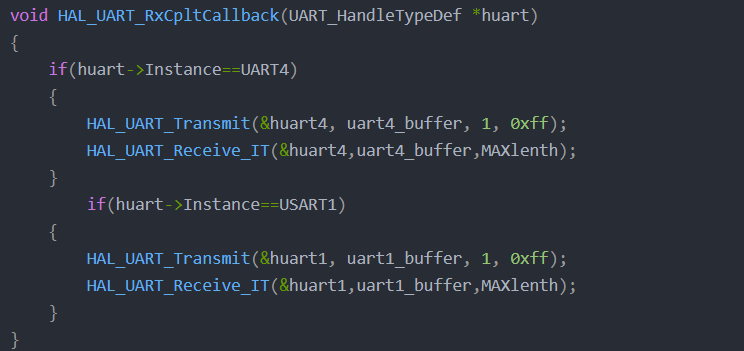

收发函数中可以优化的部分
) G/ w* ?/ D" r/ O/ `+ |a、串口接收在回调函数中使用:
0 C5 ?* V+ o0 t, A
# r( z8 Q. _# R! B' N
  1. void HAL_UART_RxCpltCallback(UART_HandleTypeDef *huart)+ L$ m& b2 `$ }
  2. {: u# o6 o  g( ~
  3.     if(huart->Instance==UART4)2 H+ _; N9 S/ I
  4.     {
    ! e4 x; N+ S0 T9 K6 D1 U( L! k
  5.         HAL_UART_Transmit(&huart4, uart4_buffer, 1, 0xff);
    & |; i1 D, `( X4 c$ W
  6.         HAL_UART_Receive_IT(&huart4,uart4_buffer,MAXlenth);9 S) v. Y' Q1 i6 \/ \" i
  7.     }
    ; H- Q' I1 L& y4 ~: }$ v
  8.                 if(huart->Instance==USART1)
      t; k( s; ]9 a* J& A# X4 s
  9.     {3 L) S  C$ U8 b  o- D
  10.         HAL_UART_Transmit(&huart1, uart1_buffer, 1, 0xff);
    % a1 \0 j& O" a5 x0 ~2 e% V+ i
  11.         HAL_UART_Receive_IT(&huart1,uart1_buffer,MAXlenth);
    0 ?; l1 w" I0 S* [* E
  12.     }: ?5 B- F* F8 f5 q  f
  13. }
( W6 `. a* s6 K3 h1 c! T' D2 v在上述回调函数中,把UART4和USART1的接收字节存入数组uart4_buffer和uart1_buffer,MAXlenth为最大接收长度。
