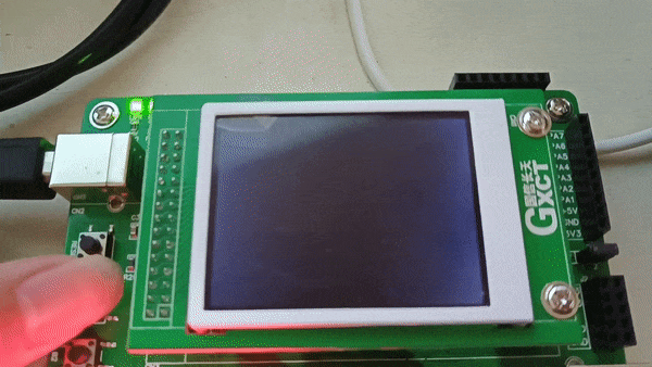

2.测试效果

  3. ) r1 z2 F: x; C. u& H
  4. #include "main.h"
    $ u4 p! }" z4 v* b
  5. #include "stdbool.h"
    " M1 l; T7 D# V' S& n6 C
  6. 4 H3 r. d6 K6 s6 t+ S  |) @3 _7 g; x
  7. struct keys
    ) v& E  y0 [$ f* V6 \& p* e
  8. {' w- n9 p9 Q3 ^: A. ?
  9.         unsigned char judge_sta;
    ( {0 B+ `! u  w6 R
  10.         bool key_sta;
    % r, z; k: Z, _9 U/ E6 V
  11.         bool single_key_flag;
    9 V4 Z1 Z+ I3 _1 F" q
  12.         bool long_flag;
    # a& J; f* l+ ^; ]1 Z. w
  13.         unsigned int key_time;. y  j# B( v& ]( B. H/ z
  14.         bool double_click_timerEN;  e" u( v4 j, \# R
  15.         unsigned int double_click_time;
    & P+ Y& E- m. f2 x2 a) N' F
  16.         bool double_key_flag;
    # b9 t$ L# \' n2 Y& i' C
  17.         bool long_key_flag;
    " u+ J- _, }- |" r' ^! T
  18. };7 a0 l. ?# S, u; O" A' ]$ K! L
  19. ! E+ n) X2 H2 g! q  g) G
  20. void HAL_TIM_PeriodElapsedCallback(TIM_HandleTypeDef *htim);
    $ Y$ o" [* P" C9 S; r/ |
  21. , V5 {; K# {9 \2 S# g
  22. #endif: m- s8 u7 e. C3 P. M- V
  23. 0 w4 i8 x- a0 f# T  P  F: Z% @
6 U& y( l& ?; u, c/ `% K, G. b
interrupt.c:+ A1 t$ s/ Z# ]9 a' O0 \' u* R* x
  1. #include "interrupt.h"7 b% S! y8 g4 l; V
  2. 7 b+ w3 P" S( Y# a: [# g3 i
  3. struct keys key[4] = {0, 0, 0};; L" K! q& L3 U+ g
  4. 5 s+ @" W4 t4 j' ]6 E7 {; ]
  5. void HAL_TIM_PeriodElapsedCallback(TIM_HandleTypeDef *htim)
    ' R( V- W. C$ O$ W
  6. {; o$ K/ e  L! i# j9 ^6 Z- l% B
  7.         if(htim->Instance == TIM3)0 k! T- e" D% ~: f" C1 Y! a
  8.         {: @9 {' L6 n) b- ^2 U2 n$ p
  9.                 key[0].key_sta = HAL_GPIO_ReadPin(GPIOB, GPIO_PIN_0);
    * e; Y; H/ g0 a: g
  10.                 key[1].key_sta = HAL_GPIO_ReadPin(GPIOB, GPIO_PIN_1);
    : H) T4 {: l+ U8 ^) Y
  11.                 key[2].key_sta = HAL_GPIO_ReadPin(GPIOB, GPIO_PIN_2);
    , b4 w6 O6 h/ L% _0 b  m; R
  12.                 key[3].key_sta = HAL_GPIO_ReadPin(GPIOA, GPIO_PIN_0);3 C1 t/ S. _' C
  13.                 & C! R$ C; C: Y# ?$ v) S! Q
  14.                 for(int i = 0; i < 4; i++)
    6 K$ ^* ^$ W" j. H
  15.                 {1 l' o/ p6 w; t- w; u4 I: r
  16.                         switch(key[i].judge_sta)
    ! b" V  l# t( x+ K. b' ^
  17.                         {
    ! L1 @+ ]2 [# y5 g
  18.                                 case 0:
    * s8 {  }2 z" j, Y6 t+ P
  19.                                 {  J$ |7 \# e, N6 F
  20.                                         if(key[i].key_sta == 0) 2 p. d* W: |0 `# f0 N
  21.                                         {
      r5 j# S  z8 F/ L
  22.                                                 key[i].judge_sta = 1;
    ( w" Q7 H4 b! J+ u" u! F! A
  23.                                                 key[i].key_time = 0;+ l* U2 S% E# k. \
  24.                                         }
    ) L. ~* \9 u; G1 R
  25.                                 }: D, w7 o5 ?! f5 z0 h( z
  26.                                 break;
    - r3 ]( E7 O' j: {4 b4 H7 v' D
  27.                                 case 1:
    % w  m$ h: j; S: K: }
  28.                                 {- s6 c( h' [( v' k
  29.                                         if(key[i].key_sta == 0)6 o2 Z& X1 x- Q) z# ~' p
  30.                                         {& k2 O, z; d5 _
  31.                                                 key[i].judge_sta = 2;
    7 E- s( W' f' {9 }. U& [1 k
  32. 4 r: \3 w" ~2 A/ Q1 h: I: `- e
  33.                                         }
    # J0 Q7 O* s) }2 `  ], Y- Q  T' N
  34.                                         else
    6 u" G5 l# d0 y" C4 _" I
  35.                                         {
    ! ]# h. }& R$ ~' Z1 b( ~4 [
  36.                                                 key[i].judge_sta = 0;: \* s0 P4 }  P5 m$ [/ R
  37.                                         }0 L3 R7 q" h$ f6 A6 `) v( q8 j9 X
  38.                                 }& ]1 g4 n# }9 Y5 G
  39.                                 break;  Y. ~% @" H4 k1 r, z
  40.                                 case 2:" ]" t# b4 g8 Z9 h; m' ~
  41.                                 {, X; V% |6 C" Z% m1 t0 t" T
  42.                                         if(key[i].key_sta == 1 && key[i].key_time < 70)
    ) ~8 T  z5 e: ?
  43.                                         {" J8 q/ N6 R! E& l7 b
  44.                                                 if(key[i].double_click_timerEN == 0)
    ( D( Z) ]& G' _( o; ?
  45.                                                 {
    ' O# W: P2 V" N0 h, J
  46.                                                         key[i].double_click_timerEN = 1;5 R2 p; i/ ~' x; H( e
  47.                                                         key[i].double_click_time = 0;
    & _; N' R7 ^; J5 h& k1 i$ P; ^
  48.                                                 }. y. W2 O: n/ a$ t4 {! y" ]. y% P
  49.                                                 else& j3 x; j0 Q2 G* G7 \' g. V2 _% u
  50.                                                 {; P5 \9 m% X# k8 v! q8 C3 d
  51.                                                         key[i].double_key_flag = 1;
    " Y% v/ ?1 c' A8 C' P
  52.                                                         key[i].double_click_timerEN = 0;% t' c" A6 k, Z2 K/ |1 X! D4 o
  53.                                                 }+ V, T3 h7 p/ w* A
  54.                                                 key[i].judge_sta = 0;0 b' E1 j, R% U* \
  55.                                         }
      I$ c7 \# W2 m$ |$ S: ?& [2 N% [
  56.                                         else if(key[i].key_sta == 1 && key[i].key_time >= 70) key[i].judge_sta = 0;
    2 c$ q5 W; ]  F0 q6 }- N, v
  57.                                         else
    6 f6 |2 u: v, c, _
  58.                                         {. ~6 c8 ]) M0 p$ k: q
  59.                                                 if(key[i].key_time >= 70) key[i].long_key_flag = 1;
    7 @" ]  U7 @1 r! S+ i/ L2 z
  60.                                                 key[i].key_time++;& O6 Y; R$ c( m% C+ z
  61.                                         }
    % ~- T  f+ A, `: G% O! F
  62.                                         break;3 V4 }+ X1 C+ b  t
  63.                                 }
    + n8 b( V+ k$ t: r
  64.                         }
    0 V, Z8 @4 @. i, x8 }- O! _0 [
  65.                         if(key[i].double_click_timerEN == 1)
    ) P* Y: B4 z5 K4 }( a; V
  66.                         {/ g0 J! O$ r5 l/ D% h  H4 m* \
  67.                                 key[i].double_click_time++;' Q+ ^* K7 n4 a5 Q! m3 ]  I
  68.                                 if(key[i].double_click_time >= 20)- Y! h9 _" E5 m
  69.                                 {, w: r! r4 n* f; z% c
  70.                                         key[i].single_key_flag = 1;  y$ y4 U' T" a( y; s1 }; V6 e# E" O
  71.                                         key[i].double_click_timerEN = 0;
    ( w( [" W: _' s% E
  72.                                 }! {9 Z9 _+ A; J8 O
  73.                         }# S1 w) A4 ~! @& m
  74.                 }
    1 w- |% ~. {) N3 {- c# D/ n
  75.         }
    6 B' E5 k" L$ ]+ h  ?: m4 i3 l, G
  76. }2 I' G: s& x5 V- Q/ b. G
  77. ' {& I8 h0 X( k/ k
2 R6 C5 j* p0 B5 n& smain.c:: {( ?+ H0 j" n0 @
  1. /* USER CODE BEGIN Header */
    5 }8 [. }- ?3 N: O9 U6 V
  2. /**' z6 Y1 j/ k+ V+ i& a
  3.   ******************************************************************************" _+ B- b" A; {0 X. H3 [. M
  4.   * @file           : main.c! |( T8 }1 M+ ~0 d  V2 L8 c# f
  5.   * @brief          : Main program body
    . u) w9 [1 f/ K, H
  6.   ******************************************************************************5 i0 [' N( ]6 S4 G# i5 k
  7.   * @attention
    ' h% l; l4 w! O0 |
  8.   *: ~( @+ t& v0 a/ c, P
  9.   * <h2><center>© Copyright (c) 2023 STMicroelectronics.
    ' B3 j6 @  ?1 N- Z+ Z& E2 }( A
  10.   * All rights reserved.</center></h2>" h) C$ P7 j1 h3 m$ t" e7 g
  11.   *
    7 a7 A7 N) l9 J- y0 E  C$ C/ @
  12.   * This software component is licensed by ST under BSD 3-Clause license,
    ' W+ ?1 t  D# f; n" Y
  13.   * the "License"; You may not use this file except in compliance with the
    1 n2 U, v3 ^7 }7 i. }" v
  14.   * License. You may obtain a copy of the License at:
    7 l( _3 j3 |9 U8 M5 Q# C+ Q
  15.   *                        opensource.org/licenses/BSD-3-Clause: p0 G( b7 v1 o. D1 p
  16.   *
    3 z% A# l' c9 j& R, F
  17.   ******************************************************************************
    ' m) |% B; n/ M
  18.   */
    3 A0 u$ D+ N1 h/ _- n$ U
  19. /* USER CODE END Header */$ V& n. l1 j4 `/ U
  20. /* Includes ------------------------------------------------------------------*/% D" l. T( E& s* ^. K
  21. #include "main.h"' T$ X) `$ f8 S% Z( Q# [: A9 S, l
  22. #include "tim.h"/ C6 z, @% i; o
  23. #include "gpio.h"- v7 Z! N. w6 ]4 D* b3 N
  24. 2 j! X9 K* E* P% H* _  _
  25. /* Private includes ----------------------------------------------------------*/9 ~5 p8 K! {4 x9 Q# A2 U
  26. /* USER CODE BEGIN Includes */$ x3 E- `* [% Z& t
  27. #include "led.h": V7 u" S7 E' Z; X6 H. _$ R/ n
  28. #include "lcd.h"+ x7 ^9 ?8 F( g( D5 t2 G% L
  29. #include "stdio.h"' R/ N; n- o- _$ e
  30. #include "interrupt.h"
    : H3 |6 z) l  k0 Y- n
  31. /* USER CODE END Includes */5 F8 x; {/ A0 U# @8 @/ H5 m
  32. 3 y. P" i5 ^6 p- e9 @5 R
  33. /* Private typedef -----------------------------------------------------------*/
    0 \6 O( t0 O1 T' v
  34. /* USER CODE BEGIN PTD */
    & \! [, m7 k( k! X$ Q+ I: s7 }
  35. % _8 M5 M! ?, s% Q. U3 _
  36. /* USER CODE END PTD */- u" m4 `8 j" T2 I9 A; l
  37. 4 ^' e. a* \2 a! D+ c
  38. /* Private define ------------------------------------------------------------*/
    . J6 {/ {2 J: f% ?, l# W) C. r
  39. /* USER CODE BEGIN PD */; }3 t& s8 ^% t
  40. /* USER CODE END PD */
    1 s# Q4 J- n- P6 L; [
  41. ; I9 F! S' O& d9 }6 `
  42. /* Private macro -------------------------------------------------------------*/
    + C( i$ I! c! r' ]; a0 f2 {. W! ^
  43. /* USER CODE BEGIN PM */" t8 I, @$ D- w# l
  44. ( V" z) u" G: a% r$ z+ O) _
  45. /* USER CODE END PM */6 e$ C; M0 u8 g8 Q
  46. ' S& Q1 J& l4 k3 g+ [
  47. /* Private variables ---------------------------------------------------------*/
      G# k2 L0 j5 t/ O$ D' M8 @
  48. - u0 ~  R1 P2 S" l% d; B% e7 ~
  49. /* USER CODE BEGIN PV */9 g5 J7 L# ~! D+ [& W; _( N9 {
  50. extern struct keys key[];
    ! P7 G; F) c2 I, ?$ h$ \  I
  51. /* USER CODE END PV */4 v/ M4 Z4 t2 ~3 J5 l/ M  H
  52. " g8 K) f0 d- Z7 y  J# A. j7 \8 e
  53. /* Private function prototypes -----------------------------------------------*/1 A$ r7 }7 C$ A: Q+ P2 D3 O  M+ \
  54. void SystemClock_Config(void);7 y& A  N) w. O/ C6 P$ P. s
  55. /* USER CODE BEGIN PFP */
    * o. ]7 x: I! u9 J& i' V5 ^: r
  56. /* USER CODE END PFP */
    6 B! z+ T6 R6 M
  57. , x! x! X+ l- X( }
  58. /* Private user code ---------------------------------------------------------*/& s. z: y9 N$ k3 K! M( H9 D
  59. /* USER CODE BEGIN 0 */
    + [9 O7 O& h! b* X5 ]" M
  60. 8 v  s; W, \+ H+ r9 Y
  61. /* USER CODE END 0 */# z8 M# |/ C0 K' [
  62. ; g& W3 F1 r9 v. ^$ b
  63. /**& U) G& A$ c- _: [1 f
  64.   * @brief  The application entry point.
    3 N3 R1 h1 l" O) [
  65.   * @retval int
    6 `+ j, y3 O, p6 D
  66.   */
    4 Q" \" O2 Q* ?# ?: ?
  67. int main(void)0 s$ M3 Z$ s7 r* {4 L
  68. {
    $ c1 i9 |, I1 e
  69.   /* USER CODE BEGIN 1 */; R* y3 K# ?+ y( h! h# Q
  70.   /* USER CODE END 1 */6 N/ @: O5 ]9 u9 g6 y- k" T
  71. ' S9 j( g5 I6 k2 |
  72.   /* MCU Configuration--------------------------------------------------------*/
    0 @; g% W) J" t+ V7 G. ~% r: ^: e
  73. - [" {6 R1 s- {! `0 d+ g
  74.   /* Reset of all peripherals, Initializes the Flash interface and the Systick. */
    4 S0 Z& c& m( L
  75.   HAL_Init();& s7 a* N  N( L, P: z# _5 I7 ]
  76. ) g/ D/ g, b- a: x" M: G
  77.   /* USER CODE BEGIN Init */9 o, K. J+ W% Z  N
  78. ( z$ X3 ^8 q6 u- D+ b8 X' h) \& v( g* ?' F
  79.   /* USER CODE END Init */
    . g& z- T% y9 L
  80. + S% B$ B7 k9 b/ i$ ?3 S
  81.   /* Configure the system clock */, s) t0 k+ v! J6 m6 ?& G* Y
  82.   SystemClock_Config();. D9 @- H( F' Y  L
  83. 4 M) M9 X" q1 a+ L. c+ {
  84.   /* USER CODE BEGIN SysInit */
    2 s* \# C3 e0 m( B- R
  85. $ C! h# w# S" J# Y- j0 u) g( I
  86.   /* USER CODE END SysInit */
    0 j8 K% P/ |; U" b1 w, d' K" {, k
  87.   [" G" S+ m" f- S
  88.   /* Initialize all configured peripherals */
    ' Y: u( _- ]: |4 E0 d
  89.   MX_GPIO_Init();
    # G" L2 s+ x6 V/ \) v2 d$ E7 U
  90.   MX_TIM3_Init();6 a$ x, m3 t1 h
  91.   /* USER CODE BEGIN 2 */7 N+ A) P$ S- o' U% ^
  92. ; v" G9 L; P8 e
  93.   /* USER CODE END 2 */
    5 F$ |/ R6 I0 c" ]- B
  94. * \) i+ x% w/ @' s
  95.   /* Infinite loop */3 n. T% \5 U! w/ r0 U$ J% L1 Y* g
  96.   /* USER CODE BEGIN WHILE */
    ( q( J1 p5 c  q/ K% |: E! V
  97. 8 N8 s# T& ]8 j/ D  f9 l
  98. & [) W$ u. H- H8 D8 M) t, b
  99.         5 Q9 F. ^8 w4 \  |' ?3 u8 p. S! F
  100.         HAL_TIM_Base_Start_IT(&htim3);. _4 s0 G8 o: H7 H' O* L
  101.         LED_Disp(0x00); //这里是把灯全部灭掉6 ]+ j7 l8 a; X9 ^5 {
  102. + p* ]% F! J7 C! H$ F
  103.   while (1)
    ; v0 {/ t4 c$ P0 h2 h0 b: E
  104.   {! g+ }- B1 Y& T0 w7 D3 X
  105.     /* USER CODE END WHILE */
    9 ^& a$ ]2 m7 v* F: }$ k: D0 b
  106. 3 T4 x: V& n( R5 x
  107.     /* USER CODE BEGIN 3 */
    5 v3 L# X* z5 w9 J5 T
  108.                 if(key[0].single_key_flag == 1)
    6 |( l$ \( z4 J/ T% {
  109.                 {- ?, _% [( x8 t* ?8 h$ U4 @
  110.                         HAL_GPIO_TogglePin(GPIOC, GPIO_PIN_8);( O7 `/ }, w0 Y& M% E2 a/ Q
  111.                         key[0].single_key_flag = 0;1 E9 C) p" F( w  \5 U2 h
  112.                 }0 a4 i7 L) I* L+ O# x# m7 ?
  113.                 if(key[0].long_key_flag == 1)1 F" j! O3 g! ^% l# A: M8 @: o
