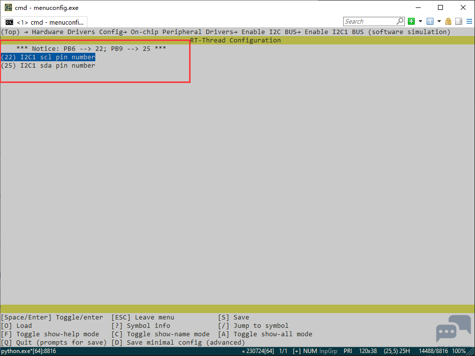

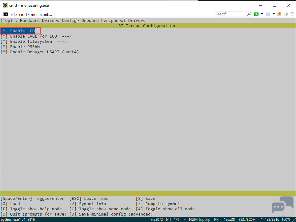

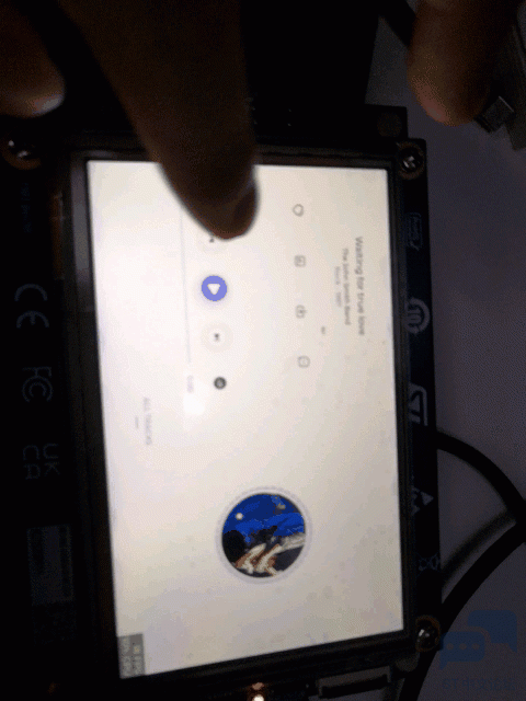

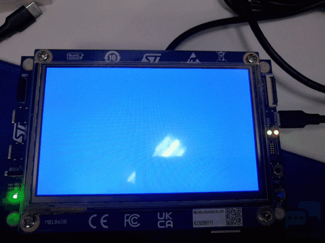

  7. 在驱动 bsp/stm32/libraries/HAL_Drivers/drivers/drv_lcd.c 增加新的屏幕刷新函数,原先的拷贝方式太慢了
     void drv_lcd_flush(unsigned int *addr)
         if (SCB->CCR & SCB_CCR_DC_Msk) {
             SCB_CleanInvalidateDCache();
         /* Configure the color frame buffer start address */
     //    LTDC_LAYER(&LtdcHandle, 0)->CFBAR &= ~(LTDC_LxCFBAR_CFBADD);
         LTDC_LAYER(&LtdcHandle, 0)->CFBAR = (uint32_t)(addr);
         rt_sem_take(&_lcd.lcd_lock, RT_TICK_PER_SECOND / 20);
         HAL_LTDC_Relaod(&LtdcHandle, LTDC_SRCR_VBR);

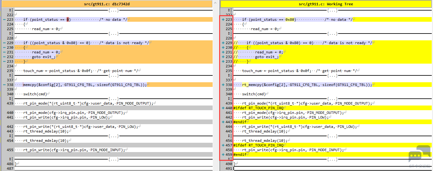

  8. 修改 application/lvgl/lv_port_indev.c,修改触摸驱动为 gt911,并更新读取函数
      * Copyright (c) 2006-2022, RT-Thread Development Team
      * SPDX-License-Identifier: Apache-2.0
      * Change Logs:
      * Date           Author       Notes
      * 2024-08-28     Morph        The first version
     #include <lvgl.h>
     #include <stdbool.h>
     #include <rtdevice.h>
     #include <drv_gpio.h>
     #include "gt911.h"
     #define DBG_TAG "lv_port_indev"
     #define DBG_LVL DBG_INFO
     #include <rtdbg.h>
     #define TOUCH_DEVICE_NAME    "touch_gt"    /* Touch device name */
     #define TOUCH_DEVICE_I2C_BUS "i2c1"        /* SCL -> PB6(22), SDA -> PB9(25) */
     //#define REST_PIN             GET_PIN(A, 3) /* reset pin */
     //#define USER_BUTTON_PIN      GET_PIN(C, 13) /* Reserve for LV_INDEV_TYPE_BUTTON */
     lv_indev_t *touch_indev;
     static rt_device_t ts;    /* Touch device handle, Touchscreen */
     static struct rt_touch_data *read_data;
     static void touchpad_read(lv_indev_drv_t *indev, lv_indev_data_t *data)
         if (rt_device_read(ts, 0, read_data, 1) != 1)
             return;
         if (read_data->event == RT_TOUCH_EVENT_NONE)
            return;
         data->point.x = read_data->x_coordinate;

  9. 修改 packages/gt911-latest/src/gt911.c,中断控制脚使用宏约束下,修改触摸检测逻辑 modify_01.png
