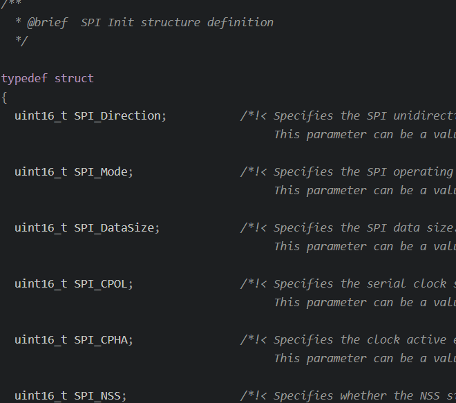

6 m7 j7 G8 |. e8 }- qSPI Init structure definition
! O- R$ \9 W2 d5 J, T" R2 ?1 \: L/ F9 Z; q! ]2 A
  1. /** 5 b; y1 P- b) E: e& D  C1 \5 h( Z
  2.   * @brief  SPI Init structure definition    d/ F% @3 V. b  B
  3.   */
    : B; W  P& e# P
  4. 2 j+ R  @/ x2 a
  5. typedef struct
    & m& f: G" T0 g% k/ u
  6. {. ?6 N0 p6 l" ^: U  @: q0 z- j
  7.   uint16_t SPI_Direction;           /*!< Specifies the SPI unidirectional or bidirectional data mode.+ n! y8 ~2 E! l8 B) H" W' k8 n; q
  8.                                          This parameter can be a value of @ref SPI_data_direction */
    4 V$ k# u9 \1 n( ^" A3 f
  9. 7 k1 v) V! w7 `" o* r$ h# M# {
  10.   uint16_t SPI_Mode;                /*!< Specifies the SPI operating mode.# n* t) I' ~: S6 n+ t% y: I5 W6 h
  11.                                          This parameter can be a value of @ref SPI_mode */( z) m  A1 V* C8 |8 F: X3 K; m
  12. $ V. J9 A) l( n0 e
  13.   uint16_t SPI_DataSize;            /*!< Specifies the SPI data size.
    % o, @* G/ `+ d3 n0 k" i
  14.                                          This parameter can be a value of @ref SPI_data_size */& i5 j& F6 Y4 K, u
  15. # u$ @/ a1 L% u% x0 Q$ U& }2 J6 d
  16.   uint16_t SPI_CPOL;                /*!< Specifies the serial clock steady state.- A/ ?; C. L( w! V6 D
  17.                                          This parameter can be a value of @ref SPI_Clock_Polarity *// g$ j2 Q) P8 z4 r9 W/ |
  18. * u7 P/ ~* g/ c6 s" n, V
  19.   uint16_t SPI_CPHA;                /*!< Specifies the clock active edge for the bit capture.
    ! s6 \, c3 w+ T: N# L5 e1 E" V/ }
  20.                                          This parameter can be a value of @ref SPI_Clock_Phase */
    8 W, A2 J. P) ]  e
  21. - W* d9 ~4 t* ?; e: G3 d2 X
  22.   uint16_t SPI_NSS;                 /*!< Specifies whether the NSS signal is managed by
    5 t- l! R! Y8 x' Z0 T) {
  23.                                          hardware (NSS pin) or by software using the SSI bit.
    & g1 c7 D/ L1 t0 m. T
  24.                                          This parameter can be a value of @ref SPI_Slave_Select_management */3 Y, g# P! z' ?; c
  25. 7 a1 b0 t* d5 P3 d
  26.   uint16_t SPI_BaudRatePrescaler;   /*!< Specifies the Baud Rate prescaler value which will be- l+ Z6 p) L0 E, Z* S4 N! }
  27.                                          used to configure the transmit and receive SCK clock.
    6 c' |& Q* K7 s/ I" b
  28.                                          This parameter can be a value of @ref SPI_BaudRate_Prescaler
    - U" Q3 r9 K/ {$ A$ K. m/ ~+ T: W
  29.                                          @note The communication clock is derived from the master
    0 b) d; y" n+ S# J
  30.                                                clock. The slave clock does not need to be set. */
    ! B7 I. [, G, y: c( |# P
  31. 0 h0 F: ^/ P. C* @  W
  32.   uint16_t SPI_FirstBit;            /*!< Specifies whether data transfers start from MSB or LSB bit.
    4 @/ V( P2 T; U+ a  c. P( ]  F% O
  33.                                          This parameter can be a value of @ref SPI_MSB_LSB_transmission */
    % b, u% K6 O0 P2 ]8 }
  34. 7 U3 W  ?8 Y1 y
  35.   uint16_t SPI_CRCPolynomial;       /*!< Specifies the polynomial used for the CRC calculation. */
    * N0 ~2 Z) g# Q! S6 _' |
  36. }SPI_InitTypeDef;
