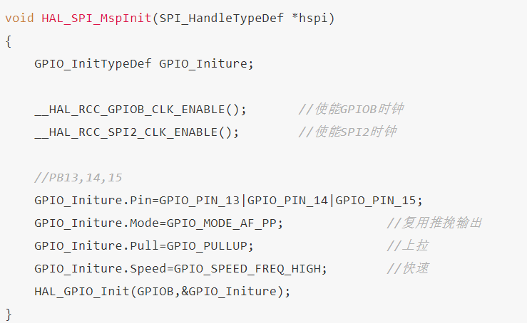

0 f/ F: V  ^# B+ R: ]; ?底层驱动,时钟使能,引脚配置6 |0 {2 X" C# E6 m
9 k6 ~6 C2 K5 H& g2 `
  1. void HAL_SPI_MspInit(SPI_HandleTypeDef *hspi)
    . o* r9 H# _- [
  2. {2 O+ U* E5 i" U! C, S2 r! {" j
  3.     GPIO_InitTypeDef GPIO_Initure;
    # P7 i. k5 y9 L3 D6 R) D, w% `
  4. 5 U: {9 W" E1 q9 y* b' k" _
  5.     __HAL_RCC_GPIOB_CLK_ENABLE();       //使能GPIOB时钟$ B2 R7 h% N; z' X
  6.     __HAL_RCC_SPI2_CLK_ENABLE();        //使能SPI2时钟4 f9 W! f! m3 J* Z& Q
  7. 3 u; Q3 {* S  l6 s" o6 U% J
  8.     //PB13,14,15
    - p7 [6 k: b4 `* D5 v
  9.     GPIO_Initure.Pin=GPIO_PIN_13|GPIO_PIN_14|GPIO_PIN_15;
    4 r2 \8 T% {  F( f
  10.     GPIO_Initure.Mode=GPIO_MODE_AF_PP;              //复用推挽输出# y% j* P$ [! s4 Q$ G% E9 f
  11.     GPIO_Initure.Pull=GPIO_PULLUP;                  //上拉* S( N7 m! \. D7 A0 D) a. F, M/ Z) ?
  12.     GPIO_Initure.Speed=GPIO_SPEED_FREQ_HIGH;        //快速            ' g5 N, w; G% e) _3 Z* s/ j
  13.     HAL_GPIO_Init(GPIOB,&GPIO_Initure);. C* C6 I, s4 B( h9 [2 p/ x
  14. }
