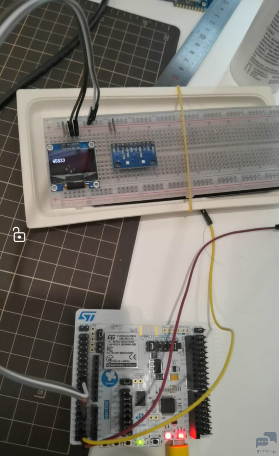

【STM32WB55】驱动传感器和屏幕
银河帝国 发布时间:2023-7-30 20:32
本小节主要在上一次的代码框架基础上加上OLED和MPU6050的驱动,这两个模块都已经很成熟了,方便用来验证板子的功能。代码在江科大自化协老师提供的基础上进行了修改,OLED驱动部分的程序包含了三部分,OLED.h,OLED.c和OLED_font.h,用软件I2C实现的,如果有多个I2C外设,还可以将I2C进一步抽象成一个统一接口,方便复用和维护。spi用也使用软件模拟实现,主要包含MPU6050_SI2C.h和MPU6050_SI2C.c两个部分。

mpu6050_si2c.c
 #include "stm32wbxx_hal.h"
 #include "MPU6050_SI2C.h"
 #define SCL_PORT GPIOC
 #define SCL_PIN GPIO_PIN_3
 #define SDA_PORT GPIOC
 #define SDA_PIN GPIO_PIN_2
 void MPU6050_W_SCL(uint8_t BitValue)
     HAL_GPIO_WritePin(SCL_PORT, SCL_PIN, (GPIO_PinState) BitValue);
     //HAL_Delay(1);
 void MPU6050_W_SDA(uint8_t BitValue)
     HAL_GPIO_WritePin(SDA_PORT, SDA_PIN, (GPIO_PinState) BitValue);
     //HAL_Delay(1);
 uint8_t MPU6050_R_SDA(void)
     uint8_t bitValue;
     bitValue = HAL_GPIO_ReadPin( SDA_PORT, SDA_PIN);
     //HAL_Delay(1);
     return bitValue;
 void MPU6050_GPIO_Init(void)
     __HAL_RCC_GPIOC_CLK_ENABLE();
   GPIO_InitStructure.Mode = GPIO_MODE_OUTPUT_OD;
   GPIO_InitStructure.Speed = GPIO_SPEED_FREQ_MEDIUM;
     GPIO_InitStructure.Pull = GPIO_NOPULL;
   GPIO_InitStructure.Pin = SDA_PIN;
   HAL_GPIO_Init(SDA_PORT, &GPIO_InitStructure);
   GPIO_InitStructure.Pin = SCL_PIN;
   HAL_GPIO_Init(SCL_PORT, &GPIO_InitStructure);
   MPU6050_W_SCL(1);
   MPU6050_W_SDA(1);
 void MPU6050_Start(void)
     MPU6050_W_SDA(1);
     MPU6050_W_SCL(1);
     MPU6050_W_SDA(0);
     MPU6050_W_SCL(0);
 void MPU6050_Stop(void)
     MPU6050_W_SCL(0);
     MPU6050_W_SDA(0);
     MPU6050_W_SCL(1);
     MPU6050_W_SDA(1);
 void MPU6050_SendByte(uint8_t byte)
     uint8_t i;
     for( i=0; i<8; i++)
         MPU6050_W_SDA(byte & ( 0x80 >> i)); //高位先行
         MPU6050_W_SCL(1);
         MPU6050_W_SCL(0);
 uint8_t MPU6050_ReceiveByte(void)
     uint8_t byte = 0x00,i;
     MPU6050_W_SDA(1); //释放总线
     for(i=0;i<8;i++)
         MPU6050_W_SCL(1); // read
         if(MPU6050_R_SDA() == 1){
             byte |= (0x80 >> i);
         MPU6050_W_SCL(0); // prepare
     return byte;
 void MPU6050_SendAck(uint8_t ack)
     MPU6050_W_SDA(ack); //高位先行
     MPU6050_W_SCL(1);
     MPU6050_W_SCL(0);
 uint8_t MPU6050_ReceiveAck(void)
     uint8_t ack;
     ack = MPU6050_R_SDA();
     return ack;
  * extern MPU6050 Function
 void MPU6050_Init(void)
     MPU6050_GPIO_Init();
     MPU6050_Write(PWR_MGMT_1, 0x00); // 解除睡眠模式
     MPU6050_Write(SMPLRT_DIV, 0x07); //陀螺仪采样率 0x07
     MPU6050_Write(CONFIG, 0x1A); //低通滤波器 0x06 - 5Hz
     MPU6050_Write(GYRO_CONFIG, 0x18); //陀螺仪不自检 陀螺仪测量范围2000deg/s
     MPU6050_Write(ACCEL_CONFIG, 0x01);// 不自检,陀螺仪减速度计范围 2G,5Hz
 void MPU6050_Write(uint8_t address, uint8_t data)
     MPU6050_Start();
     MPU6050_SendByte(MPU6050_I2C_SLAVE_ADDRESS);
     MPU6050_ReceiveAck();
     MPU6050_SendByte(address);
     MPU6050_SendByte(data);
     MPU6050_Stop();
 uint8_t MPU6050_Read(uint8_t address)
     uint8_t ret = 0x00;
     MPU6050_Start();
     MPU6050_Start();
     MPU6050_SendByte(MPU6050_I2C_SLAVE_ADDRESS | 0x01);
     ret = MPU6050_ReceiveByte();
     MPU6050_SendAck(0); //给0 给从机应答,结束
     MPU6050_Stop();
     return ret;
 void MPU6050_GetData(struct tag_MPU6050_Data_Struct *pMPU6050_Data)
     uint16_t data_h, data_l;
     data_h = MPU6050_Read(ACCEL_XOUT_H);
     data_l = MPU6050_Read(ACCEL_XOUT_L);
     pMPU6050_Data->acc_x = (data_h << 8) | data_l;
     data_h = MPU6050_Read(ACCEL_YOUT_H);
     data_l = MPU6050_Read(ACCEL_YOUT_L);
     pMPU6050_Data->acc_y = (data_h << 8) | data_l;
     data_h = MPU6050_Read(ACCEL_ZOUT_H);
     data_l = MPU6050_Read(ACCEL_ZOUT_L);
     pMPU6050_Data->acc_z = (data_h << 8) | data_l;
     data_h = MPU6050_Read(GYRO_XOUT_H);
     data_l = MPU6050_Read(GYRO_XOUT_L);
     pMPU6050_Data->gyro_x = (data_h << 8) | data_l;
     data_h = MPU6050_Read(GYRO_YOUT_H);
     data_l = MPU6050_Read(GYRO_YOUT_L);
     pMPU6050_Data->gyro_y = (data_h << 8) | data_l;
     data_h = MPU6050_Read(GYRO_ZOUT_H);
     data_l = MPU6050_Read(GYRO_ZOUT_L);
     pMPU6050_Data->gyro_z = (data_h << 8) | data_l;
mpu6050_si2c.h
 #ifndef _MPU6050_SI2C_H
 #define _MPU6050_SI2C_H
 #include "stdint.h"
 void MPU6050_GPIO_Init(void);
 void MPU6050_Start(void);
 void MPU6050_Stop(void);
 void MPU6050_SendByte(uint8_t byte);
 uint8_t MPU6050_ReceiveByte(void);
 void MPU6050_SendAck(uint8_t ack);
 uint8_t MPU6050_ReceiveAck(void);
 #define SMPLRT_DIV                0x19 // 陀螺仪采样率,典型值:0x07(125Hz)
 #define CONFIG                    0x1A // 低通滤波频率,典型值:0x06(5Hz)
 #define GYRO_CONFIG               0x1B // 陀螺仪自检及测量范围,典型值:0x18(不自检,2000deg/s)
 #define ACCEL_CONFIG              0x1C // 加速计自检、测量范围及高通滤波频率,典型值:0x01(不自检,2G,5Hz)
 #define ACCEL_XOUT_H              0x3B
 #define ACCEL_XOUT_L              0x3C
 #define ACCEL_YOUT_H              0x3D
 #define ACCEL_YOUT_L              0x3E
 #define ACCEL_ZOUT_H              0x3F
 #define ACCEL_ZOUT_L              0x40
 #define TEMP_OUT_H                0x41
 #define TEMP_OUT_L                0x42
 #define GYRO_XOUT_H               0x43
 #define GYRO_XOUT_L               0x44
 #define GYRO_YOUT_H               0x45
 #define GYRO_YOUT_L               0x46
 #define GYRO_ZOUT_H               0x47
 #define GYRO_ZOUT_L               0x48
 #define PWR_MGMT_1                0x6B // 电源管理,典型值:0x00(正常启用)
 #define WHO_AM_I                  0x75 // IIC地址寄存器(默认数值0x68,只读)
 #define MPU6050_I2C_SLAVE_ADDRESS 0xD0
 struct tag_MPU6050_Data_Struct{
     int16_t acc_x;
     int16_t acc_y;
     int16_t acc_z;
     int16_t gyro_x;
     int16_t gyro_y;
     int16_t gyro_z;
 uint8_t MPU6050_Read(uint8_t address);
 void MPU6050_Write(uint8_t address, uint8_t data);
 void MPU6050_Init(void);
 void MPU6050_GetData(struct tag_MPU6050_Data_Struct *pMPU6050_Data);
 #endif
修改task.c中的配置
 #define TASK_TIMER_CNT 5  //任务定时器个数,增加任务时须修改该宏值
 void oled_test_task_callback(void);//任务回调函数声明
 task_timer_parameter task_timer_para[TASK_TIMER_CNT] =
    /*{timeout_cb,       timeout(ms),    repeat(ms)}*/
    {led0_task_timer_callback, 1000,         1000},
    {led1_task_timer_callback, 500,          500},
    {led2_task_timer_callback, 200,          200},
      {uart_task_timer_callback, 1000,               1000},
      {oled_test_task_callback,  1000,               120},
 void oled_test_task_callback(void){
     static uint32_t oled_excute_time = 0;
     static char oled_str[32];
     //OLED_Clear();       //OLED清屏
 //    sprintf(oled_str,"timer=%d",oled_excute_time++);
 //    OLED_ShowString(1, 3, "HelloWorld!");
 //    OLED_ShowString(2, 1, oled_str);
     static struct tag_MPU6050_Data_Struct MPU6050_Data;
     MPU6050_GetData(&MPU6050_Data);
     OLED_ShowSignedNum(2,1,MPU6050_Data.acc_x,5);
     OLED_ShowSignedNum(3,1,MPU6050_Data.acc_y,5);
     OLED_ShowSignedNum(4,1,MPU6050_Data.acc_z,5);
     OLED_ShowSignedNum(2,8,MPU6050_Data.gyro_x,5);
     OLED_ShowSignedNum(3,8,MPU6050_Data.gyro_y,5);
     OLED_ShowSignedNum(4,8,MPU6050_Data.gyro_z,5);
image-20230727175647952.png [/i][/i][/i]
