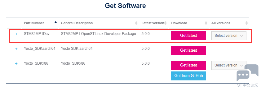

一、下载OpenSTLinux BSP
官网下载地址:https://www.st.com/en/embedded-software/stm32mp1dev.html#get-software

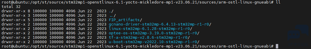

三、编译linux内核
3.1、进入linux内核文件夹linux-stm32mp-6.1.28-stm32mp-r1-r0/
3.2、解压linux内核
root@ubuntu:/opt/st/source/stm32mp1-openstlinux-6.1-yocto-mickledore-mp1-v23.06.21/sources/arm-ostl-linux-gnueabi/linux-stm32mp-6.1.28-stm32mp-r1-r0# tar xvf linux-6.1.28.tar.xz

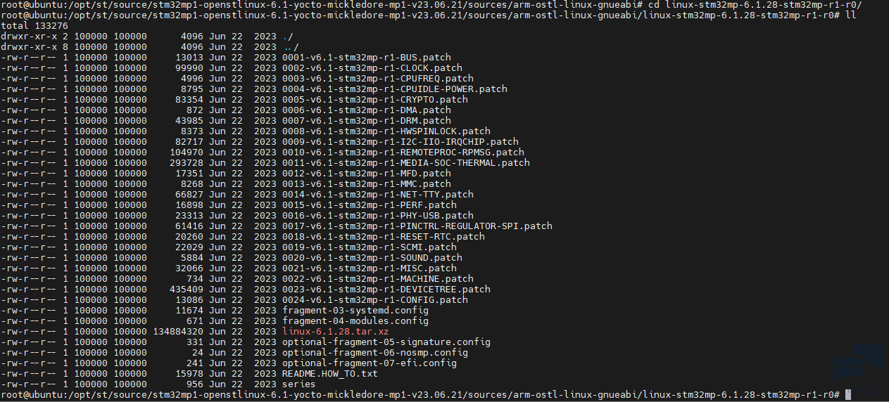

3.3、打补丁
root@ubuntu:/opt/st/source/stm32mp1-openstlinux-6.1-yocto-mickledore-mp1-v23.06.21/sources/arm-ostl-linux-gnueabi/linux-stm32mp-6.1.28-stm32mp-r1-r0/linux-6.1.28# for p in ls -1 ../*.patch; do patch -p1 < $p; done

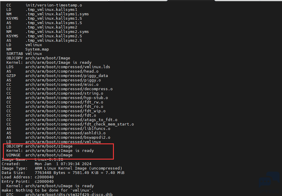

3.4、编译内核
root@ubuntu:/opt/st/source/stm32mp1-openstlinux-6.1-yocto-mickledore-mp1-v23.06.21/sources/arm-ostl-linux-gnueabi/linux-stm32mp-6.1.28-stm32mp-r1-r0/linux-6.1.28# make ARCH=arm uImage vmlinux dtbs LOADADDR=0xC2000040

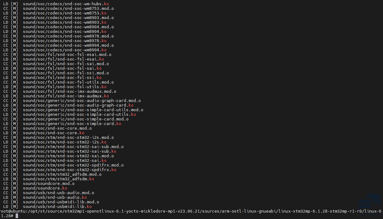

3.5、编译模块
root@ubuntu:/opt/st/source/stm32mp1-openstlinux-6.1-yocto-mickledore-mp1-v23.06.21/sources/arm-ostl-linux-gnueabi/linux-stm32mp-6.1.28-stm32mp-r1-r0/linux-6.1.28# make ARCH=arm modules
