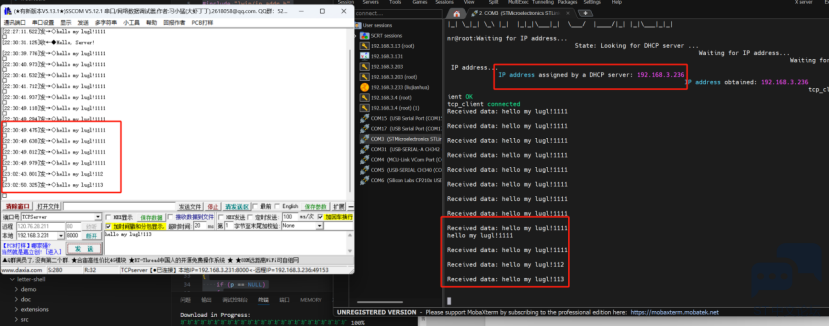

下载到开发板后,可以实现与开发的交互:
nr@root:
nr@root:
nr@root:ls
ls need more arguments!
useage: ls [options]
options:
         -h     : show help
         -v     : show version
         cmd    : show all commands
nr@root:LED on
LED on
nr@root:

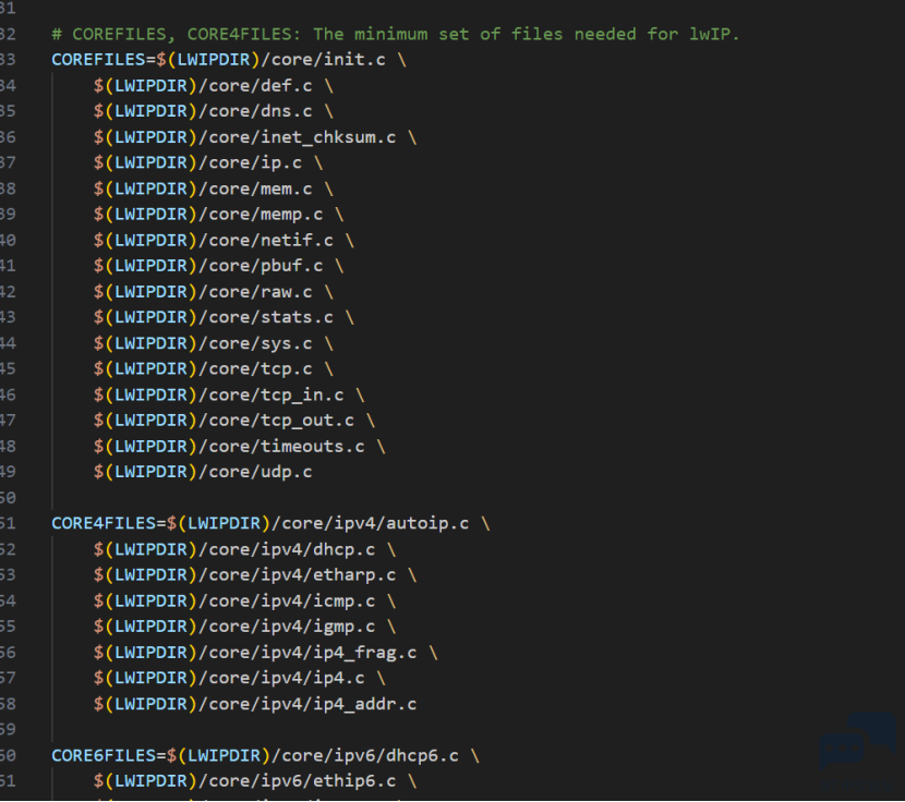

【源码的移植】

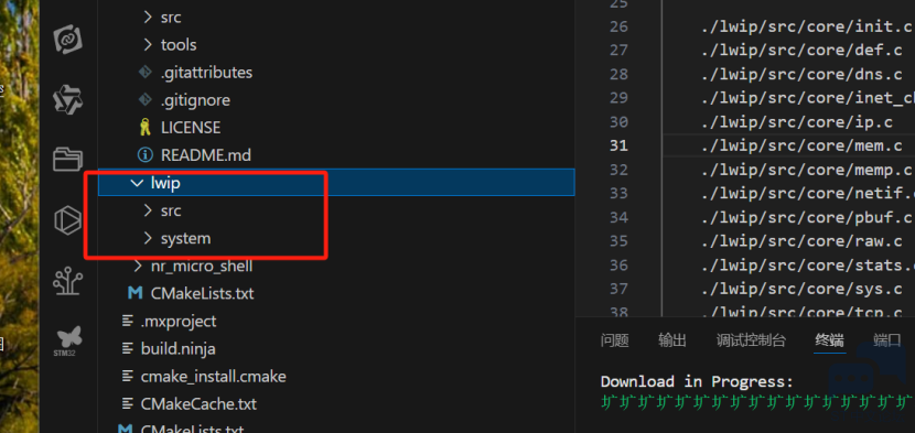

1、我将STM32CubeIDE的工程中的lwip源码,复制到我工程目录ThirdPart下面
2、然后根据Filielists.mk编把工程中的文件夹以及.c添加进CMakeLists.txt中。
最后添加好后文件如下:

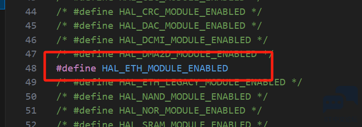

4、由于是手工添加ETH的驱动,所以需要在stm32f7xx_hal_conf.h中打开ETH的配置
同时添加网络参数:

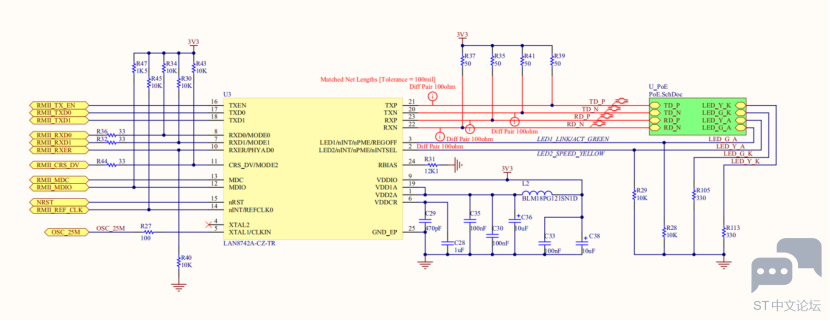

 /* DP83848_PHY_ADDRESS Address*/
#define DP83848_PHY_ADDRESS
 /* PHY Reset delay these values are based on a 1 ms Systick interrupt*/
#define PHY_RESET_DELAY ((uint32_t)0x000000FFU)
 /* PHY Configuration delay */
#define PHY_CONFIG_DELAY ((uint32_t)0x00000FFFU)
#define PHY_READ_TO ((uint32_t)0x0000FFFFU)
#define PHY_WRITE_TO ((uint32_t)0x0000FFFFU)
   /* Section 3: Common PHY Registers */
#define PHY_BCR ((uint16_t)0x0000U) /*!< Transceiver Basic Control Register   */
#define PHY_BSR ((uint16_t)0x0001U) /*!< Transceiver Basic Status Register    */
#define PHY_RESET ((uint16_t)0x8000U)                   /*!< PHY Reset */
#define PHY_LOOPBACK ((uint16_t)0x4000U)                /*!< Select loop-back mode */
#define PHY_FULLDUPLEX_100M ((uint16_t)0x2100U)         /*!< Set the full-duplex mode at 100 Mb/s */
#define PHY_HALFDUPLEX_100M ((uint16_t)0x2000U)         /*!< Set the half-duplex mode at 100 Mb/s */
#define PHY_FULLDUPLEX_10M ((uint16_t)0x0100U)          /*!< Set the full-duplex mode at 10 Mb/s  */
#define PHY_HALFDUPLEX_10M ((uint16_t)0x0000U)          /*!< Set the half-duplex mode at 10 Mb/s  */
#define PHY_AUTONEGOTIATION ((uint16_t)0x1000U)         /*!< Enable auto-negotiation function     */
#define PHY_RESTART_AUTONEGOTIATION ((uint16_t)0x0200U) /*!< Restart auto-negotiation function    */
#define PHY_POWERDOWN ((uint16_t)0x0800U)               /*!< Select the power down mode           */
#define PHY_ISOLATE ((uint16_t)0x0400U)                 /*!< Isolate PHY from MII                 */
#define PHY_AUTONEGO_COMPLETE ((uint16_t)0x0020U) /*!< Auto-Negotiation process completed   */
#define PHY_LINKED_STATUS ((uint16_t)0x0004U)     /*!< Valid link established               */
#define PHY_JABBER_DETECTION ((uint16_t)0x0002U)  /*!< Jabber condition detected            */
 /* Section 4: Extended PHY Registers */
#define PHY_SR ((uint16_t)0x1FU) /*!< PHY special control/ status register Offset     */
#define PHY_SPEED_STATUS ((uint16_t)0x0004U)  /*!< PHY Speed mask                                  */
#define PHY_DUPLEX_STATUS ((uint16_t)0x0010U) /*!< PHY Duplex mask                                 */
#define PHY_ISFR ((uint16_t)0x1DU)        /*!< PHY Interrupt Source Flag register Offset       */
#define PHY_ISFR_INT4 ((uint16_t)0x0010U) /*!< PHY Link down inturrupt                         */

编写一个tcp_client.c/h,来测试与tcp_server的通信。
#include "lwip/tcp.h"
#include "lwip/netif.h"
#include "lwip/init.h"
#include "lwip/sys.h"
#include "lwip/ip_addr.h"
#include "shell_uart.h"
#include "string.h"
static err_t tcp_client_recv(void *arg, struct tcp_pcb *tpcb, struct pbuf *p, err_t err);
static err_t tcp_client_send(struct tcp_pcb *tpcb, const char *data, u16_t len);
    static err_t tcp_client_connected(void *arg, struct tcp_pcb *tpcb, err_t err)
    if (err != ERR_OK)
        tcp_close(tpcb);
        return err;
    shell_printf("tcp_client connected\r\n");
    // Set the receive callback function
    tcp_recv(tpcb, tcp_client_recv);
    // Send data to the server
    const char *data = "Hello, Server!\r\n";
    tcp_client_send(tpcb, data, strlen(data));
    // Send data or perform other actions upon successful connection
    return ERR_OK;
    if (p == NULL)
        tcp_close(tpcb);
        return ERR_OK;
    // Process received data
    shell_printf("Received data: %.*s\n", p->tot_len, (char *)p->payload);
    // Indicate that the data has been received
    tcp_recved(tpcb, p->tot_len);
    // Free the received pbuf
    pbuf_free(p);
    // Continue to receive data
    return ERR_OK;
static void tcp_client_error(void *arg, err_t err)
    // Handle error
    shell_printf("TCP error: %d\n", err);
static err_t tcp_client_poll(void *arg, struct tcp_pcb *tpcb)
    // Handle periodic actions
    return ERR_OK;
    struct pbuf *p = pbuf_alloc(PBUF_TRANSPORT, len, PBUF_POOL);
    if (p == NULL)
        shell_printf("Failed to allocate pbuf\n");
        return ERR_MEM;
    memcpy(p->payload, data, len);
    err_t err = tcp_write(tpcb, p->payload, len, TCP_WRITE_FLAG_COPY);
    if (err != ERR_OK)
        shell_printf("Failed to send data: %d\n", err);
        pbuf_free(p);
        return err;
    err = tcp_output(tpcb);
    if (err != ERR_OK)
        shell_printf("Failed to output data: %d\n", err);
        pbuf_free(p);
        return err;
    pbuf_free(p);
    return ERR_OK;
void tcp_client_init(void)
    struct tcp_pcb *tpcb;
    ip_addr_t server_ip;
    IP4_ADDR(&server_ip, 192, 168, 3, 231);
    tpcb = tcp_new();
    if (tpcb != NULL)
        tcp_arg(tpcb, NULL);
        tcp_err(tpcb, tcp_client_error);
        tcp_poll(tpcb, tcp_client_poll, 1);
        err_t err = tcp_connect(tpcb, &server_ip, 8000, tcp_client_connected);
        if (err != ERR_OK)
            shell_printf("tcp_client err: %d\r\n", err);
            tcp_close(tpcb);
        else
            shell_printf("tcp_client OK\r\n");
    else
        shell_printf("Failed to create TCP PCB\n");
lugl 回答时间:2025-2-25 14:32:14
6、在freertos任务中,调用lwip初始,等待网卡连接以及动态获取到IP然后连接tcp_server。
/* USER CODE END Header_StartDefaultTask */
void StartDefaultTask(void const * argument)
  /* USER CODE BEGIN StartDefaultTask */
  /* Infinite loop */
  tcpip_init(NULL, NULL);
  Netif_Config();
  User_notification(&gnetif);
#ifdef USE_DHCP
  /* Start DHCPClient */
  osThreadDef(DHCP, DHCP_thread, osPriorityBelowNormal, 0, configMINIMAL_STACK_SIZE * 5);
  osThreadCreate(osThread(DHCP), &gnetif);
#endif
  // 等待网络接口启用
  while (!netif_is_up(&gnetif))
    shell_printf("Waiting for network interface to be up...\n");
    osDelay(1000);
  // 等待获取IP地址
  while (ip_addr_isany(netif_ip4_addr(&gnetif)))
    shell_printf("Waiting for IP address...\n");
    osDelay(1000);
  shell_printf("IP address obtained: %s\n", ipaddr_ntoa(netif_ip4_addr(&gnetif)));
  // 启动TCP客户端
  tcp_client_init();
  for(;;)
    shell_usart_loop();
    osDelay(100);
  /* USER CODE END StartDefaultTask */
lugl 回答时间:2025-2-25 14:34:50
【测试效果】
下载到开发板后,在电脑端创建一个TCP_SERVER,然后打shell,从server发送数据,就可以在shell中打印出tcp接收到的数据了。
到此,移植Lwip就完成了。也成功的实现了数据的交互。
