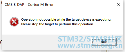

最大频率10MHz、5MHz、2MHz、1MHz等都不行。
Load "****Desktop\\DAPLink_test\\build\\DAPLink.axf" 8 i8 A9 d6 |7 d3 Y* P4 G- x. w
Full Chip Erase Done.9 F: G2 |* h& n' p; z- J; a2 f
Programming Done.) Q3 q- y w. f0 }& K9 T
Contents mismatch at: 08000000H (Flash=FFH Required=A8H) !' s D+ ~& V; J& N+ g7 a
Contents mismatch at: 08000001H (Flash=FFH Required=1AH) !
Contents mismatch at: 08000002H (Flash=FFH Required=00H) !
Contents mismatch at: 08000003H (Flash=FFH Required=20H) !
Contents mismatch at: 08000004H (Flash=FFH Required=01H) !2 O' U) O/ ?: c; b8 z
Contents mismatch at: 08000005H (Flash=FFH Required=01H) !% y6 z4 h# P2 X+ P2 h2 E. J
Contents mismatch at: 08000006H (Flash=FFH Required=00H) !
Contents mismatch at: 08000007H (Flash=FFH Required=08H) !/ w. Z, {' F& B4 l& V# ^
Contents mismatch at: 08000008H (Flash=FFH Required=ADH) !
Contents mismatch at: 08000009H (Flash=FFH Required=07H) !
Contents mismatch at: 0800000AH (Flash=FFH Required=00H) !
Contents mismatch at: 0800000BH (Flash=FFH Required=08H) !0 A% d( l$ x' P9 u+ N
Contents mismatch at: 0800000CH (Flash=FFH Required=ADH) !9 y5 [$ q; ^: h% h
Contents mismatch at: 0800000DH (Flash=FFH Required=07H) !
Contents mismatch at: 0800000EH (Flash=FFH Required=00H) !
Contents mismatch at: 0800000FH (Flash=FFH Required=08H) !
Contents mismatch at: 08000010H (Flash=FFH Required=ADH) !4 O# M) i+ x: Z1 h
Contents mismatch at: 08000011H (Flash=FFH Required=07H) !
Contents mismatch at: 08000012H (Flash=FFH Required=00H) !
Contents mismatch at: 08000013H (Flash=FFH Required=08H) !; g& K7 y/ R7 _% P/ [
Contents mismatch at: 08000014H (Flash=FFH Required=ADH) !
Contents mismatch at: 08000015H (Flash=FFH Required=07H) !! I3 I/ `0 B% r( [ F( v
Contents mismatch at: 08000016H (Flash=FFH Required=00H) !& X9 k+ U0 G s- q+ I
Contents mismatch at: 08000017H (Flash=FFH Required=08H) ! L k& x1 n" C1 W+ M+ G- K$ O% E/ b
Contents mismatch at: 08000018H (Flash=FFH Required=ADH) !
Contents mismatch at: 08000019H (Flash=FFH Required=07H) !
Contents mismatch at: 0800001AH (Flash=FFH Required=00H) !' G/ d3 C/ o) ?6 r
Contents mismatch at: 0800001BH (Flash=FFH Required=08H) !
Contents mismatch at: 0800001CH (Flash=FFH Required=00H) !
Contents mismatch at: 0800001DH (Flash=FFH Required=00H) !3 ~* p4 s# }0 p% F; U7 d0 A
Contents mismatch at: 0800001EH (Flash=FFH Required=00H) !
Contents mismatch at: 0800001FH (Flash=FFH Required=00H) !, Z, }! D$ N$ p8 i
Contents mismatch at: 08000020H (Flash=FFH Required=00H) !
Contents mismatch at: 08000021H (Flash=FFH Required=00H) !. c$ p# K, w& u1 [
Contents mismatch at: 08000022H (Flash=FFH Required=00H) !
Contents mismatch at: 08000023H (Flash=FFH Required=00H) !! `, E/ n/ v0 E4 T3 y
Contents mismatch at: 08000024H (Flash=FFH Required=00H) !
Contents mismatch at: 08000025H (Flash=FFH Required=00H) !
Contents mismatch at: 08000026H (Flash=FFH Required=00H) !
Contents mismatch at: 08000027H (Flash=FFH Required=00H) !) [0 i4 ?/ W2 o" y1 K
Contents mismatch at: 08000028H (Flash=FFH Required=00H) !0 a/ V1 N' Y" a ~5 u
Contents mismatch at: 08000029H (Flash=FFH Required=00H) !
Contents mismatch at: 0800002AH (Flash=FFH Required=00H) !. o+ V8 @2 _$ O
Contents mismatch at: 0800002BH (Flash=FFH Required=00H) !
Contents mismatch at: 0800002CH (Flash=FFH Required=ADH) !3 A: C& V; c/ K1 K4 O: c9 Q) K
Contents mismatch at: 0800002DH (Flash=FFH Required=07H) !3 b3 I9 G8 R ?0 p5 v
Contents mismatch at: 0800002EH (Flash=FFH Required=00H) !
Contents mismatch at: 0800002FH (Flash=FFH Required=08H) !
Contents mismatch at: 08000030H (Flash=FFH Required=ADH) !
Contents mismatch at: 08000031H (Flash=FFH Required=07H) !
Contents mismatch at: 08000032H (Flash=FFH Required=00H) !$ P" h0 C+ w# d/ p/ {- F
Contents mismatch at: 08000033H (Flash=FFH Required=08H) !+ E! @) L% }1 l+ A/ I; g
Contents mismatch at: 08000034H (Flash=FFH Required=00H) !6 e2 P$ P. d* d, L
Contents mismatch at: 08000035H (Flash=FFH Required=00H) !
Contents mismatch at: 08000036H (Flash=FFH Required=00H) !
Contents mismatch at: 08000037H (Flash=FFH Required=00H) !
Contents mismatch at: 08000038H (Flash=FFH Required=ADH) !
Contents mismatch at: 08000039H (Flash=FFH Required=07H) !6 ~. i5 T2 n0 Z# _
Contents mismatch at: 0800003AH (Flash=FFH Required=00H) !
Contents mismatch at: 0800003BH (Flash=FFH Required=08H) !
Contents mismatch at: 0800003CH (Flash=FFH Required=51H) !
Contents mismatch at: 0800003DH (Flash=FFH Required=08H) !& X, U4 }' x* R( j; A
Contents mismatch at: 0800003EH (Flash=FFH Required=00H) !
Contents mismatch at: 0800003FH (Flash=FFH Required=08H) !
Contents mismatch at: 08000040H (Flash=FFH Required=1BH) !
Contents mismatch at: 08000041H (Flash=FFH Required=01H) !
Contents mismatch at: 08000042H (Flash=FFH Required=00H) !& J( S8 c1 B' g
Contents mismatch at: 08000043H (Flash=FFH Required=08H) !
Contents mismatch at: 08000044H (Flash=FFH Required=1BH) !2 P- a0 O8 u' F+ f8 g3 H$ G, E' E
Contents mismatch at: 08000045H (Flash=FFH Required=01H) !
Contents mismatch at: 08000046H (Flash=FFH Required=00H) !
Contents mismatch at: 08000047H (Flash=FFH Required=08H) !9 X, e5 J" U! k, T9 S6 n3 ?
Contents mismatch at: 08000048H (Flash=FFH Required=1BH) !
Contents mismatch at: 08000049H (Flash=FFH Required=01H) !5 X+ @+ S; M& X h; r5 m! [
Contents mismatch at: 0800004AH (Flash=FFH Required=00H) !$ \3 \2 q7 Z- I V7 C5 l
Contents mismatch at: 0800004BH (Flash=FFH Required=08H) !
Contents mismatch at: 0800004CH (Flash=FFH Required=1BH) !
Contents mismatch at: 0800004DH (Flash=FFH Required=01H) !
Contents mismatch at: 0800004EH (Flash=FFH Required=00H) !9 X$ p4 G, E% G& j7 X' [
Contents mismatch at: 0800004FH (Flash=FFH Required=08H) !
Contents mismatch at: 08000050H (Flash=FFH Required=1BH) !; e9 Q7 K, r- C7 a
Contents mismatch at: 08000051H (Flash=FFH Required=01H) !
Contents mismatch at: 08000052H (Flash=FFH Required=00H) !
Contents mismatch at: 08000053H (Flash=FFH Required=08H) !. x. h' | p9 _/ `$ y \/ V( x
Contents mismatch at: 08000054H (Flash=FFH Required=1BH) !
Contents mismatch at: 08000055H (Flash=FFH Required=01H) !
Contents mismatch at: 08000056H (Flash=FFH Required=00H) !
Contents mismatch at: 08000057H (Flash=FFH Required=08H) !4 O. u: u# q7 K# u; _* z" Q
Contents mismatch at: 08000058H (Flash=FFH Required=1BH) !
Contents mismatch at: 08000059H (Flash=FFH Required=01H) !
Contents mismatch at: 0800005AH (Flash=FFH Required=00H) !+ W# H! M+ [3 f+ F
Contents mismatch at: 0800005BH (Flash=FFH Required=08H) !$ R ]$ p4 A/ S. |
Contents mismatch at: 0800005CH (Flash=FFH Required=1BH) !
Contents mismatch at: 0800005DH (Flash=FFH Required=01H) !9 V+ ~0 r9 e* r0 j6 }
Contents mismatch at: 0800005EH (Flash=FFH Required=00H) !
Contents mismatch at: 0800005FH (Flash=FFH Required=08H) !
Contents mismatch at: 08000060H (Flash=FFH Required=1BH) !
Contents mismatch at: 08000061H (Flash=FFH Required=01H) !/ V9 b" q1 E) }9 `( ~
Contents mismatch at: 08000062H (Flash=FFH Required=00H) !
Contents mismatch at: 08000063H (Flash=FFH Required=08H) !
Too many errors to display !5 @4 K( `! F2 E
Error: Flash Download failed - "Cortex-M3". o: M- c: f+ m: P

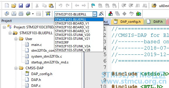

更换不同的板子,在这个下拉菜单里选择:
